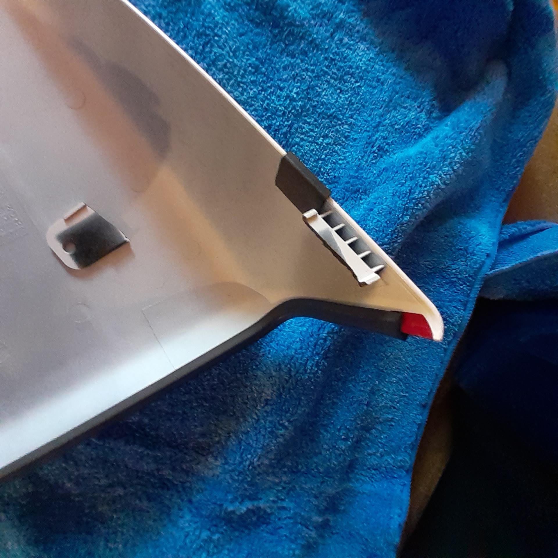

Kbear Posted July 2, 2021 Posted July 2, 2021 Hello all, I just purchased a 2007 25th Anniversary edition RWB. The rear seat cowling has a location tab that's broken off. Has anyone had to repair one of theirs and if so what was the best adhesive to use? Is there a really good "clear" plastic cement that works best? What would plastic welding do? Any direction or help would be great. Quote

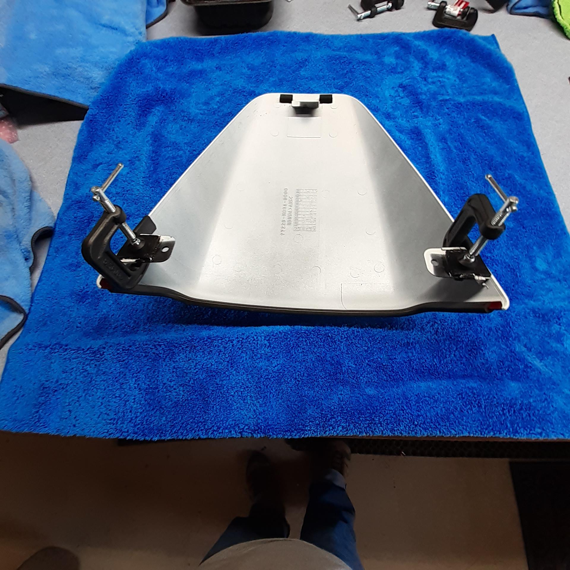

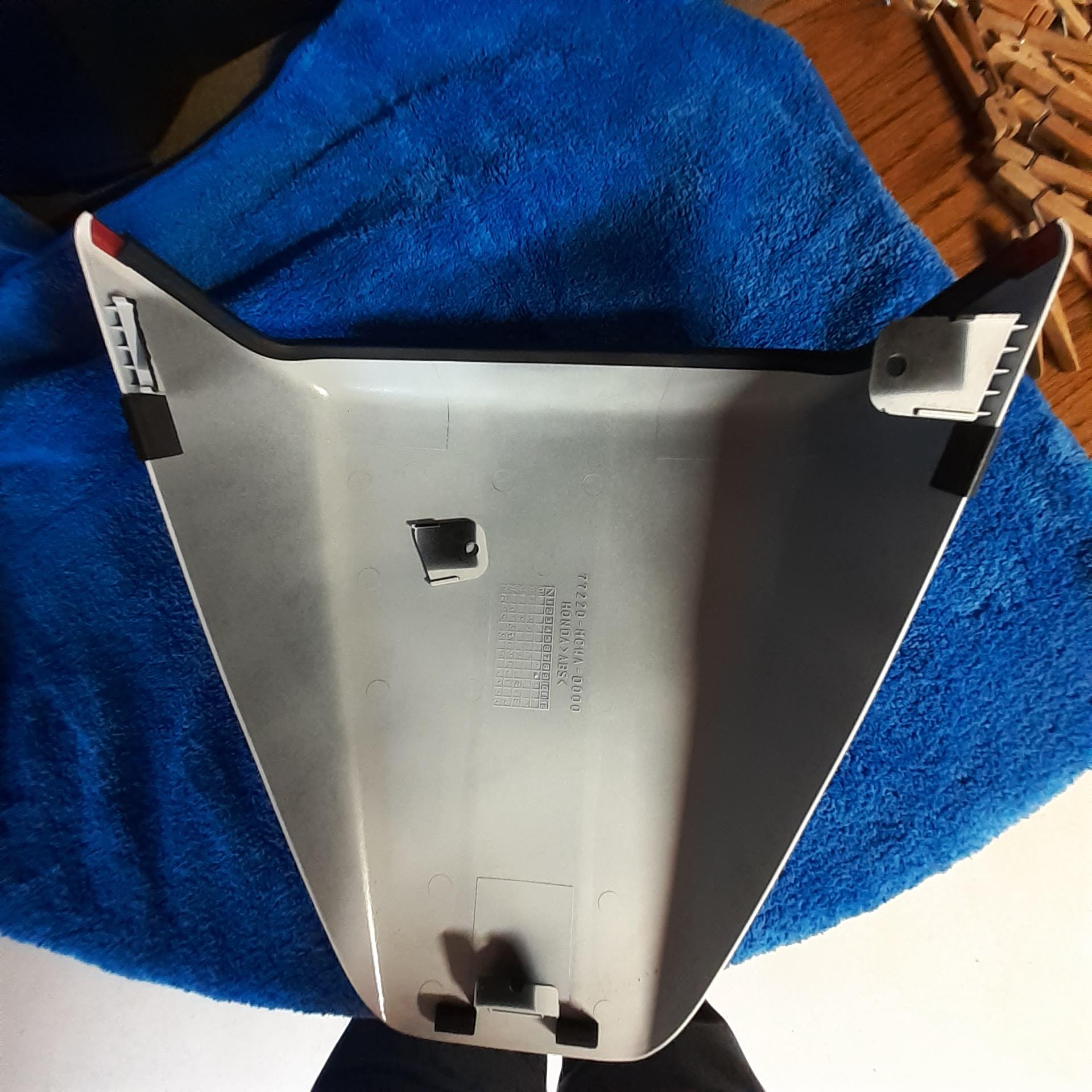

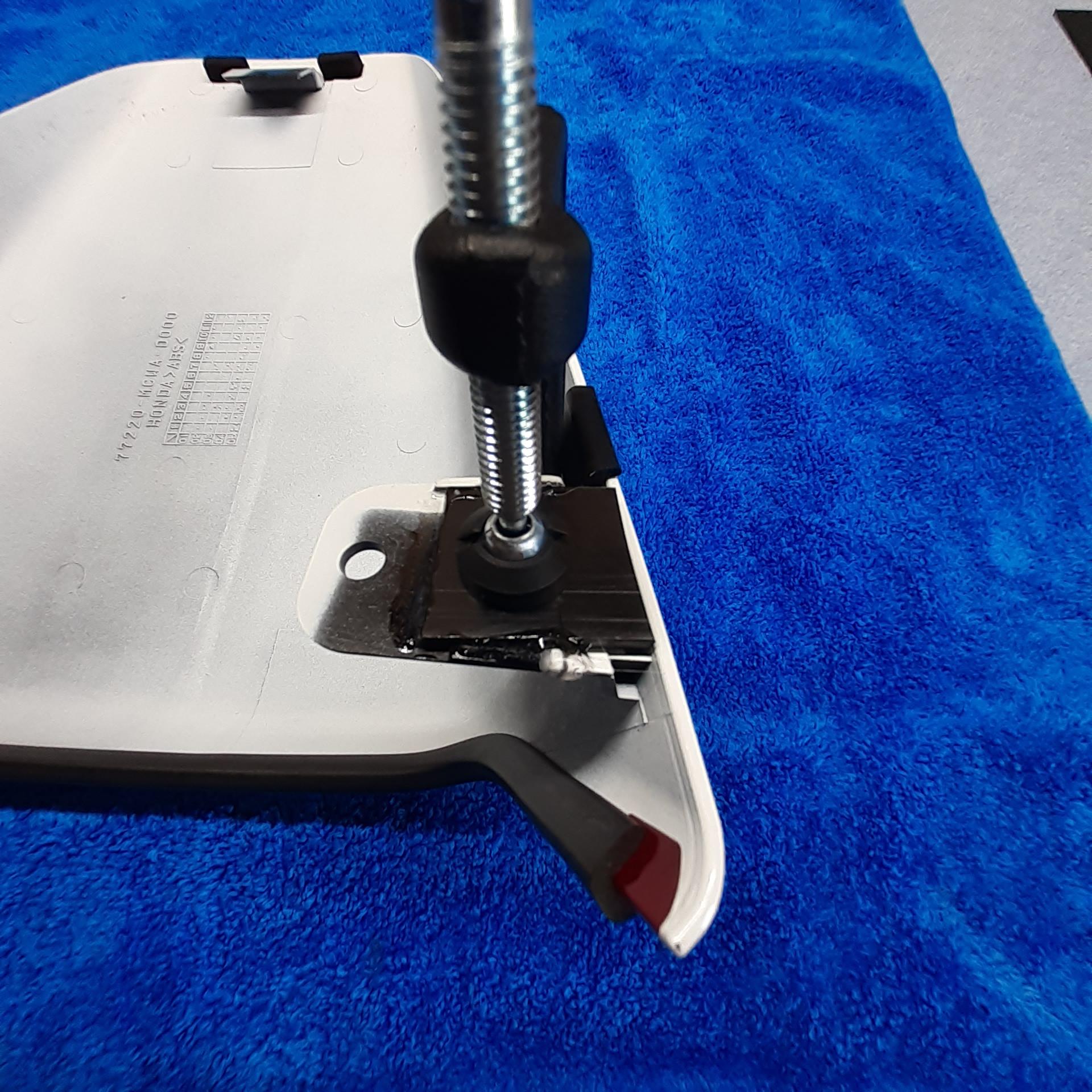

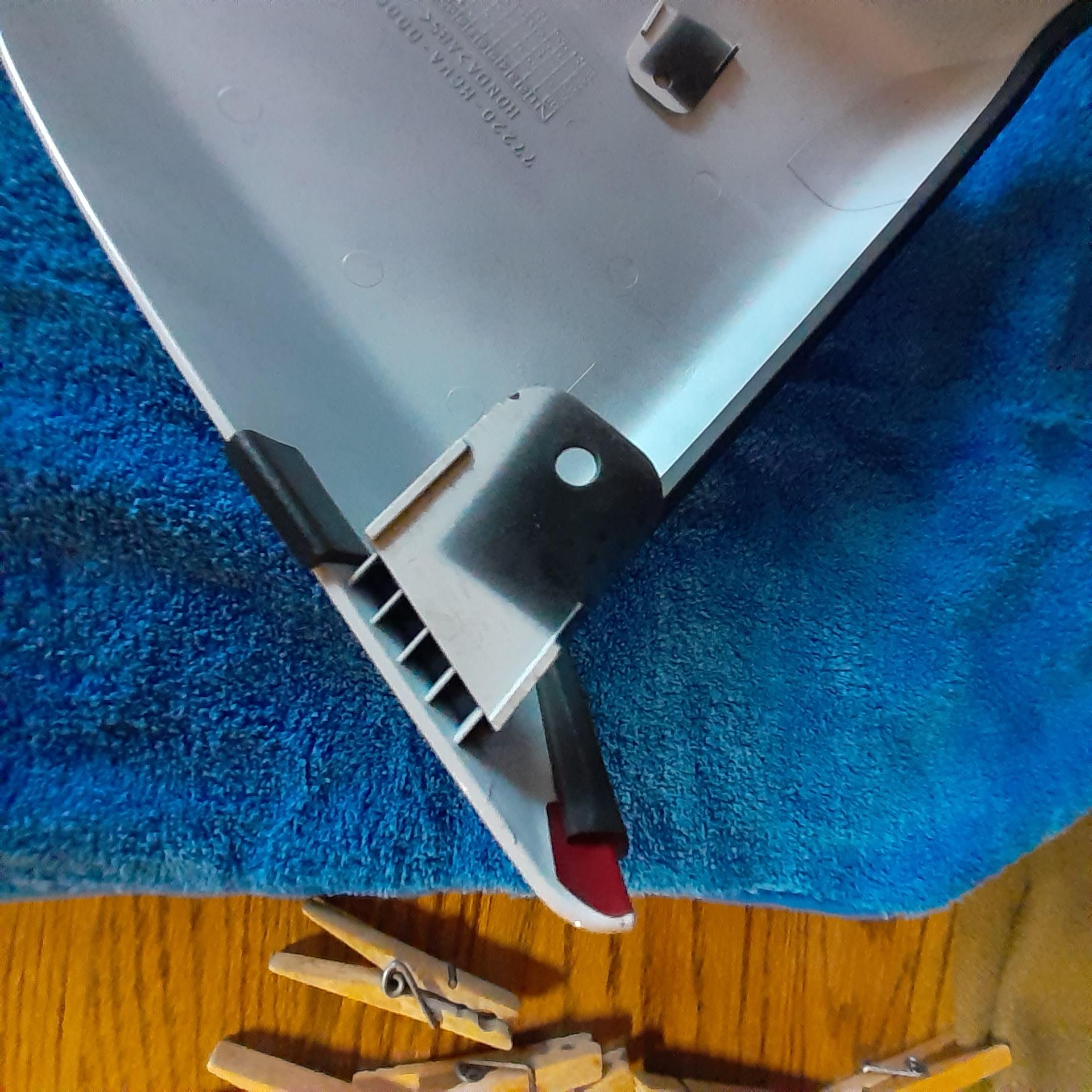

Kbear Posted August 14, 2021 Author Posted August 14, 2021 Okay everybody. I finally got around to fixing my rear seat cowl broken mounting tab. I went to a plastic specialties company and asked if they had something to repair the tab. I was told to use the product shown below. I also asked for some plastic fall they could supply me and he had some. This glue is really amazing. Maybe I should have made the tabs a little longer but it is what it is. Quote
