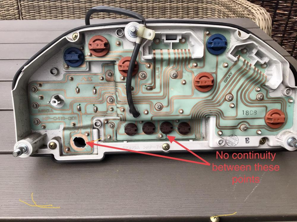

If the Grounds are ok you're going to have to get the back off the panel and inspect the copper tracks. These can suffer badly from corrosion causing breaks and crud buildup possibly causing tracking, this causes very strange effects with indicator lights just like you're having. Locate your Fi light and check the copper tracks for continuity back to the main panel connectors, clean any blackened areas, open circuit tracks can be repaired by simply soldering a wire each side of the break to make the circuit. See attached panel examples.

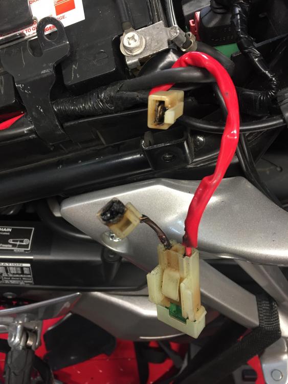

As for your bike originally dying on you. Have a very close inspection of Main Fuse B 30amp next to your starter relay this fuse and its wiring can suffer badly from high resistance connections in the fuse holder and its inline connector. Also check the state of Main Fuse A 30amp on the Starter Relay make sure the fuse is not overheated or stressed/discolored. Remove and check the Red plug of the Starter Relay check for any stress or burning of the Red wire and it's spade connector.

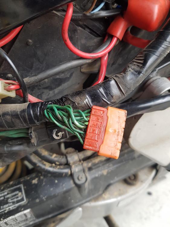

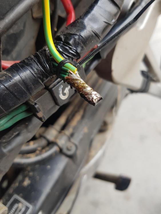

The Grounds we are referring to are the wiring harness Ground junctions which are not mentioned in the Service Manual or shown on the circuit diagram!!!!
On the 5gen you have an orange block buried under black tape in the harness above your chain guard. As you can see, multiple devices and sensors have their ground come into the junction which is divided into two sections and each section then has only one wire that goes to a frame ground, as shown this can suffer badly, you may have one device with an issue or if the one of the  main grounding wires has issues you will have multiple devices with problems.
Bottom pic shows an excellent repair of the grounds all soldered together, with the addition of a large new ground wire that goes back to the battery negative terminal.
The orange junction block seem to be the culprit. See pictures. As a quick fix I cut the connector and mashed all the wires together with a big wire nut, and the FI light has gone away, and the bike is running well.
