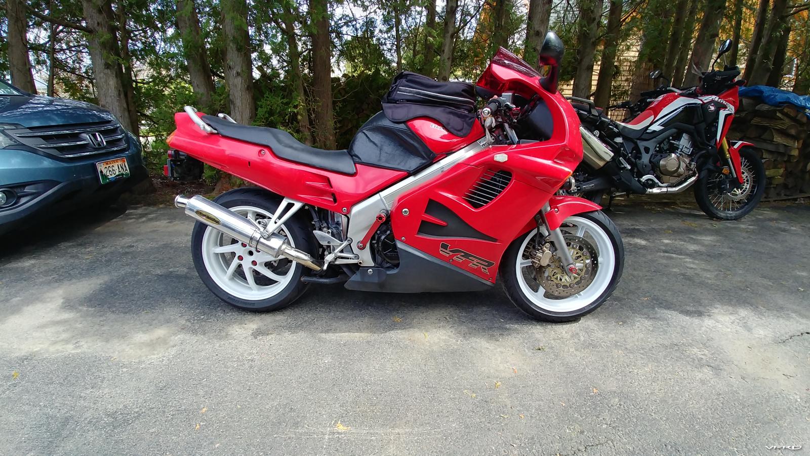

It says Epoxy on the label, but enamel in the description. It is easy to use, repairs well and is wallet friendly. I have about 25K on the rims now, I'm happy.  Just a thought.
To me it seems a bit brighter white than OEM, but I'm not a purist.
