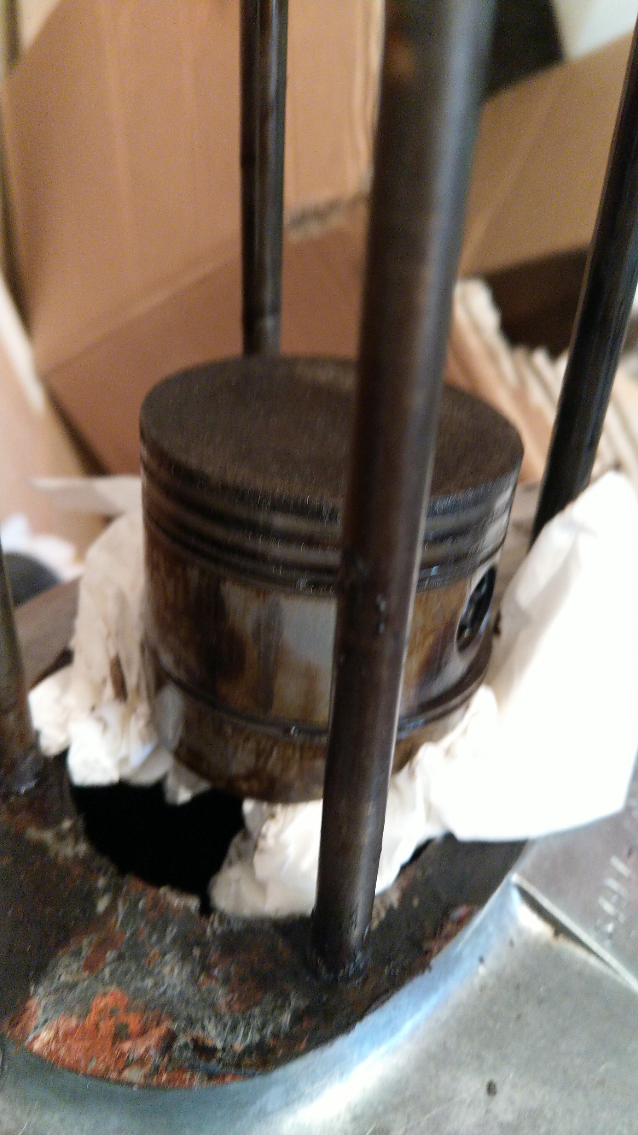

Member Contributer Dutchy Posted July 16, 2020 Member Contributer Posted July 16, 2020 My 1954 Gilera smoked more than an Sioux chief.... 🙂 No surprise with one (of 2) compression rings broken as well as one of the oil scraper rings.... Quote

Member Contributer TriumphTraitor Posted July 16, 2020 Author Member Contributer Posted July 16, 2020 1 hour ago, Grum said: Agree with Dutchy. Check the airbox PCV. No chance of an overfilled oil situation I guess? Other than that, no idea especially considering your low k's. I took a look, nothing out of the ordinary. The air box is bone dry! its quite peculiar. Oil level is about 1/16" below the max fill line. Maybe its just the oddity of my bike that I'll need to accept haha - i mean they all have their own quirks, don't they? @dutchy - Boy that piston certainly has seen better days, must have run like a champ after a rebuild? Quote

Member Contributer Dutchy Posted July 17, 2020 Member Contributer Posted July 17, 2020 8 hours ago, TriumphTraitor said: @dutchy - Boy that piston certainly has seen better days, must have run like a champ after a rebuild? I have yet to find the time (and have dry weather) to take the engine from the frame, split it and clean its internal like the big end. These engines have no oil filter (the metal gauze in from of the oil pump doesnot count) This an example of what can be expected Source: my pal Renato in Italy https://www.rpw.it/Motori/Gilera150_RE/Gilera150_RE.htm The head (of a donor engine) has been honed/refreshed and a spare piston has fresh compression and scraper rings to be put on later. the rings are yet to be rotated into a specific pattern) Quote
