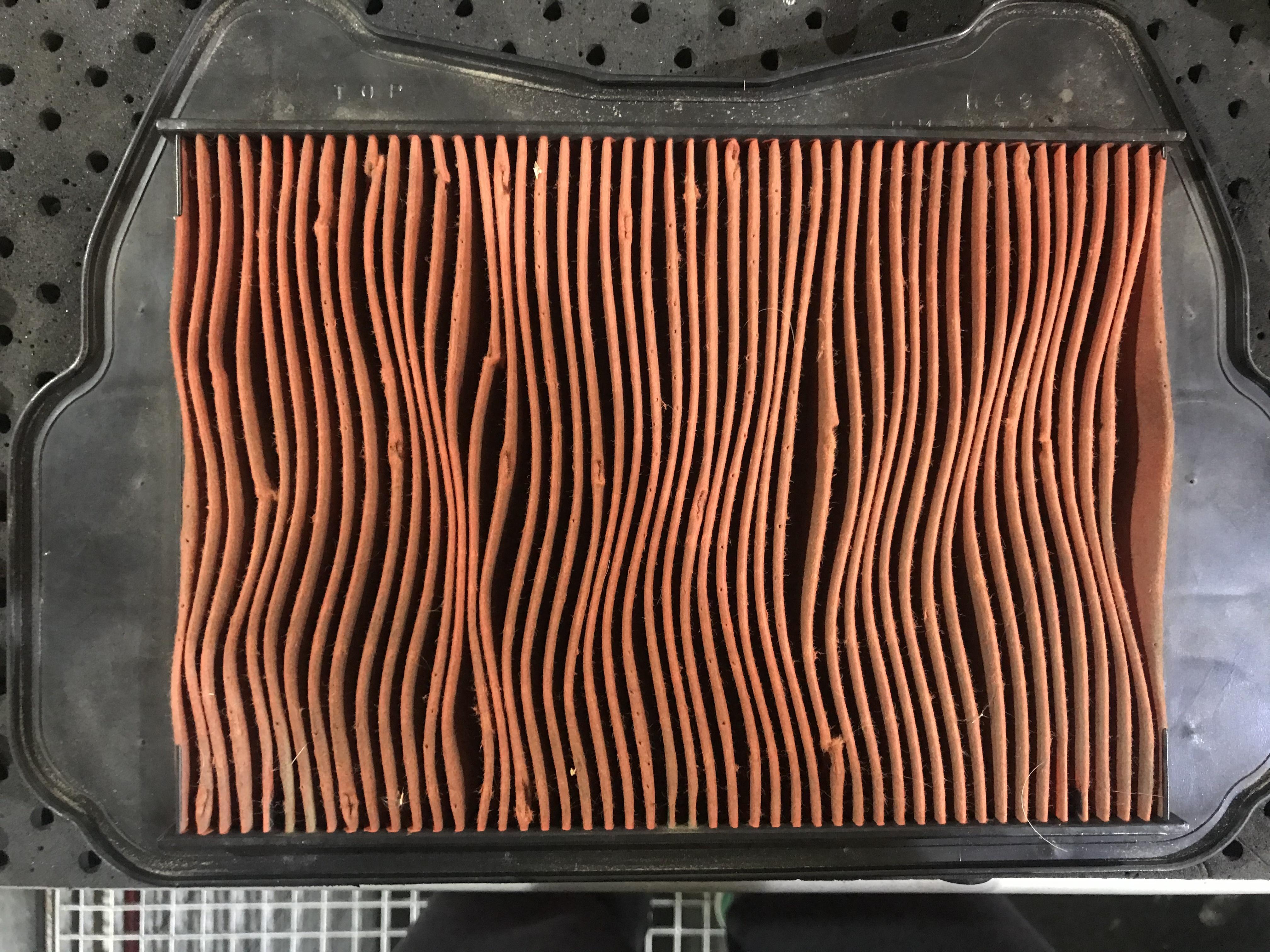

Peka Posted June 26, 2020 Posted June 26, 2020 Hello all, recently bought VFR750FL 1989. Great bike! except... doesn’t run above 9k rpm. Do you have suggestion what could it be? Carbs possibly? Today I check fuel hose, had a hole in it, so I fixes it. Also, I check if fuel filter, and it is not clogged. I check air filter, seems fine, but I’m going to replace it, since now I only cleaned it with air pressure. any comments, or suggestion would be great! if you want, more pictures are coming 👍🏻 Quote

Member Contributer Dutchy Posted June 27, 2020 Member Contributer Posted June 27, 2020 On the airfilter, an aftetmarket from for instance louis.de is a lot cheaper than Honda OEM. Brand name is "Delo" Quote

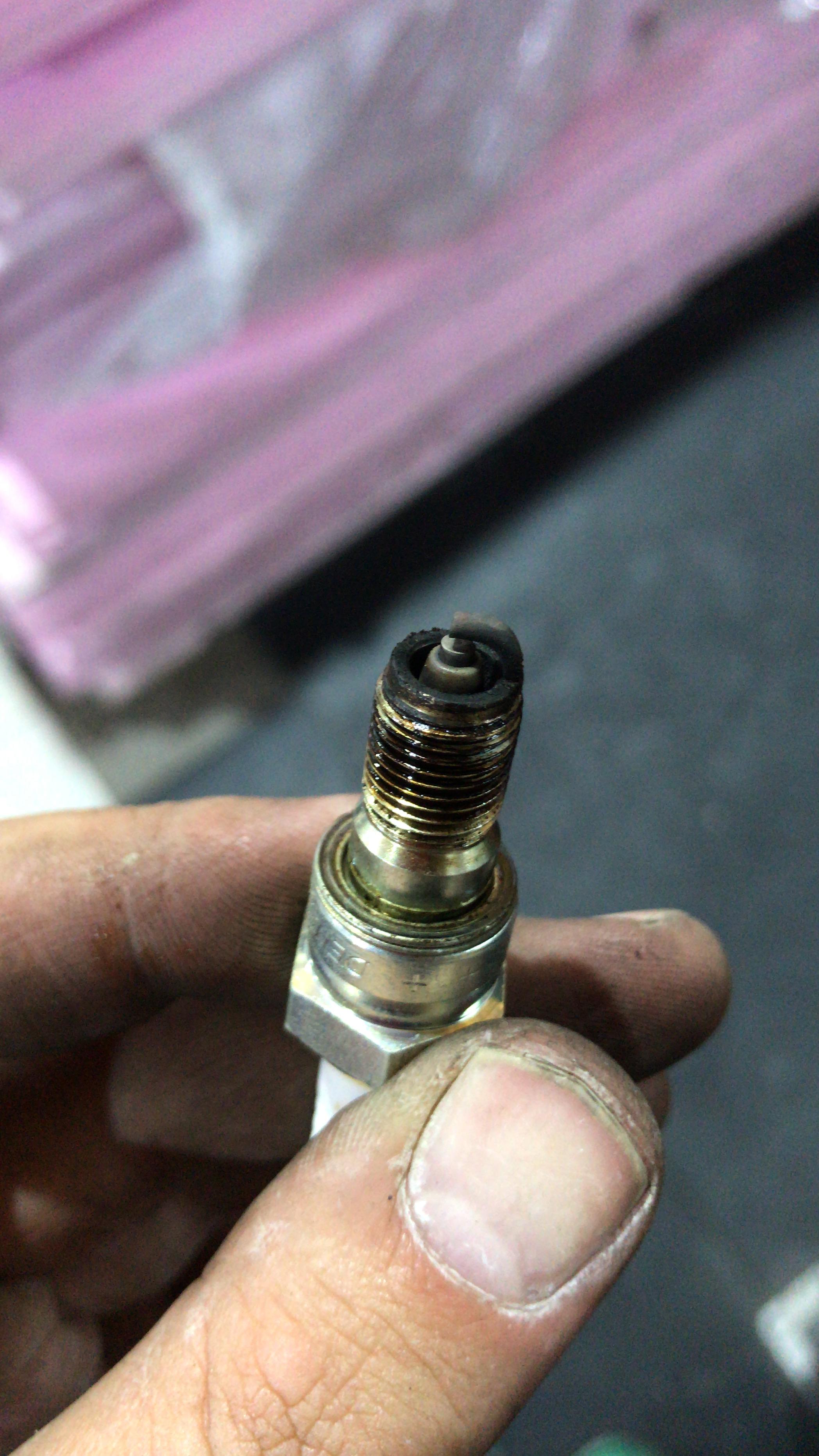

Peka Posted June 27, 2020 Author Posted June 27, 2020 Thanks Dutchy. Today I’ve cleaned carbs and check membranes, they are fine, and carbs are nice and clean. but now it goes worse than before??? Previously, on neutral I could rev u to 11,500 rpm, now it is stucked to 9 even on neutral. checked sparkplugs, I would need to change them, but I need to order them, and air filter as well. regarding regulator, previous owner put brand new OEM, as he told me, and It is working great! Question for sparkplugs: do I need to remove fan and coolant, in order to change front sparks? Quote
Member Contributer Thumbs Posted June 27, 2020 Member Contributer Posted June 27, 2020 It’s running rich .....so did you check the float height and/or replace the float valve needles? Are the jets clear? The radiator should swing out the way to allow access to the front plugs Quote
Member Contributer Dutchy Posted June 27, 2020 Member Contributer Posted June 27, 2020 1 hour ago, Thumbs said: The radiator should swing out the way to allow access to the front plugs It will be a tight squeeze, best ask a girlfriend with small hands.... I used a wooden wedge to gently "force" the radiator out of the way a bit more.... The regulator may be new, but if the altenator is on its way out..... 1 hour ago, Thumbs said: Quote
squirrelman Posted June 27, 2020 Posted June 27, 2020 new plugs might help.......check gap = .032" post photo of all plugs in bike now. need 2 see all, not just one. Quote
Peka Posted June 27, 2020 Author Posted June 27, 2020 4 hours ago, Thumbs said: It’s running rich .....so did you check the float height and/or replace the float valve needles? Are the jets clear? The radiator should swing out the way to allow access to the front plugs Jets are clean. Didn’t check float height. How much should it be? I can’t order air filter in country that I live.... no body have it. This is old one. thanks for the tips regarding radiator. I’ll try once I get sparks! Quote

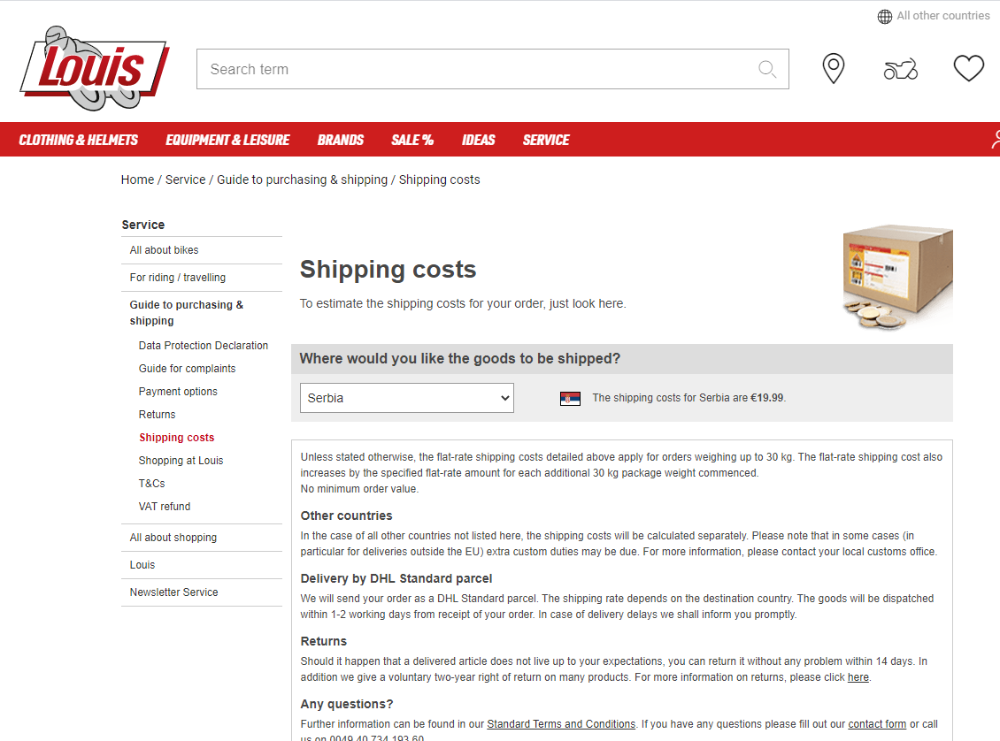

Member Contributer Dutchy Posted June 28, 2020 Member Contributer Posted June 28, 2020 18 hours ago, Peka said: Jets are clean. Didn’t check float height. How much should it be? I can’t order air filter in country that I live.... no body have it. This is old one. thanks for the tips regarding radiator. I’ll try once I get sparks! www.Louis.eu ships to Serbia (DHL); best order everyting in one go as shipping costs are eur 20 1 Quote

Peka Posted June 28, 2020 Author Posted June 28, 2020 47 minutes ago, Dutchy said: www.Louis.eu ships to Serbia (DHL); best order everyting in one go as shipping costs are eur 20 I will order it, just this is not related to air filter, in my humbly opinion. I removed air filter, just for testing purposes, and it is the same thing Quote

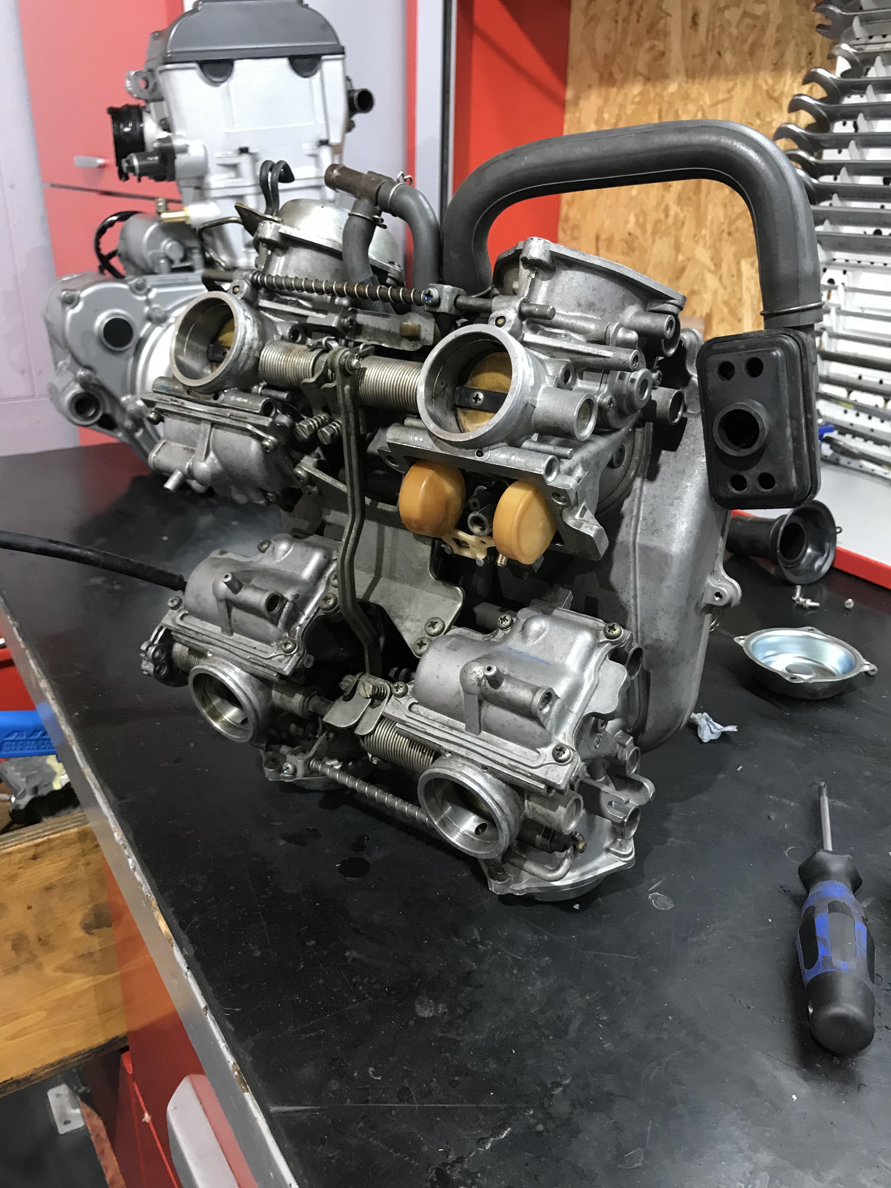

Peka Posted June 28, 2020 Author Posted June 28, 2020 I wanted to check if diaphrags are opening all the way and this is what I notices. One of them sometime it doesn’t close FullSizeRender.mov Quote
Member Contributer Thumbs Posted June 28, 2020 Member Contributer Posted June 28, 2020 I can see the slide stopping in the first video, what’s the second one showing? I washed the slides with Simple Green then rubbed the outside with a pencil to leave graphite as a lubricant 1 Quote
Peka Posted June 28, 2020 Author Posted June 28, 2020 9 minutes ago, Thumbs said: I can see the slide stopping in the first video, what’s the second one showing? I washed the slides with Simple Green then rubbed the outside with a pencil to leave graphite as a lubricant I was thinking the same thing, some how to lubricate slides. Second is showing that only one slider opens when throttle is given. Quote
squirrelman Posted June 28, 2020 Posted June 28, 2020 On 6/27/2020 at 10:45 AM, Peka said: Today I’ve cleaned carbs and check membranes, they are fine. so u first say ok and later no ok ? u might have screwedup cap after inspection. test by blowing air into the large black hose on carbs and all slides should rise up. 1 Quote
Peka Posted June 29, 2020 Author Posted June 29, 2020 14 hours ago, squirrelbrains said: so u first say ok and later no ok ? u might have screwedup cap after inspection. test by blowing air into the large black hose on carbs and all slides should rise up. Sorry for wrong information. I will inspect caps and diaphragms again... maybe I didn't put them nicely... Quote
Peka Posted June 30, 2020 Author Posted June 30, 2020 When I blow air into black hose, only one slide rise up. I will open carbs again to check it Quote
Peka Posted June 30, 2020 Author Posted June 30, 2020 Ok! It works so much better. Actually, is working by far better then when I purchase it. It runs all the way up to 11500 rpm. But on the end it struggles a little bit. tomorrow new spark plug and air filter are arriving. And I want to order new membranes and sliders. Do you know where can I do that? thanks for all help!!! 😊😊 FullSizeRender.mov Quote
