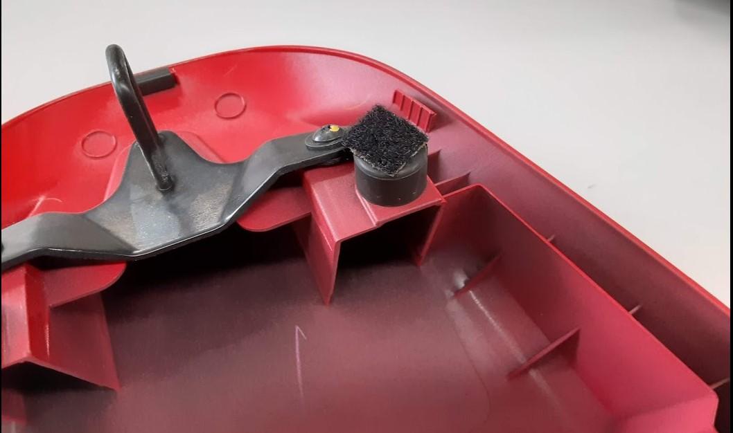

Goldcrown44 Posted June 19, 2020 Posted June 19, 2020 Does this look like it's missing any pieces underneath? I see the rubber stops, etc, and though my hand is covering the right side somewhat, it is the same as the left. The rear most part of the seat cowl doesn't sit staticly. I can press down and the plastic makes hard contact with its mount like it's missing a rubber piece of some kind so while I'm hitting bumps in the road, it's making minimal, but hard contact. Best I can tell, everything is there per parts breakdown diagram. I might need to craft a cushion of sorts. Quote
Viffer Posted June 19, 2020 Posted June 19, 2020 Hi, New to the forum. When I pulled the tail off my recently purchased VFR I noticed some velcro on the two rear bumpers. I figured the PO must have had an issue with it vibrating. 1 Quote

Greytec Posted June 20, 2020 Posted June 20, 2020 Hi, New to the forum. When I pulled the tail off my recently purchased VFR I noticed some velcro on the two rear bumpers. I figured the PO must have had an issue with it vibrating. I did the same with mine, is quiet now.Verstuurd vanaf mijn SM-A520F met Tapatalk 1 Quote
Goldcrown44 Posted June 22, 2020 Author Posted June 22, 2020 On 6/19/2020 at 2:44 PM, Viffer said: Hi, New to the forum. When I pulled the tail off my recently purchased VFR I noticed some velcro on the two rear bumpers. I figured the PO must have had an issue with it vibrating. Any chance you can post a pic of the previous owners mod? Quote
Viffer Posted June 23, 2020 Posted June 23, 2020 Here are some pics. The PO attached Velcro to the 2 rear bumpers. I also noticed that he added two small strips of thin rubber where the 2 front bumpers come to rest on the bike. Still waiting to see if he can find the tool kit. 2 Quote
Goldcrown44 Posted June 25, 2020 Author Posted June 25, 2020 I just did the velcro thing to the aft round rubber stops, and added a layer of cushion to where the fore rubber stops make contact and it works great... no more cowl rattling. Quote
