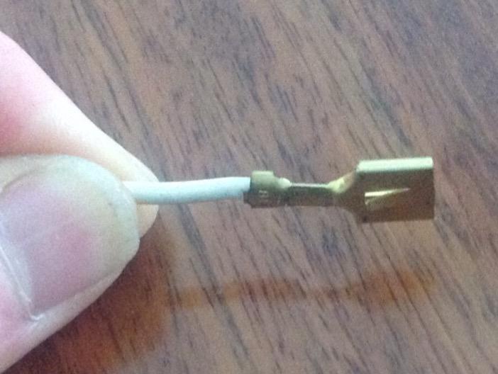

There is generally a tang underneath the Spade connector that locks it into the plastic connector. You will need to slide something small and thin in from the front as you pull the wire from the rear. See photo.

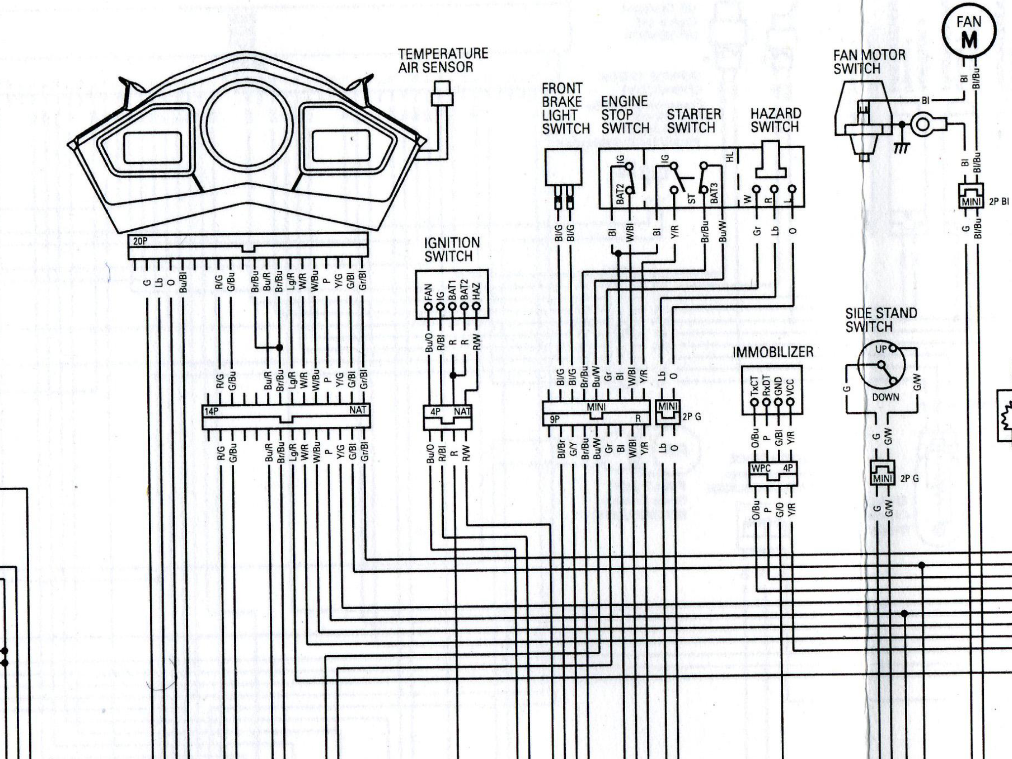

The plain RED is from your Main Fuse A at your Starter Relay it's the main 12v supply to and from (from via the Red/Black wire) the Ignition Switch.
If its getting really hot then it must be at the connector as a bad hi resistance joint, there's already signs of heat stress discolouration of the plastic connector at the Red wire.
Sometimes it can be caused by a bad/loose crimp of the wire to the spade connectors or (over time) just poor connection between the two. OR lastly, excessive loads added to the electrical system!
Probably the best solution is to cut the Red wire solder and sleeve them together. You could also just leave the Red wire and connector as is, but solder a bypass wire, carefully remove some of the insulation of the Red wire above and below the connector and solder a similar gauge wire to the Red wire, you'd have to properly insulate your repair, you'd never want this wire to touch frame!

What you're holding is the junction of the Red wire for the BAT1, BAT2 connections of the Ignition Switch. See attached.
Dont't forget be careful, once you are plugged into the 4P plug those wires have 12v on them. Best to Pull the Fuse.
That joining ferrel could be a good soldering point for a connector by-pass wire.
