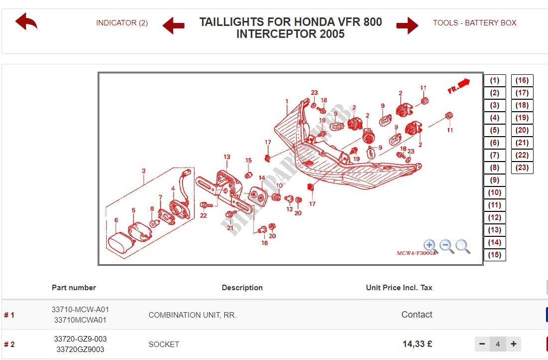

Member Contributer schrackster Posted February 5, 2020 Member Contributer Posted February 5, 2020 I'm trying to convert my 2005 tail light and front turn signals to the 2007 year clear lenses. I purchased the OEM clear 2007 tail light and clear front turn signal lenses. Tried to install them but the connectors that house the light bulbs are different and will not fit into the new parts. Has anyone tried to do this? If so, what am I missing? I'm thinking I have to purchase the bulb connectors and rewire my 2005 harness front/rear with 2007 connectors (that house the bulbs and connect to the light enclosures). I don't want to have to by the main wire harness, which is about $300 (which would be for the tail light), the front harness is about $100. Does anyone know where I can get just the light bulb connectors from the 2007 model year? I've looked around the forum and couldn't find a discussion on this mod. Thanks.... Quote

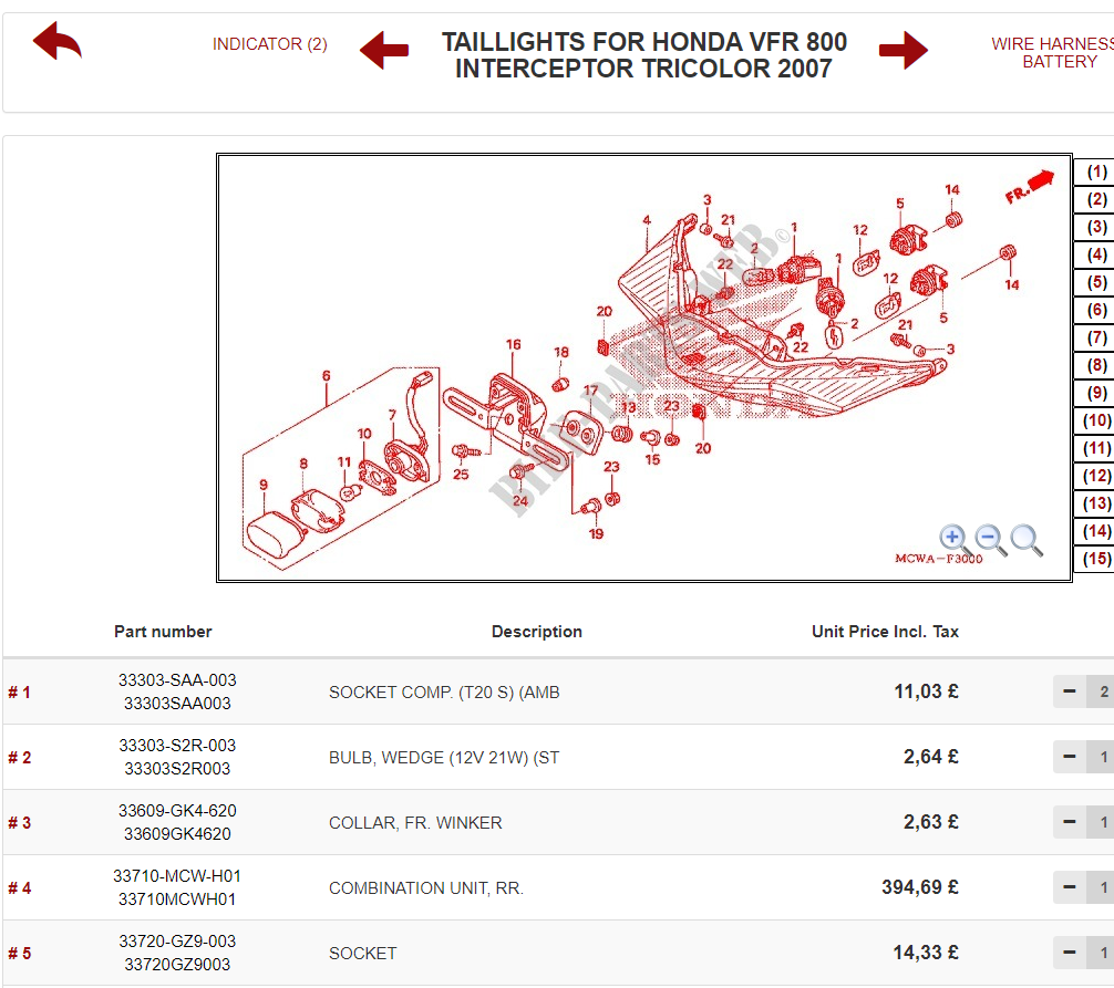

simo5555 Posted February 5, 2020 Posted February 5, 2020 What you need is a T20S amber sockets (honda part no. 33303-SAA-003) and oval shaped connectors for them (part no. 04321-S5A-307P). Its the newer honda connector that replaced the old one (not sure why). You can just solder the connector to your existing wiring - no need to rewire the main harness. Its just 2 wires. The T20S socket was also used in some newer Civics and some acuras so you might find the connectors from your local scrapyard for next to nothing. Or you could ask from dealership for them. Not sure about the US, but in europe it costs something like 15€ for a set of connector. The brake light socket should be the same as the old one. Quote
Member Contributer schrackster Posted February 6, 2020 Author Member Contributer Posted February 6, 2020 You guys are AWESOME!!! I’ve been beating my head on the wall on this for a couple of months. I’ve been looking at the parts diagram, but didn’t see the one “Milepig” posted above, thanks LocalRacer as well. I’ll order those connectors and I should be good to go. The main brake light is the same, its just the turn signals that use the newer connectors. Much appreciate the help on this mod. Will show photos when done, but it will have to wait a couple of months as I’m in the Philippines for work. Quote
