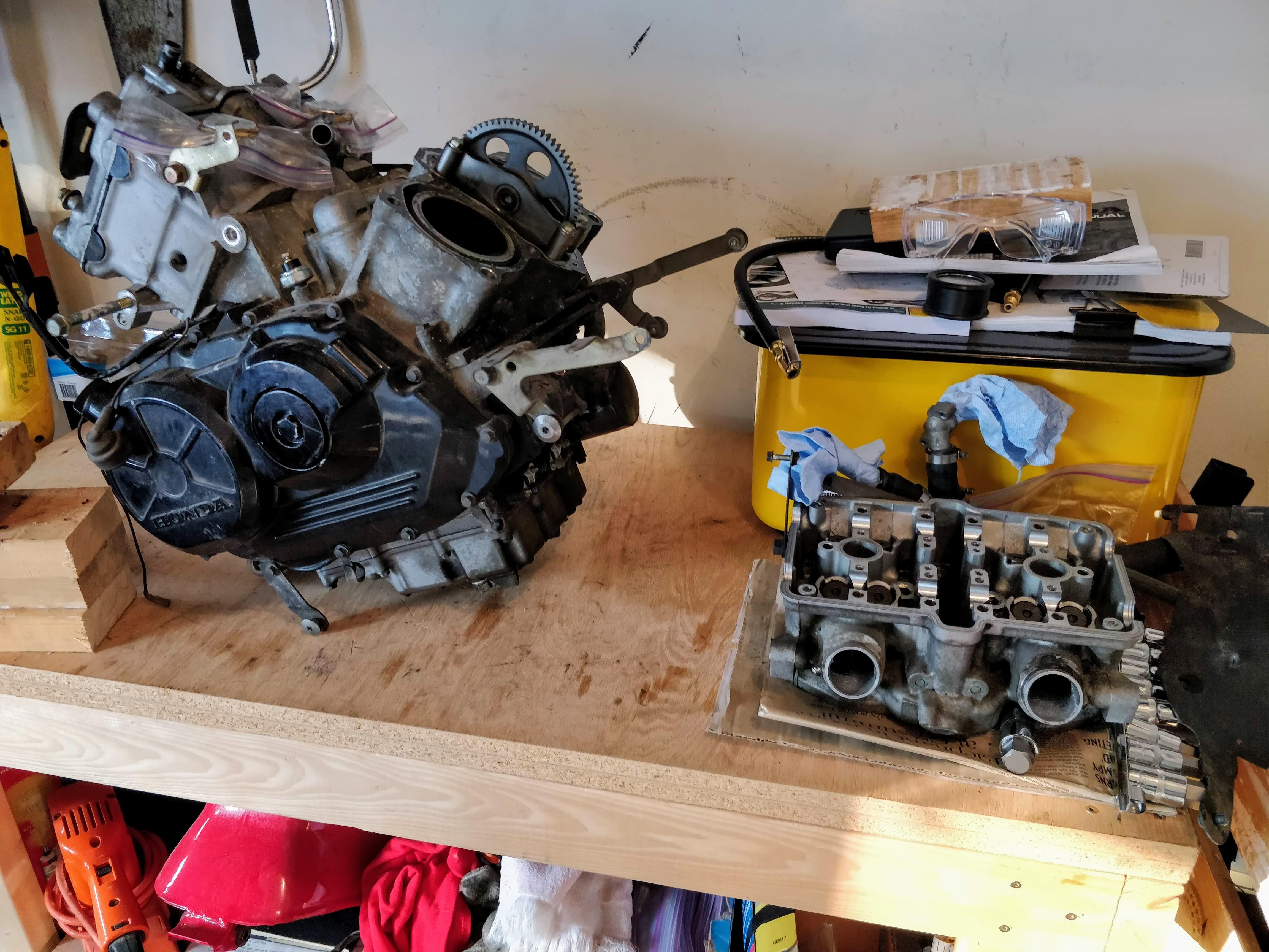

Member Contributer 5thave Posted December 26, 2019 Member Contributer Posted December 26, 2019 Okay, I've been MIA for a while. Back in May 2018 I was working on the bike: I've finally gotten around to putting a few hours into the project again. This may be a long-term project. But today, with a little help from a friend we got the engine out and onto a workbench. For what it's worth, the low (near zero!) compression in one cylinder is a mystery. I expected to find a bent valve or damaged valve spring. Nope. The head is 100% fine. All valve clearances were within spec before we started, and there is no visible damage to the piston crowns or cylinder walls. I will have to invert the engine and disassemble it to find whether piston rings are the problem. I expect that must be the case. Quote
