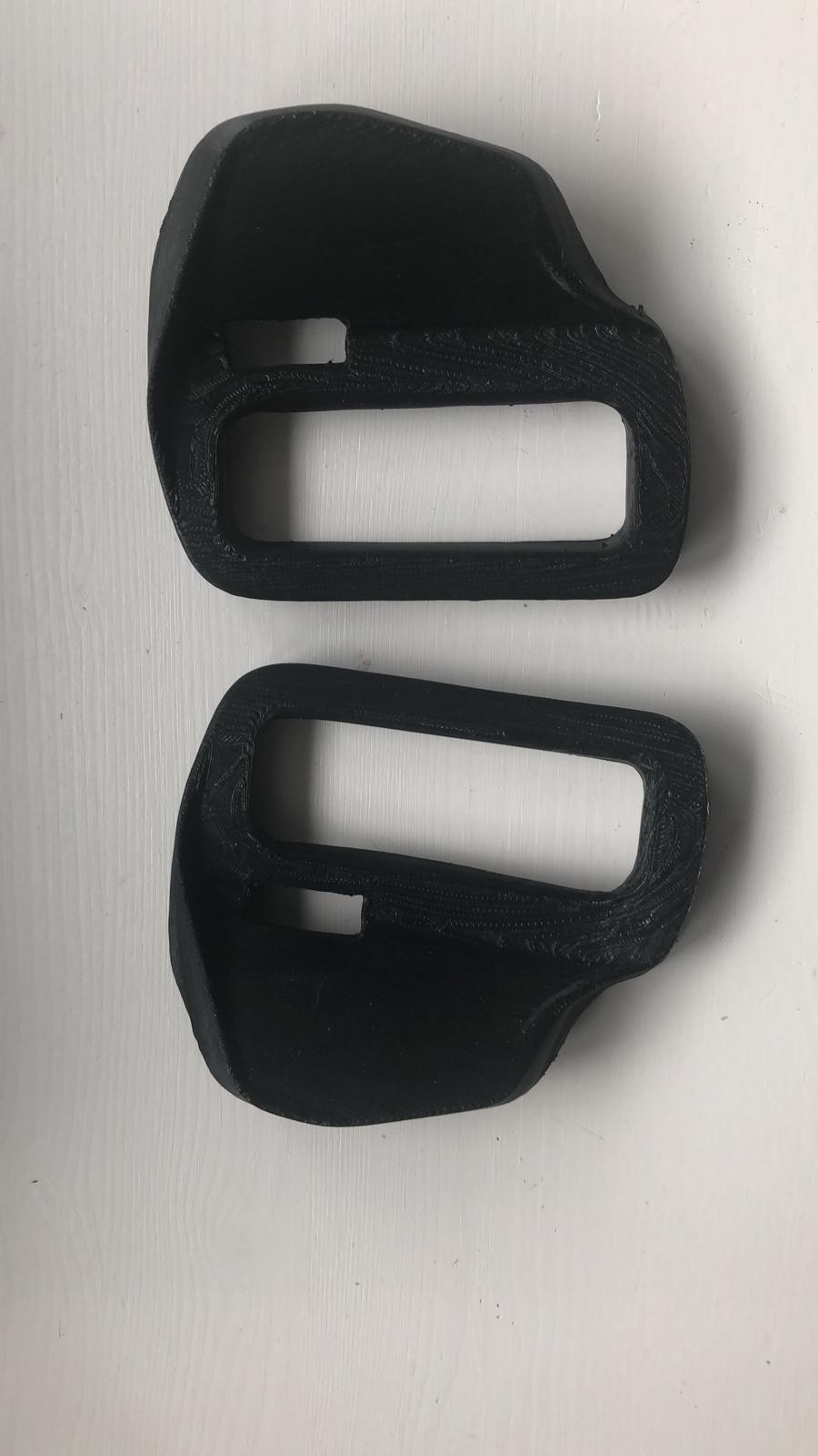

Wackywabbit Posted May 7, 2020 Posted May 7, 2020 Is it possible to send me the scan files?, I have been looking for these for quite some time but am unable to find the spacers. The only thing is I live in the Netherlands, so having them made by a company in the US will probably give me a huge bill for sending. So having it 3d printed myself might be a better idea. Quote
Member Contributer Calculon Posted May 7, 2020 Author Member Contributer Posted May 7, 2020 7 minutes ago, Wackywabbit said: Is it possible to send me the scan files? I've added the files to the Download section here at VFRDiscussion, you can find it here: Good luck getting them printed. It's important to use the right material, has to be a softish/flexible elastomer. Quote

Wackywabbit Posted May 17, 2020 Posted May 17, 2020 Yes, 3d printing finished! Thanks again for the files. 1 Quote
Member Contributer Calculon Posted May 17, 2020 Author Member Contributer Posted May 17, 2020 8 hours ago, Wackywabbit said: Yes, 3d printing finished! Thanks again for the files. Cool! Hope it works for you too. Quote
