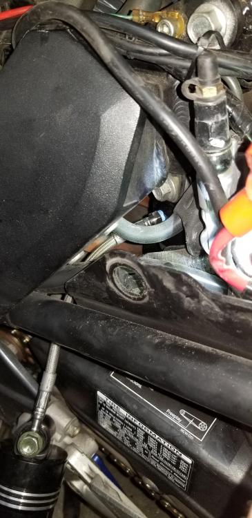

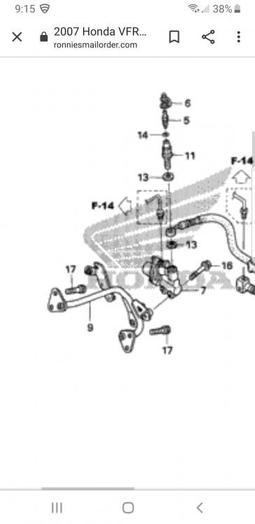

triharder Posted October 25, 2019 Posted October 25, 2019 Anybody deal with this on a vfr. The bd40 reservoir lives on the shifter side of bike. But the pcv stay item 9 is already located where the hose needs to go. anybody have an easy solution 07 vfr non abs I.m wondering if a 90 degree fitting woukd clear. I.d rather not remove subframe, rear fender and exhaust unless somebody has had this issue and has proven the hose clears with top mount tightened? Thanks Quote

0 triharder Posted October 25, 2019 Author Posted October 25, 2019 Called Jamie yesterday, he said he intended the shock to have reservior on the shifter side. I think this stay would be exactly in the way on the other side too and you won't have enough hose lenght to mount to subframe on that side. Although i didn't try it (i have a lot of electrical stuff ont hat side for heated grips, gps, powerlet etc). the 90 degree fitting would make this a 1 hour job instead of the day it will take the remove the entire rear end of the bike. **Make sure you have a jack and be ready to put the swingarm up and down a bunch, remove the top shock mount nut from under the tank, remove the dogbone (as it won't clear without it removed). I also marred up the spring coating as was frustrated and the swingarm keep landing on it. (might consider painters tape or going way slower when you install). these brackets changed year to year so the 2002 may not be an intereference or an issue. I will follow up when i have a solution. Quote

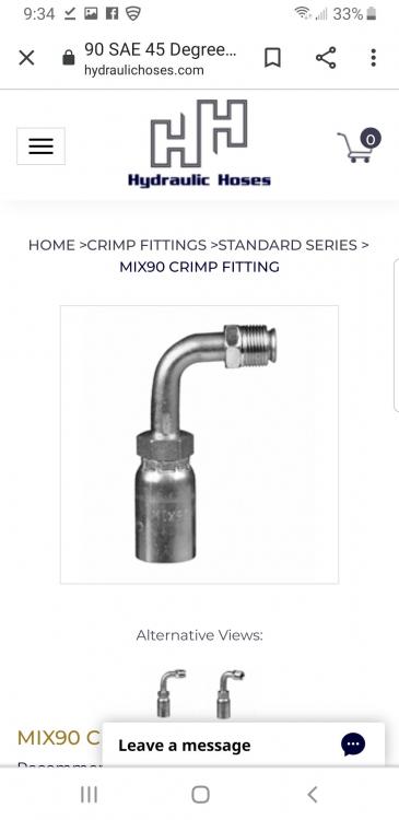

0 triharder Posted October 25, 2019 Author Posted October 25, 2019 I'm working with DMR having the straight fitting swapped with 45 degree fitting. Marooncobra You might consider doing the same at construction of the shock. To really see the bracket i had to pull the battery and the rear seat mechanism lock barrel, I guess i'd start at the microfiche for the 2002 and see if its the same. (jamie said he did have old emails of similar problems, but the end user was able to modify the bracket). Why are you replacing the Ohlins? (besides the maintenance costs) Quote
