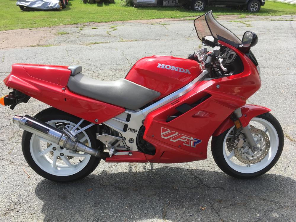

I have a 1990 VFR750 that I have returned to the road after many years of sitting around ( 15,000km ) ( 9000 miles )
To give you an idea as to the current condition of the bike the following may help
