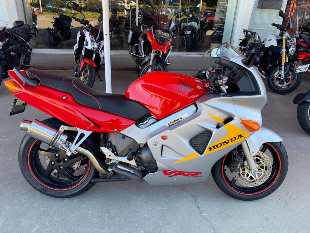

Cluggo Posted August 25, 2019 Posted August 25, 2019 Just purchased a 1999 vfr800 today. It’s the red, silver anniversary edition that people either love or hate. It’s got 49000 km on it and rides great. I’ve come off a versys 650 so it’s a big step up...even tho I love the versys....apart from the seat. Is there anything you can recommend that I should do straight away apart from change oil, filters, check rectifier, chain? It does have one issue, that is it will only start with side stand up, even in neutral. Must be a faulty switch so I’ll need to get that fixed. Has anyone got any suggestions? 2 Quote

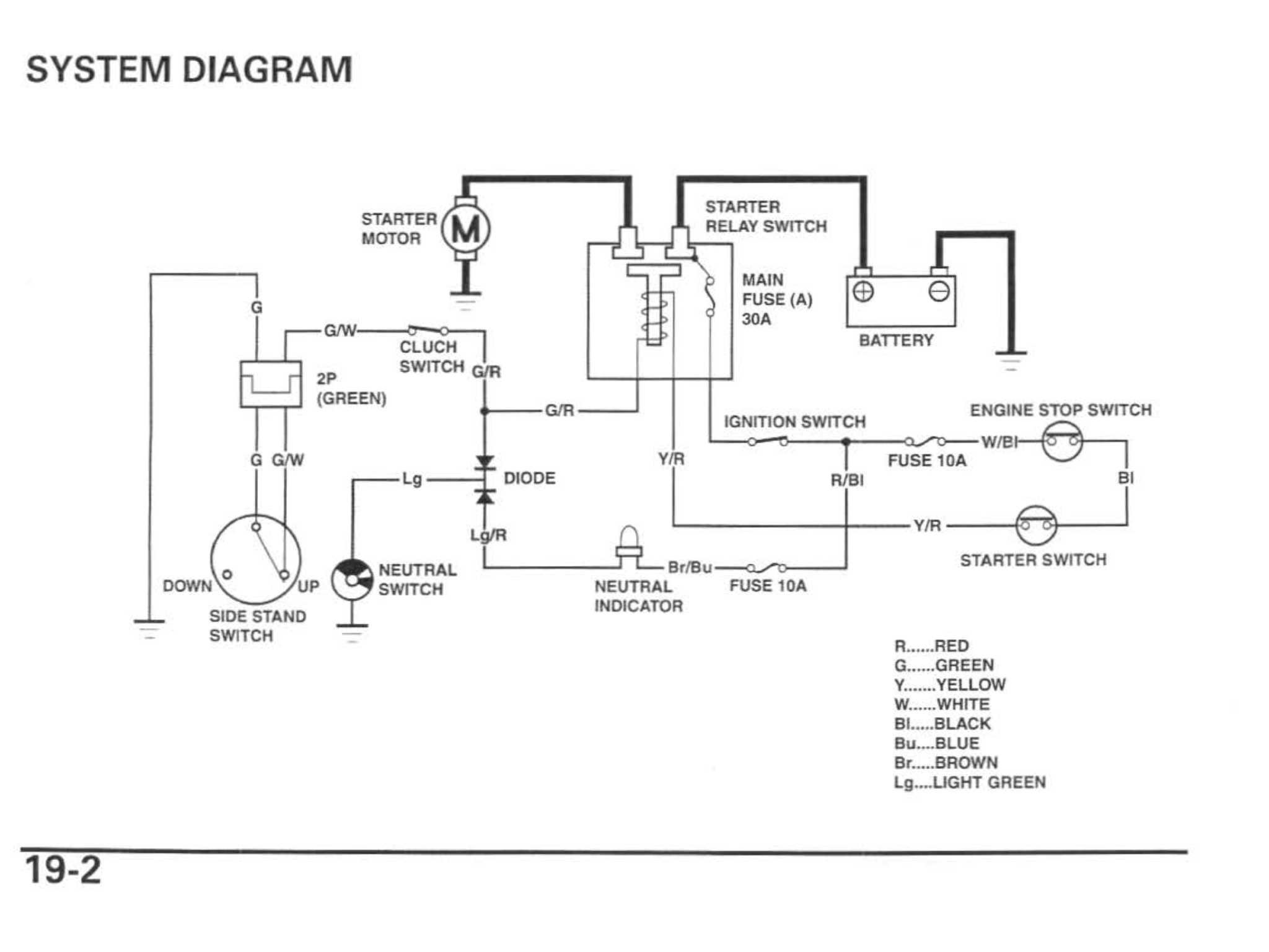

Member Contributer Grum Posted August 26, 2019 Member Contributer Posted August 26, 2019 44 minutes ago, Cluggo said: Thanks so much grum. Not sure if I have to have clutch in tho, still up at dealers so will check You would have to have the clutch pulled In otherwise the Sidestand has NO effect! UNLESS the clutch switch has been By-passed! And that would be dangerous. Perhaps the dealership should sort this issue for you, make it part of your purchase agreement! Where in Aus are you? Quote
Member Contributer Terry Posted August 26, 2019 Member Contributer Posted August 26, 2019 You're right Grum; the earth path for the starter solenoid must go through EITHER the neutral switch (in neutral) OR the clutch switch (pulled in) AND the sidestand switch (stand up). So if you always have to have the stand up to start, then the neutral switch (or the wire) may be disconnected. The diode need not be involved. What is the neutral light doing? Quote
Cluggo Posted August 26, 2019 Author Posted August 26, 2019 Neutral light works fine, and I don’t need to hold the clutch in to start the bike, just the stand needs to be up. Quote

Member Contributer Grum Posted August 26, 2019 Member Contributer Posted August 26, 2019 On 26 August 2019 at 5:36 PM, Cluggo said: Neutral light works fine, and I don’t need to hold the clutch in to start the bike, just the stand needs to be up. Then the bike has been modified! As you can see from the drawing which is actually shown with the Clutch Pulled in, the switch is closed. So the clutch switch is open circuit if NOT pulled, in this case, the Sidestand will have NO effect in the energising of your starter relay. Sounds like the Clutch Switch has been by-passed!! The worry is, if you are sitting on the bike and in gear with Sidestand up, you can just hit the Starter Button and your bike will jolt forward as the starter tries to kicks in!! Quote

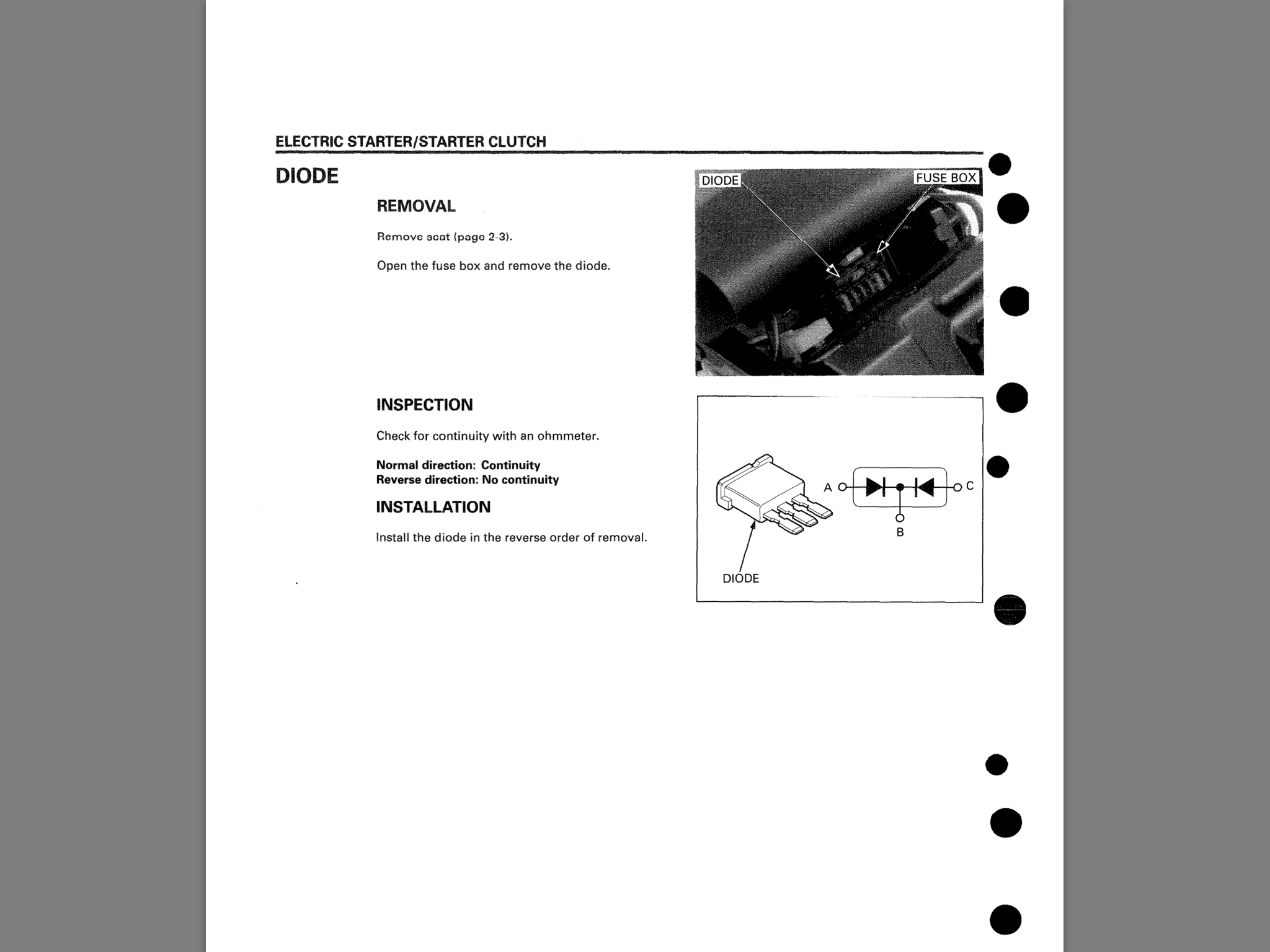

Member Contributer Grum Posted August 26, 2019 Member Contributer Posted August 26, 2019 Well perhaps they thought it just might be an easier way to get around the original issue, in that the Normal Neutral start was not working because of a potential Open Circuit Clutch diode. Hopefully it shouldn't be too big a deal to get it all back to standard ops. The fact that your Neutral light works means there is no issue with the Neutral Switch. Are you competent with a multimeter? I've mentioned above the easy way of checking the Diode. Have a good look at the clutch lever and see if you can locate the Clutch Switch near the base of the lever. With your ear close to the lever and as you slowly pull the clutch in you should hear an audible click as the switch activates, there should be two wire attached to the switch. Hopefully they are not just shorting wires!!!! But that would explain your situation if they were. Are you able to discuss the situation with the previous owner, they may give you a good insight as to what and why the starting system is not correct? 1 Quote
