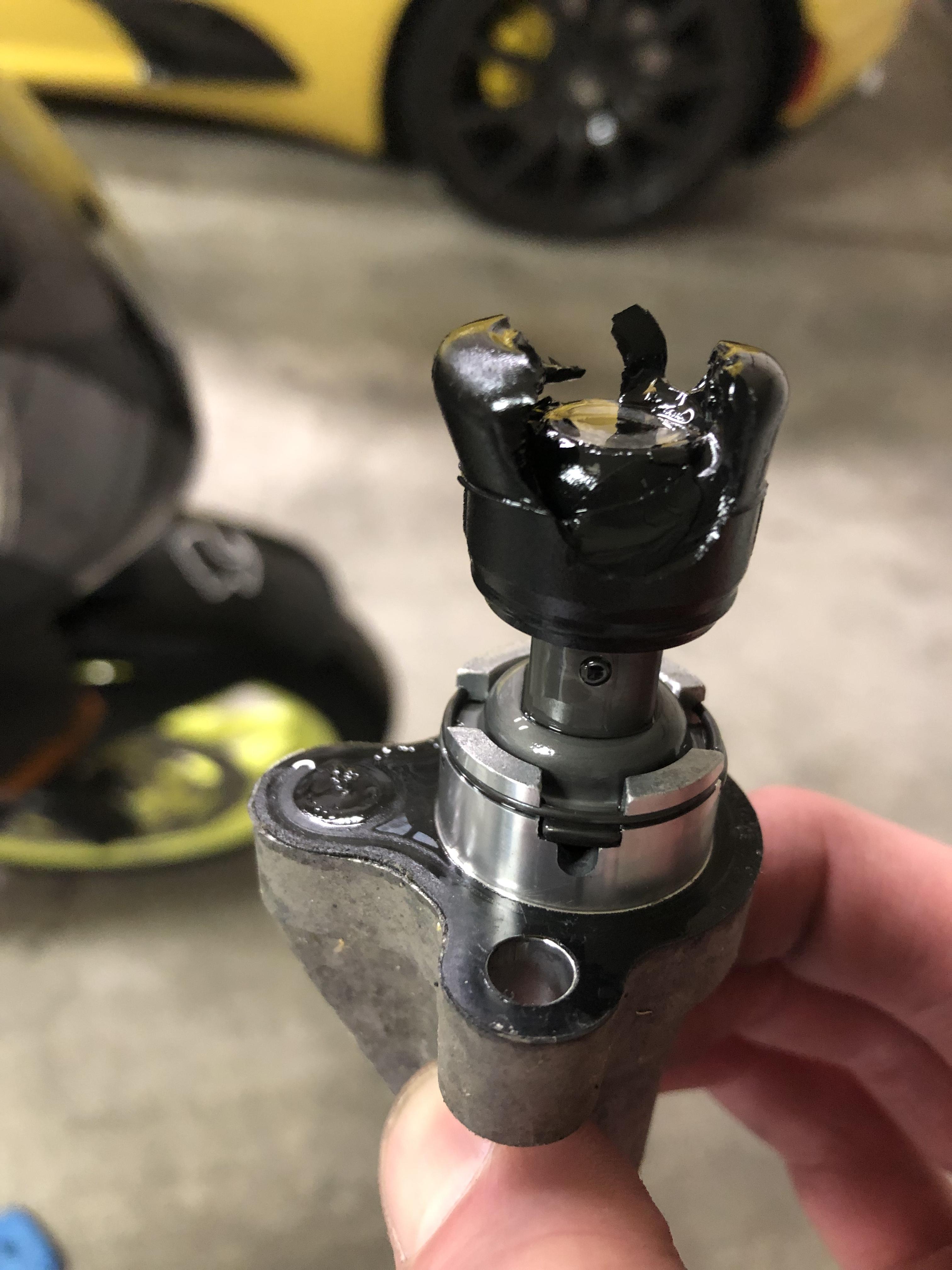

BrianF Posted August 4, 2019 Posted August 4, 2019 Need some help from the 6th gen experts here - changing my clattering, rattling CCTs today. Rear went fine, easy as pie. Then I gently extracted the front one so as to not disturb the metal cap annnnnddddd out came a CCT with no cap at all, just a rubber bumper completely destroyed and worn through all the way to the plunger’s metal base (see attached pic). I guess I now know the source of the god-awful noises coming from the motor, but any ideas on how this could happen? Could the PO have installed without the metal cap - or could the cap somehow come off while under tension (I assume not)? If the cap was in there somewhere, I’m guessing that would’ve been catastrophic already. I also presume those lost little rubber bits are now swimming in the engine - could that cause major damage if it hasn’t already? As background, I’ve been getting some rattling above 3.5-4K rpm for the last 5000 miles or so, and very loud metallic clatter from the front bank the last time I started the motor - though it idled and revved okay. None of the usual failing CCT idle rattles, but I just had a hunch as it’s the Achilles heel and always a good place to start. Any advice is appreciated, as always.
Member Contributer Marooncobra Posted August 4, 2019 Member Contributer Posted August 4, 2019 Sorry for your woes. Can you contact the previous owner and ask if he did a change of the CCTs and forgot to fit or dropped the cap? From here, I would remove the exhaust to allow you to drop off the sump. Approx 12 bolts. You have to drop the exhaust to remove the sump as the strainer and prv will stop you pulling the sump out of the way. Hopefully you will find the metal cap undamaged in the bottom of the sump. If there is no cap I would definitely be trying to get an answer from the previous owner. Once removed you will be able to remove the oil pick up strainer and clean out all of the rubber bits from the CCT. There are a few o rings that you will need to replace when you button it back up. Be aware there is no gasket between the sump and engine, just some Honda sealant. Let us know how you get on.
BrianF Posted August 4, 2019 Author Posted August 4, 2019 19 minutes ago, Marooncobra said: Sorry for your woes. Can you contact the previous owner and ask if he did a change of the CCTs and forgot to fit or dropped the cap? From here, I would remove the exhaust to allow you to drop off the sump. Approx 12 bolts. You have to drop the exhaust to remove the sump as the strainer and prv will stop you pulling the sump out of the way. Hopefully you will find the metal cap undamaged in the bottom of the sump. If there is no cap I would definitely be trying to get an answer from the previous owner. Once removed you will be able to remove the oil pick up strainer and clean out all of the rubber bits from the CCT. There are a few o rings that you will need to replace when you button it back up. Be aware there is no gasket between the sump and engine, just some Honda sealant. Let us know how you get on. I did text the previous owner, he's a VFRD'er as well. Hopefully will hear back from him soon. Cap or no cap I guess I'll need to clear the strainer before buttoning it all back up - thanks for the info on that. Gives me some hope!
Member Contributer BusyLittleShop Posted August 4, 2019 Member Contributer Posted August 4, 2019 My best learned speculation is the CCT was installed with out first retracting the center plunger... the rubber cap was damaged as the 2 CCT bolts homed in the Tensioner to the head... you might want to inspect the CCT slipper for damage...
BrianF Posted August 11, 2019 Author Posted August 11, 2019 The story continues... Confirmed last week with the PO that he was pretty sure did not install the metal cap on the front CCT about 19k miles ago. Let that serve as a lesson to all - use the cap or your rubber shall explode and the engine could become pregnant. Today I drained the oil, took off the exhaust, cleaned out a few rubber bits from the sump, sealed it back up, filled the oil, replaced the front CCT (now with cap!), and meticulously put everything back together. Turned the crank a couple of times using the access hole (where I'd also set to TDC on 3 (rear) and 1 (front) to be safe) and all seemed good. Double checked all the connections and vacuum hoses just to be sure. Once all was reassembled I hit the starter and got a colossal rattle for about 3-5 revolutions of the crank. Cycled the ignition and tried again, and now it will turn over just fine (sounds totally normal) but does not fire. No FI light, kill switch on, neutral, stand up/down doesn't make a difference. Fuel pump primes fine. Any ideas? Timing issue? Those who have replaced CCTs have there been any untoward noises the first time you've fired it up?
