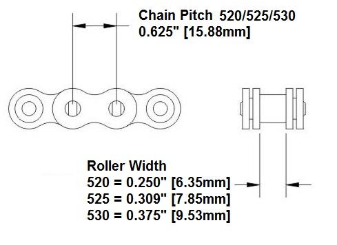

skant153 Posted July 18, 2019 Posted July 18, 2019 your chain shouldn't really be making a whole lot of noise to begin with but i get wanting the sound dampened one. If you can't get it in 530, is there a reason (other than not wanting to buy a new chain) you can't go 525 or 520? they're the same pitch just different widths. i suppose you could put a 530 on a 525 sprocket, there will just be some play, maybe put a .033 shim on either side? Quote
