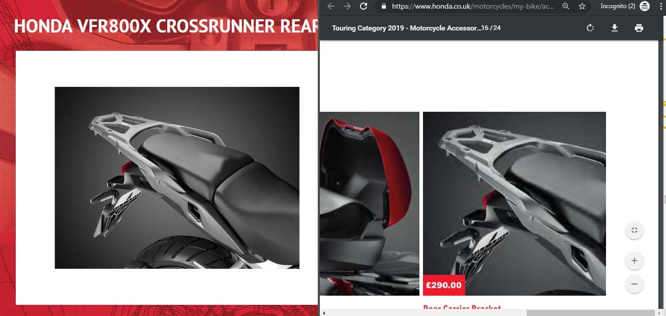

2015vfr Posted July 1, 2019 Author Posted July 1, 2019 Also, the picture that CMD has and the one in the Honda accessory catalog are the same. I checked with the dealer I bought the bike from and they're not able to get the rear carrier anymore either. Quote

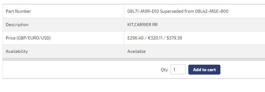

2015vfr Posted July 2, 2019 Author Posted July 2, 2019 Well for anyone looking in the future, Honda UK uses a different rear carrier (its black instead of the tan/bronze? look of the US one) 08L71-MJM-D10 Superseded from 08L42-MGE-800 https://www.honda.co.uk/content/dam/local/uk/brochures/motorcycles/Accessories/VFR800F.pdf Quote

Member Contributer fink Posted July 2, 2019 Member Contributer Posted July 2, 2019 15 hours ago, Skids said: On what are you basing that m8? 15 hours ago, Skids said: On what are you basing that m8? The fact that the 45l brackets for the vfr are 3 part and different shape to the cross runner. Whilst the mounting holes holes will be the same the area around the back of the seat is different. Vfr one is black the crossrunner is greyish. You obviously know better, so do they fit? the vfr1200 carrier fits. Quote

2015vfr Posted July 2, 2019 Author Posted July 2, 2019 20 minutes ago, fink said: Try cmsnl Thanks, I did check there and they have it for $440 shipped, that's a bit steep. although the image looks like the black carrier (08L42-MGE-800) Lings got back to me with the alternate number (I think this is the same as 1200 carrier) which is a bit more affordable (about $300, which matches the US price). Total for the whole rear luggage set came in under $800 shipped. I'm also getting the quick shifter which should be fun Quote

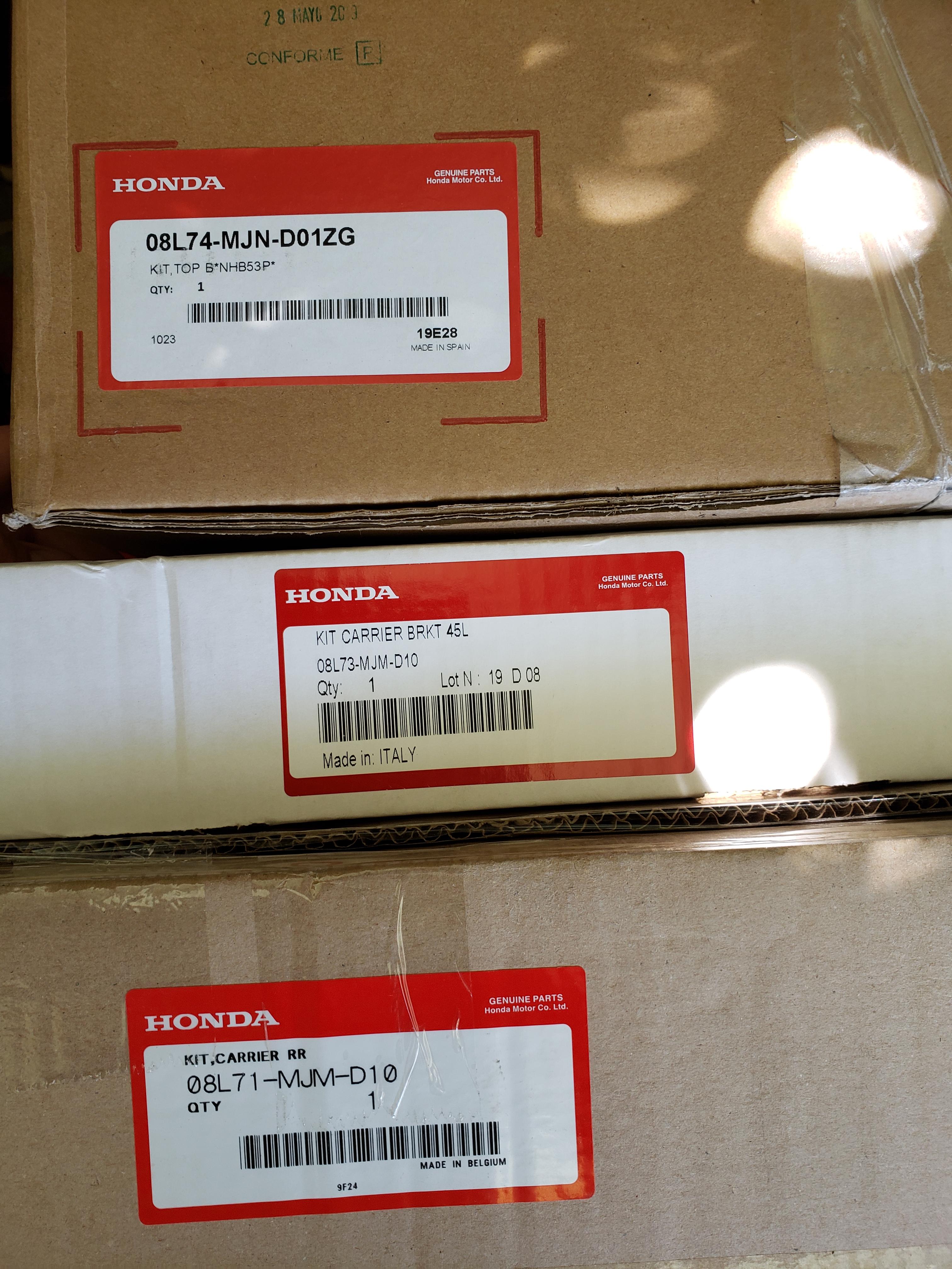

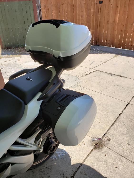

2015vfr Posted August 11, 2019 Author Posted August 11, 2019 I ended up buying from lings Honda in the UK. They use different part numbers but the cases are available. This is for the 45l in white Quote
