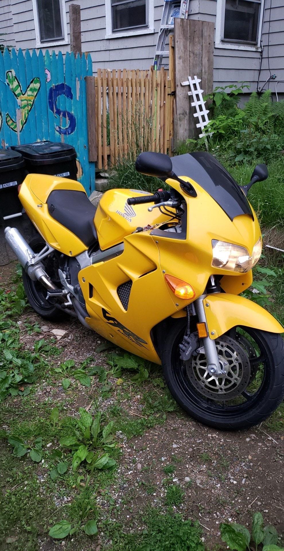

Found myself bike-less, because reasons, but suddenly I had the opportunity to buy this canary yellow 2000 VFR. I got it for 2K, smooth. 25k miles on the clock and it looks minty fresh. I just put a plate on it today, rode it around, and I’m going to have to look into the battery/charging situation, (I have already read about “the drill”), and I’m still getting a feel for how to ride it.
This is my first sporty-bike. I have always ridden big tourers and cruisers, and my most recent bike was a 2016 Road Glide that I hated more than I loved.
The good news is, it runs really great, goes like a scalded dog, and is easily the fastest bike I have ever owned.
Looks good for 2K. Enjoy flogging it.
Nice score, a lot like the deal I made on my '98. I think these bikes are still very under-valued (in the North Eastern US at least) and there are some great deals to be had if you are lucky, patient or both. Your bike looks pretty stock aside from the windscreen and end can (arguably a good thing).
