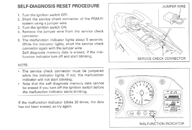

Member Contributer Terry Posted January 20, 2018 Member Contributer Posted January 20, 2018 If you have turned on the ignition before reconnecting all the sensors, that will register as multiple faults in the FI system. It would pay to clear the fault register and restart the bike, then you will only see the current faults. Quote
SlimWhitey Posted January 20, 2018 Author Posted January 20, 2018 How do I clear the faults? Tried the age old 'disconnect the battery and tough the cables together to drain the system power", but it didn't work. Quote
Member Contributer Vee-Ef-Ar Posted January 20, 2018 Member Contributer Posted January 20, 2018 Last time I did a valve sync I used a 4 gauge instrument with each vac hose having a small plastic screw valve to eliminate that "bounce". For a 98-99 it's a fairly straight-forward procedure. Someone with a 00-01 could tell you more about doing this with the "wax unit". To clear the codes: Quote
SlimWhitey Posted January 20, 2018 Author Posted January 20, 2018 My synch tool has the adapters, my single gauge pod does not. Good point. I'll clear the codes and start over. Thank you! Dammit if I can rebuild an nv4500 and decide to swap the entire front end in my truck on a whim I can get a motorcycle to run. Quote
