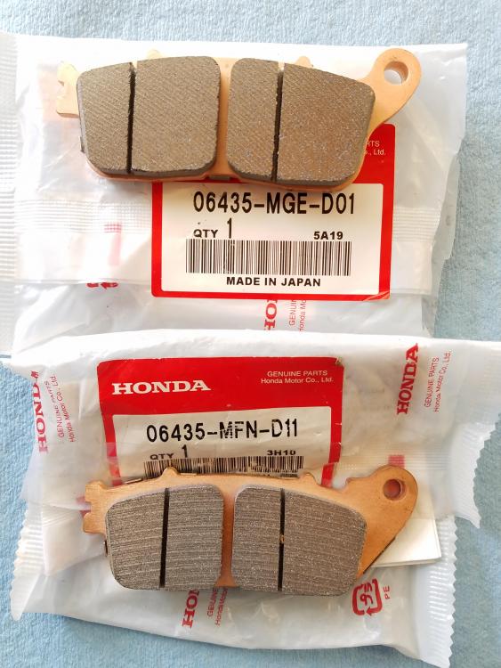

I knew of the minor weight difference (25 lbs, 10kg) between the 1200 DCT and F models, but never realized that was enough difference for Honda to address it in the brake design.  I mean, at 600 lbs, with luggage options and the like, a variety of rider weights, etc., is 25 lbs enough to make different size rear brake pads? Apparently it is.
I need to replace the rear pads, and decided to stay OEM because I love the brakes on this bike.  Why fix it with aftermarket?  So, I trundled into the local dealer to get parts, gave the parts guy the make/model info and he ordered them.  The following weekend I fitted them, or tried.  Damn pads just would not go on.  After some swearing and the like, I gave up and trundled back to the dealer to explore why.  The parts guy checked the numbers on the DCT fiche, then checked the numbers on the F fiche.  The PN's appeared both places, but he then noticed a second PN on both fiches.  Eventually, he figured out the two models had different PN's for their rear pads!  Who knew? Funny, the fiches didn't really specify which belonged with which model.  So, I ordered the other PN and figured between the two I'd have what I need.

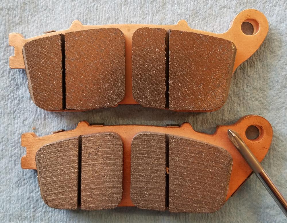

The parts showed up a few days later, and sure enough, they are different.  I was surprised to see the pads are smaller on the F model.  I also noticed the reason the F model won't fit into the DCT caliper - it has a small flange that won't allow it into the DCT caliper.  Trust me, it is effective.  Below is photographic evidence.
The MGE-D01 (top) is the DCT model pad, the MFN-D11 is the F model.  The screw driver tip points to the flange on the F model pad that denies use on the DCT.  You can see the DCT pads are bigger.  Apologies to those that already knew this, but it was news to me and the Honda parts guy.  Wonder if it is the same on aftermarket pads?

It appears the disks are the same for all model years, at least in the US and per the on-line parts fiches I just reviewed.  I guess one should never underestimate Honda Engineering's attention to detail.  Even if it might appear unnecessary.  Would love to chat with them as to their reasoning.  I'll keep this in mind if I ever buy aftermarket pads.
There is a different layout between standard and DCT version.
Standard has the brake caliper on bottom side, the DCT on top side.
It means that brake caliper are different, then pad could be different.

Yeah, thought this was more because they had to move it to accommodate the parking brake caliper on the rotor.  Didn't occur to me they would design a different caliper and add surface area to the pads.  Question is why?

Those pads are for the 1200X model I believe.  They may work just fine in the 1200F.   Wonder what the actual differences are, if any.  Maybe they're the same physical part, but assigned a different PN for each model to satiate their ERP system.
The difference WILL be due to the DCT having the additional parking brake and hence a different caliper in a different location for the normal brake. Possibly it's a caliper design they already had so could be used with no, or minor modification. The fact the pads are slightly different would be irrelevant. As you say, no need for it to be different. In fact, I would have thought they could have just added the parking brake in the other location and kept the main caliper the same and in the same location on the F and the DCT, but nowadays it seems they tend to change things for no good reason.
