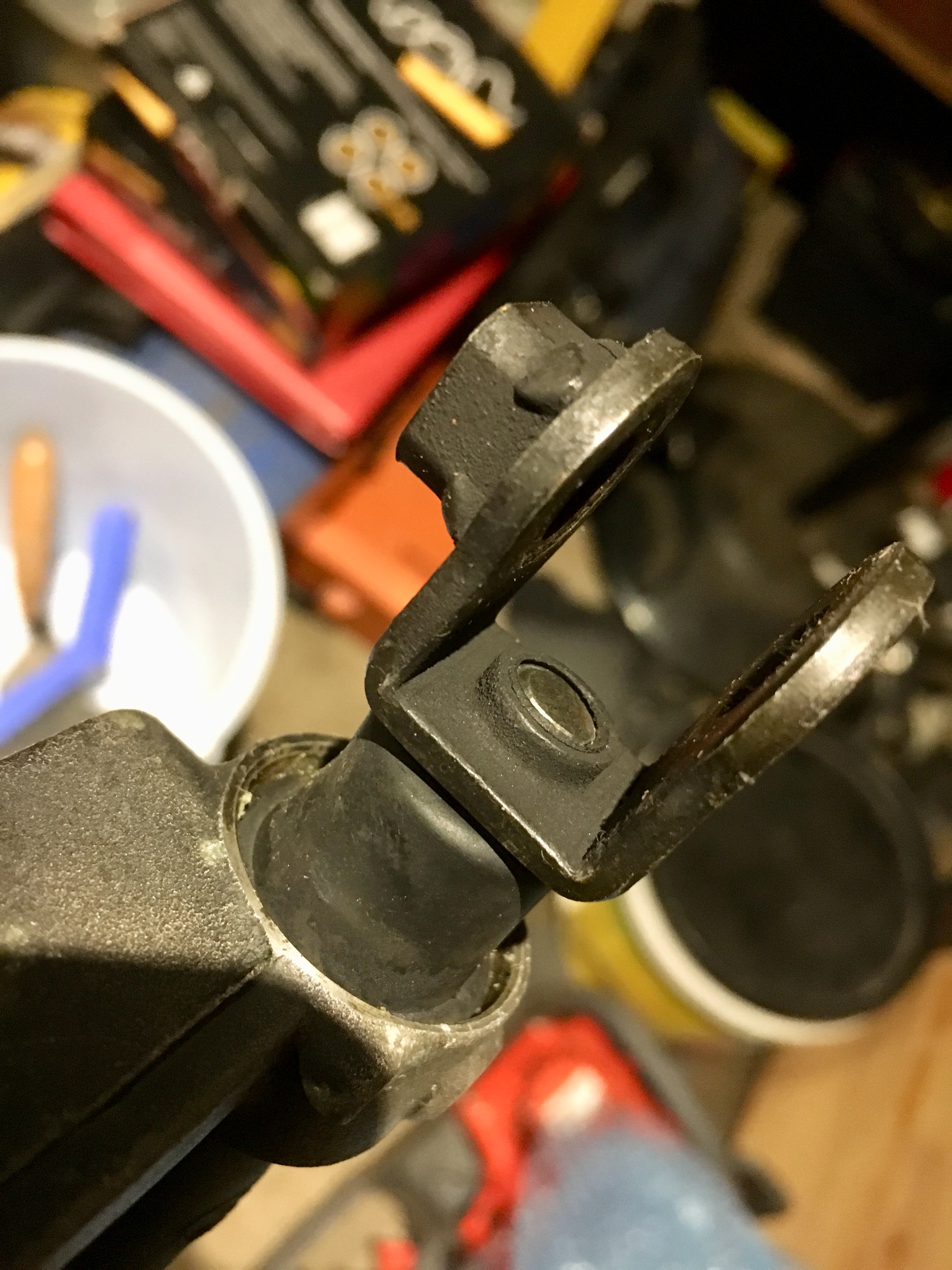

It feels as if the only thing we have not done is check the installed length of the Secondary Master Cyl pushrod.
There are two mentions of the secondary master cylinder pushrod in the manual.
But no dimensions.
Is the secondary master cylinder pivot (bottom mount) free to move?
Or is the front left caliper dragging?
Is the secondary master spring ok?
Does the pushrod go in straight to the master?
I'm running out of ideas.
No sure which manual you are using, I could not find any reference to push rod length.
Sorry, I did find it.
I can measure my old one I pulled out when I delinked.
It is flush with the bracket
