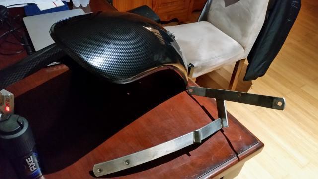

Here is a pic provided by the seller.
I'd hazard a guess and say that you need to drill 2 holes in the existing chain guard.
That the carbon fibre's horizontal bit (that will go on top op your chain guard (with the metal strip in between) already has 2 holes drilled.
as I said, make sure the bolts sticking trough (top down) are long enough to grip the nut+washer underneath
The curved metal strip will fit underneath the cf curved bit.
Here my home made version from a messed up cf hugger with a metal chainguard...
Or contact the seller!! :goofy:

The flat part goes between the rubber chain guide and the swing arm underneath the swingarm the tab sits on top of the swingarm in front of the rear wheel and the curved part attaches to the hugger. You will have to pay with the curved part to get the hugger to sit right

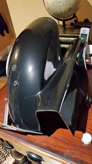

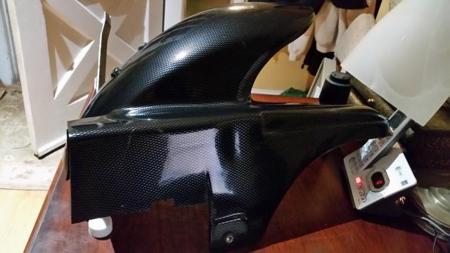

I think I should have included these other pics...sorry about that.
Thanks for the detailed description. I can picture it in my mind.
Do you happen to know if I can expect to be able to still use the existing bolts on the bottom of the swing arm? Or might they be too short?
I am the seller. Just pm'd you with some install info.the top bolts should be only long enough to use the threads in the bracket. Not stick out at all. Pan head and washer type. I think i would use some silicone glue to seal around the base of the hugger to the swing arm. Its a pretty light weight plastic and not carbon fiber. There may be a better modification for mounting it if you do a search.

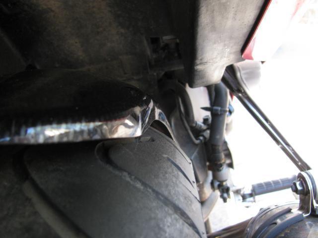

I mounted my hugger today & noticed that it does not cover the full width of the tire on the right side except close to the swingarm. Is that the way it's supposed to be?
Here's a pic.

Mine covers the full width of my rear... Sorry I couldn't find the instructions - the missus musta turfed them in a cleaning fit. Is the bracket straight?
I don't have another to compare it to but I believe it is the shape it is suppose to be. The 4 holes line up & it seems to hook onto the swingarm properly. But it does seem odd to me that it doesn't cover the full width of the tire.
Here's a pic.
Could someone please tell me if this is ok or not?
