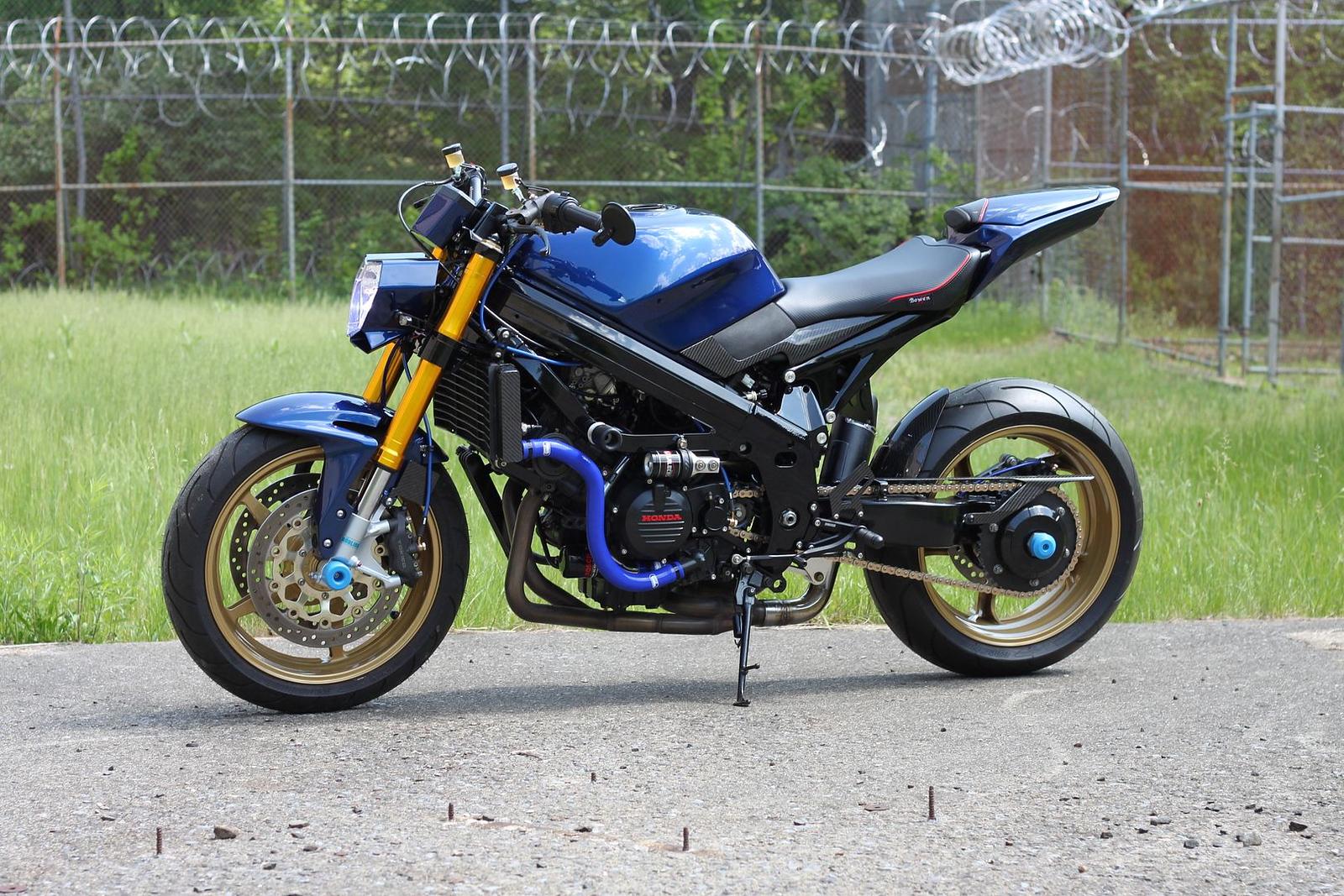

Sweeper Posted April 23 Share Posted April 23 Very few bikes look cool without some cash and talent. More cash requires less talent while more talent requires less cash. Seb's naked bikes look like MONEY but we know how they got there. 5 Quote Link to comment Share on other sites More sharing options...
