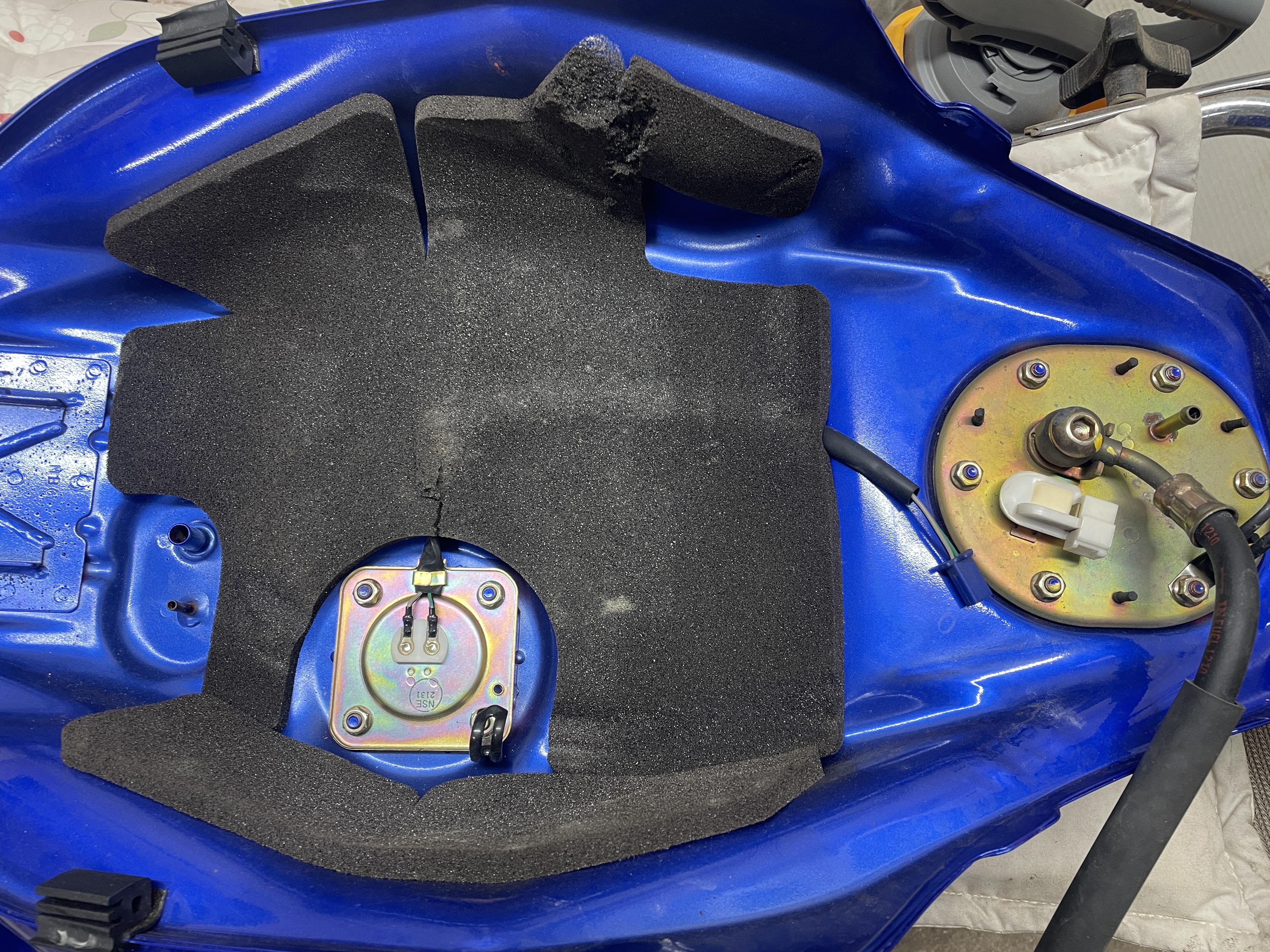

Final stage completed today I took my time slowly rotating the tank to make sure it got completely coated. That took over an hour.
I will leave it for a week to cure. The new gaskets came during the week too.

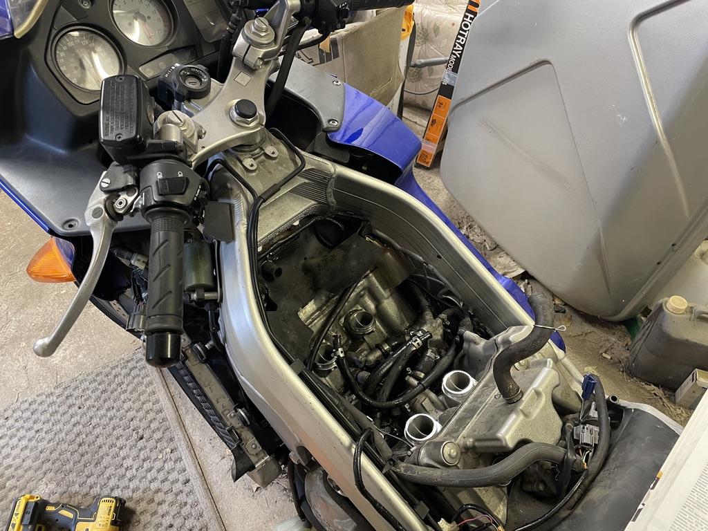

Wow, I have a 2001 model with EXACTLY the same symptoms. It had been left standing in my garage for a couple of years without running while I had been working abroad and I made the mistake of riding it without changing the fuel. It was fine for the first ride to the MOT station for an annual inspection but now does the same thing you describe. Runs okay when cold, but as soon as the temperatutre gauge hits 65 degrees C, the engine dies and won't stay running without blipping the throttle constantly. Even raising the idle speed with the adjustment screw doesn't solve the issue. Initially I suspected the fast idle wax unit, but I've taken it out of the bike, opened it and tested it and the little part inside does expand by a few mm when I drop it into a mag of boiling water. So I now think that part if fine and I'm going to move on to checking my tank and injectors...
Checked the tank using my borescope and while I can see tiny bits of rust, it's very clean on the whole for nearly 25-year-old bike and I'm not worried about it. I did try to remove the fuel pump to check the filter, but I couldn't get it through the opening as it looked like I was going to break some plastic part. But because the tank looks so clean, I don't think it's the problem. The pump has no problem sending fuel out of the fuel line at the rate given in my Haynes manual for the bike.

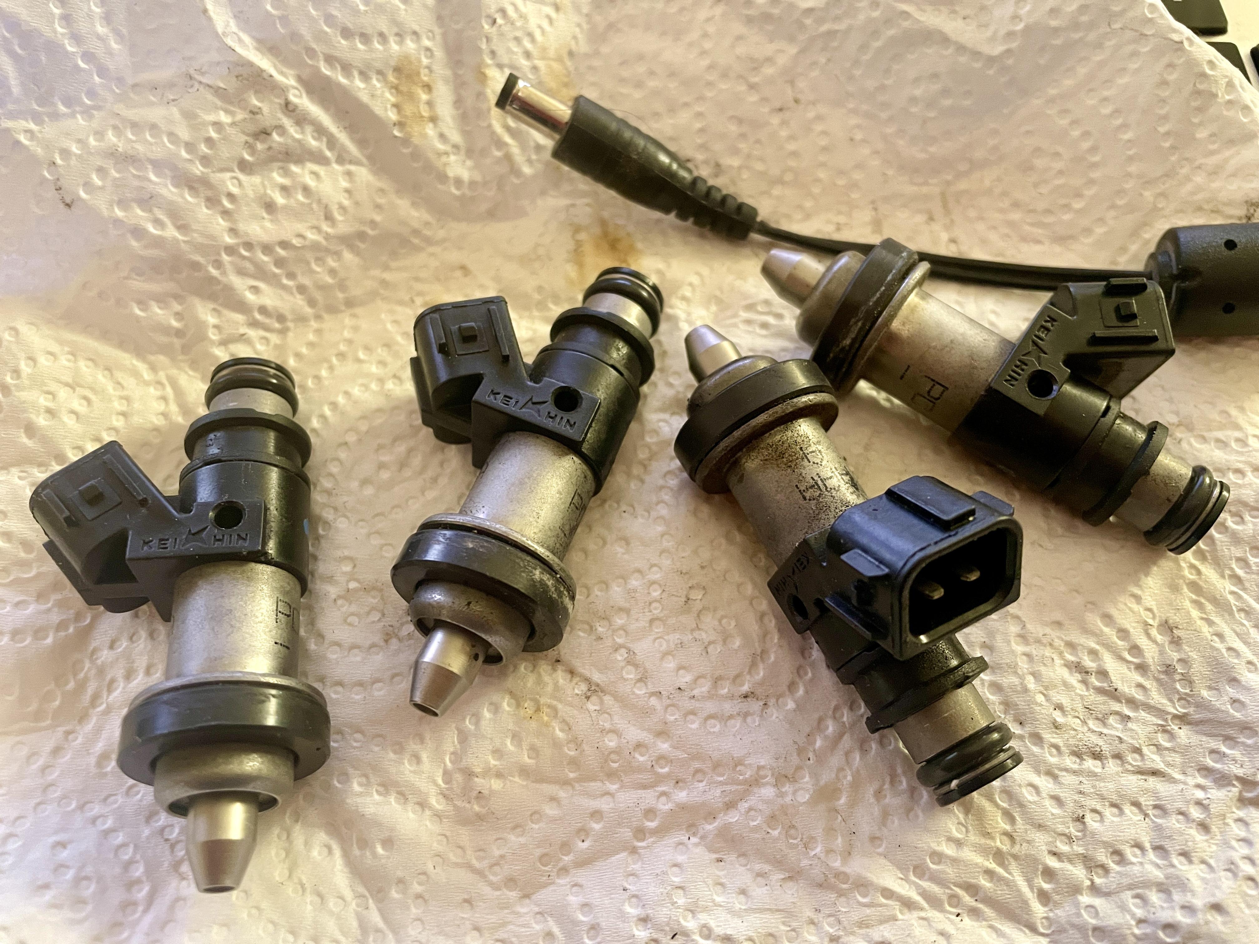

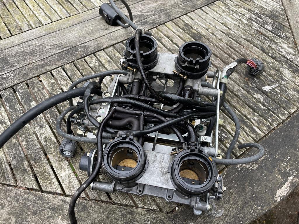

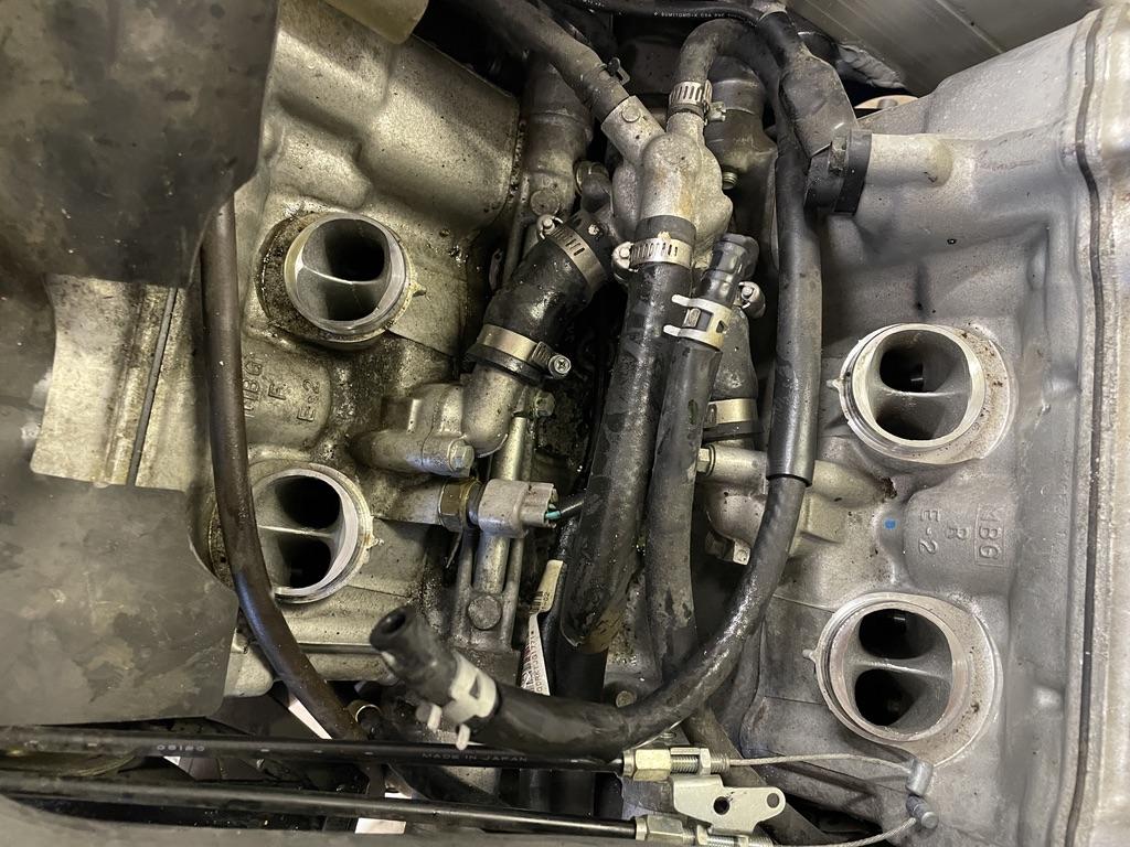

I've also removed the throttle bodies to get access to the injectors, and have removed them. Using a 12V computer hard drive PSU with a barrel plug, I've tested each injector for basic functionality. The centre section of the barrel slips over opne of thre injector connector pins, and then the outer jacket is very close to the other injector connector pin.I then used a paperclip to short the outside of the barrel plug to the other pin, and doing so each injector clicked very clearly. That doesn't test whether the injectors are blocked, so I've ordered an injector tester that contains adapters so that I can spray injector cleaner or brake cleaner through each one and check the nozzle pattern. The good rainforest people are hopefully delivering it to me tomorrow.
