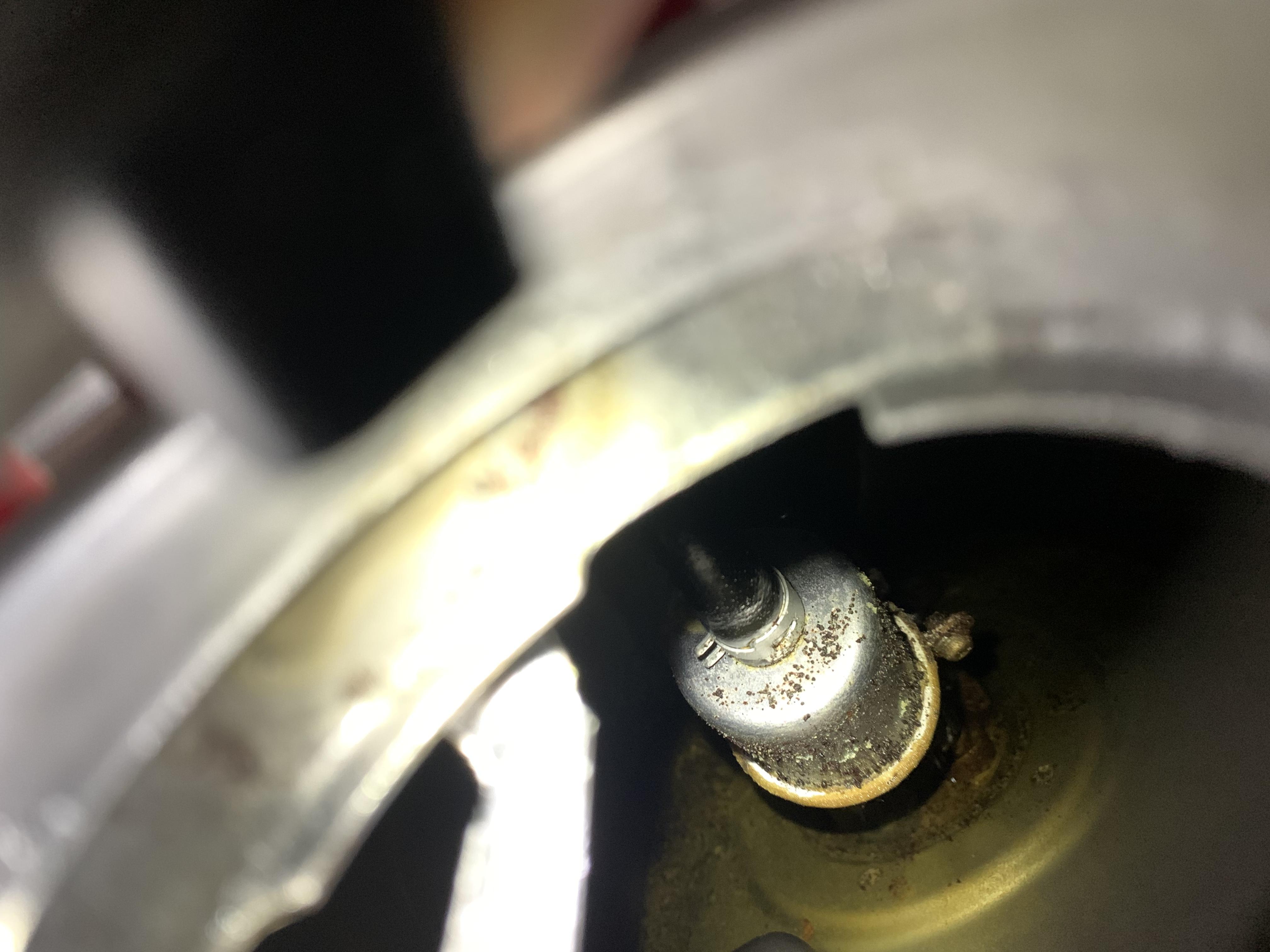

Here's a photo looking into the tank.

There certainly appears to be a lot of crud around the fuel filter in your photo!

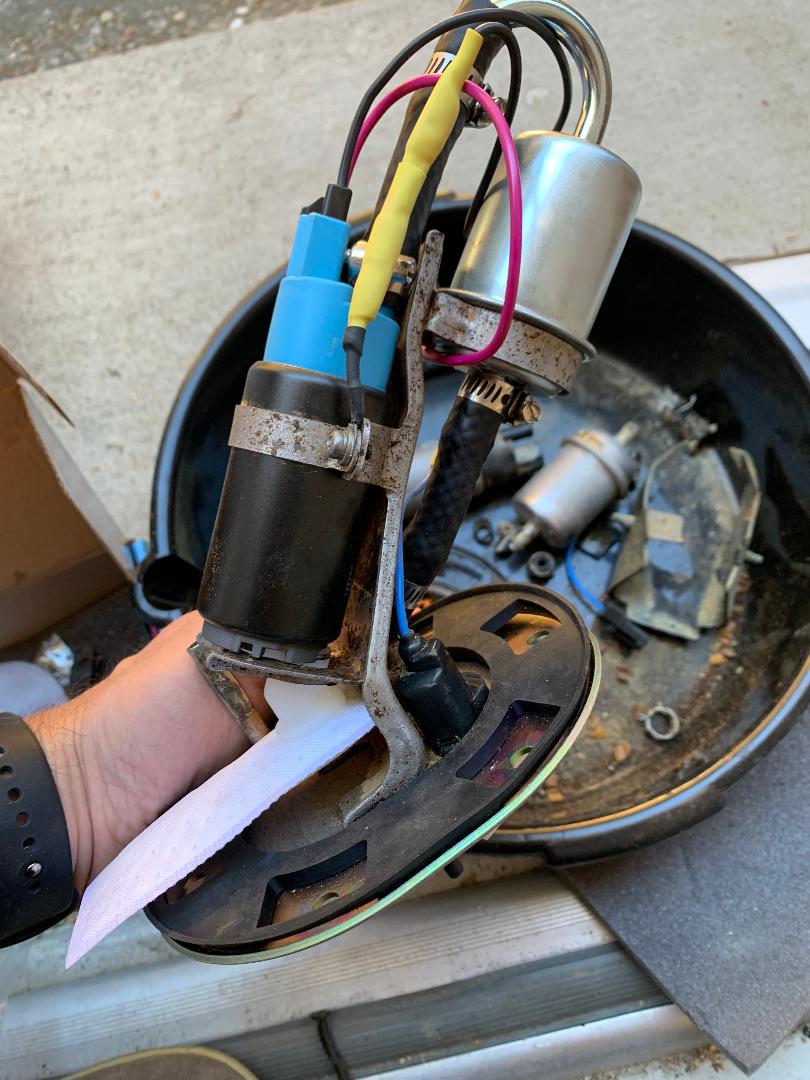

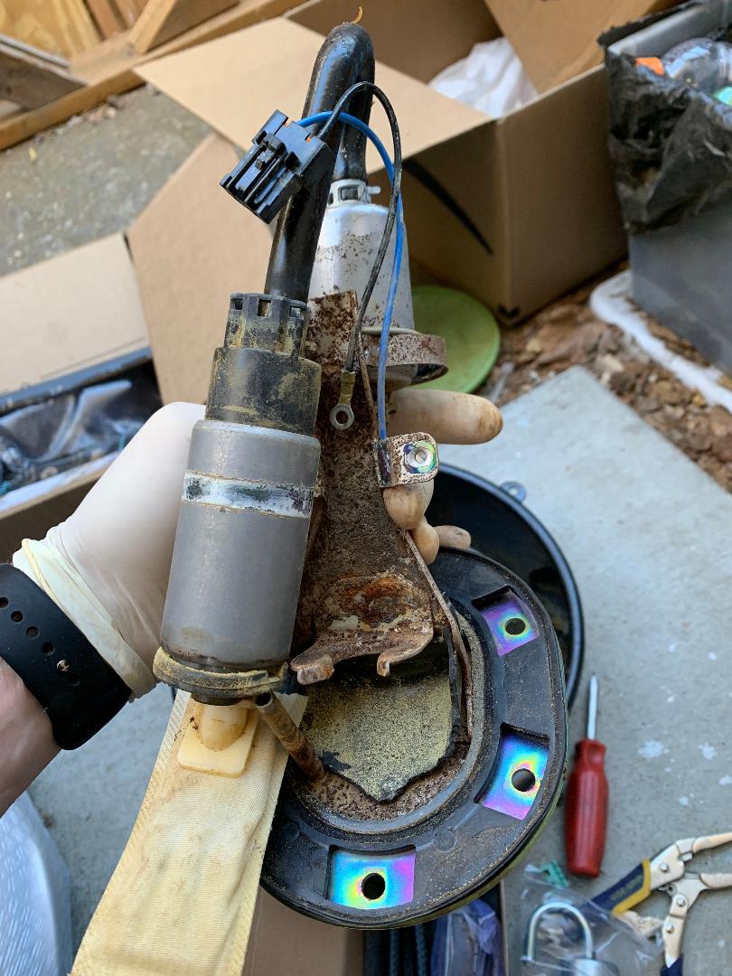

Anyway, below are old pump and new pump photos.
I am having trouble with the pump/tank seal. I've tried less torque, more torque, swapped for the old seal (it was in great condition), and just tried some Permatex PermaShield fuel resistant gasket dressing on the gasket... it still has a small leak so I'm letting it dry more before trying to tip the tank over again. (I let it set for ~45min before trying it... too short?)
Anybody have experience getting this seal to, well, seal? :) When I turn the tank over to remount it, it starts dripping fuel.
