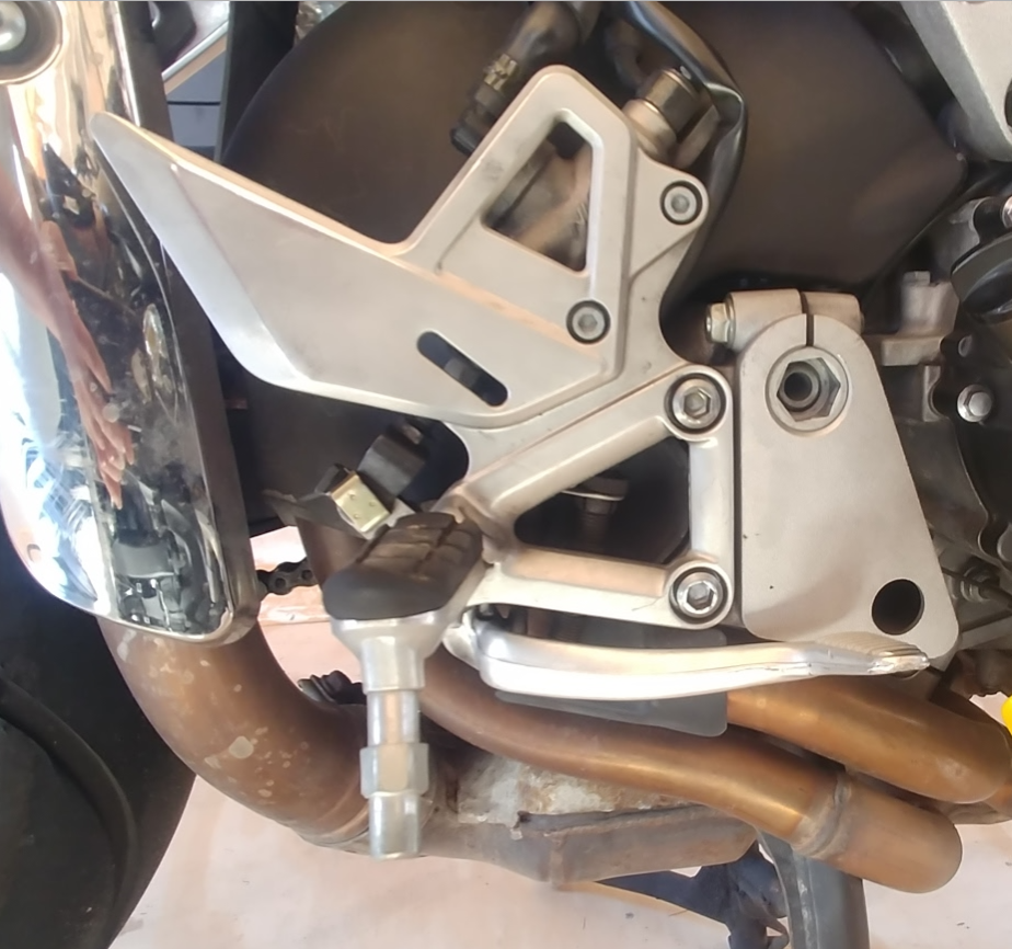

My brake pedal needs to be adjusted down more. I know how to adjust it (and yes I have!) but the problem I am running into is that I can't get it adjusted down any more than it already is.
A few pics:
Where it currently sits:
The tiny gap left for adjustment (Actually it is needed so it doesn't interfere with it's movement😞image.png.93376ba5e727ffd9392221f86f3d4991.png

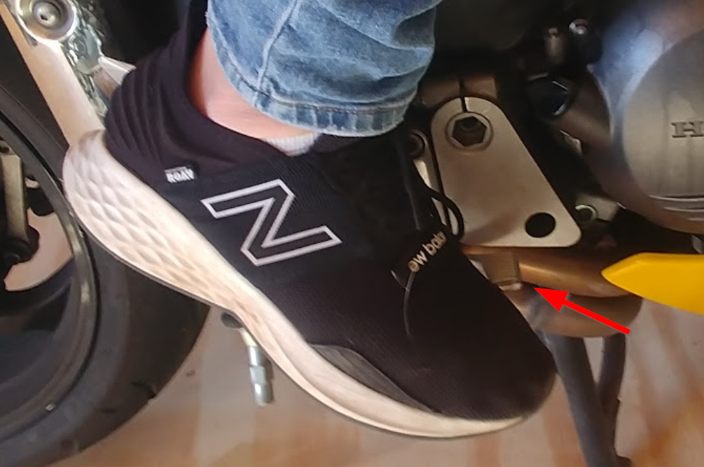

How my foot sits in comparison to where I want it:
The last pic makes it look really bad so you'll have to take it with a grain of salt. Unfortunately taking foot position selfies was harder than I thought it was going to be.  The pedal is about an inch too high for me is what it comes down to.
My question is, can I cut the threaded rod where it connected to the pedal (At the back) to allow for more travel on the pedal or am I opening pandora's box that is just going to end up with me replacing parts? I realize I might have to do something with the spring for the brake light switch, but is there anything else I should be on the lookout for?
And one other thing I just noticed when I compared my photo to another VFR photo... Does that pedal look bent?

Its bent alright. Have a go at straightening it, or just replace it with a newy.
Well it looks like I have my answer. After comparing against several photos I can see my foot lever is bent. I pulled it off and took a few whacks at it with a hand sledge (If is breaks it breaks, it's going to get replaced anyway) but it didn't budge.
I slowly dropped the bike not long after I got it. I wasn't even moving, just lost my balance. That was likely when it happened and I just didn't realize it because I hadn't set the bike up yet.
That or the PO did it which is also a possibility.
