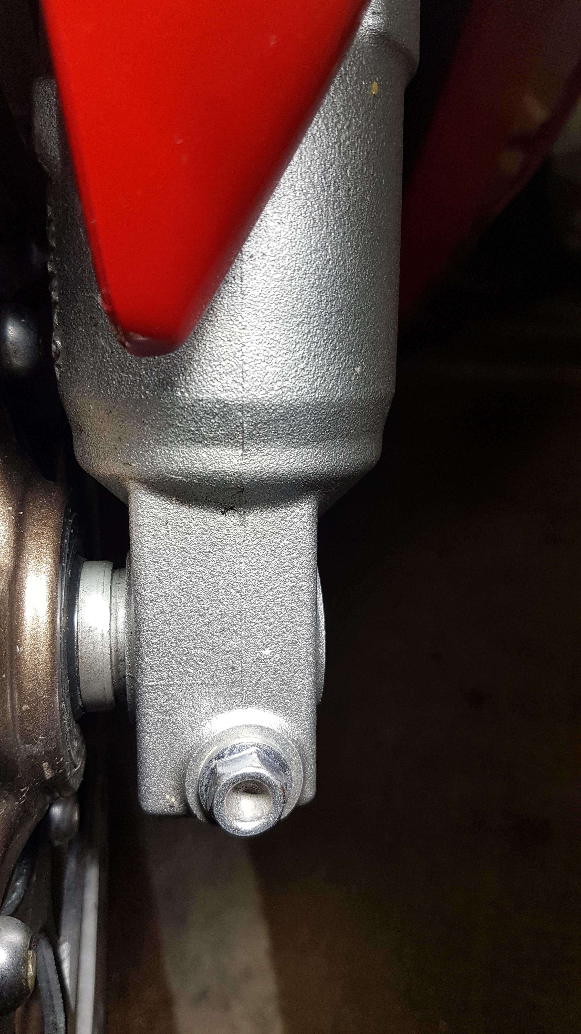

Just had tires changed by a local shop on my 8th gen. Noticed the left side spacer on the front has a small gap between it and the fork leg while the right side doesn't. Is this normal and acceptable? Did the re-alignment drill, but it had no effect on the gap.

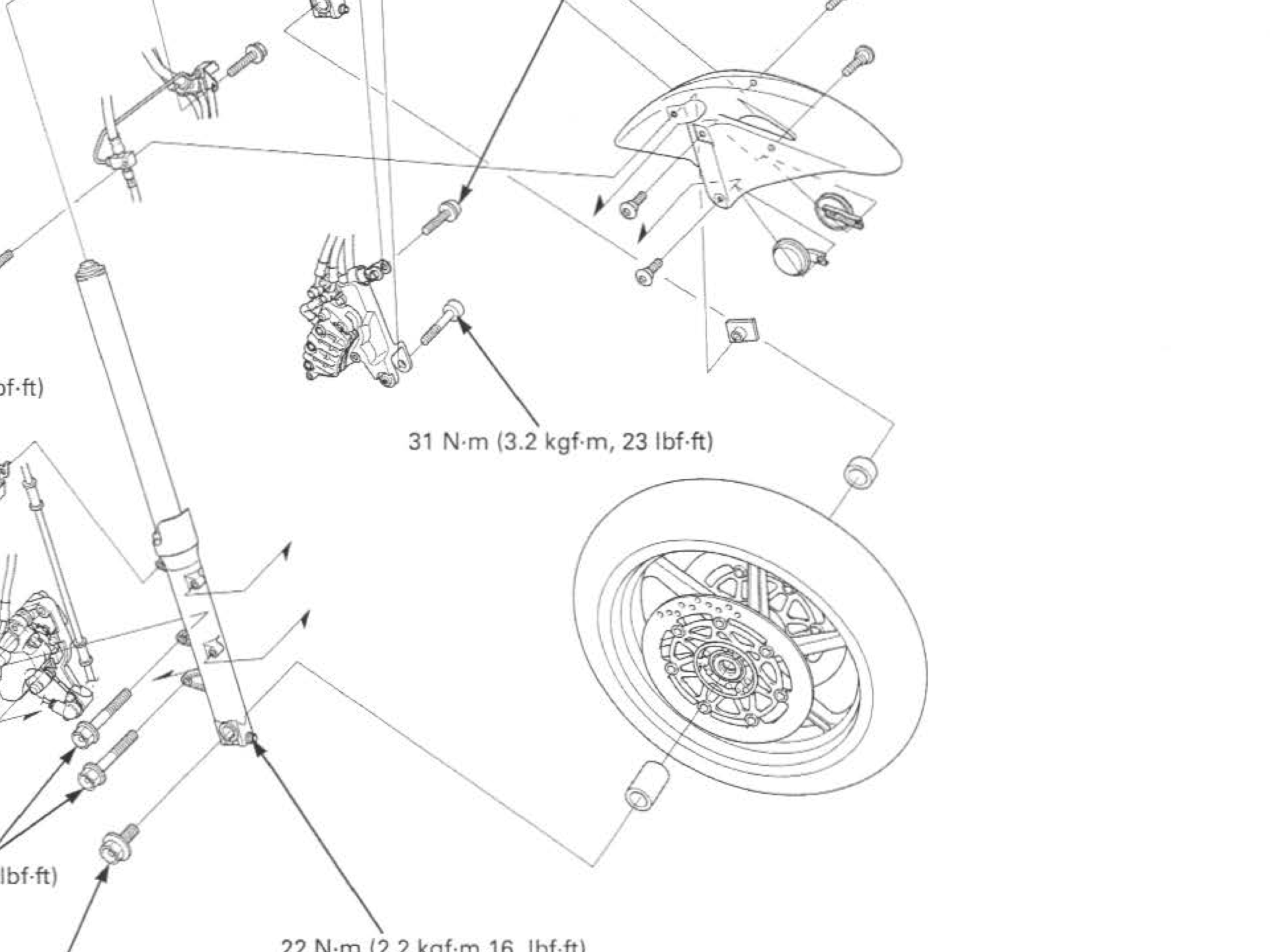

I'll pile onto this...anyone have photos confirming which spacer goes on which side, and which way for 6th and 8th gen?  Manual and parts photos aren't super clear, gonna go re-install my front fender today and want to confirm.

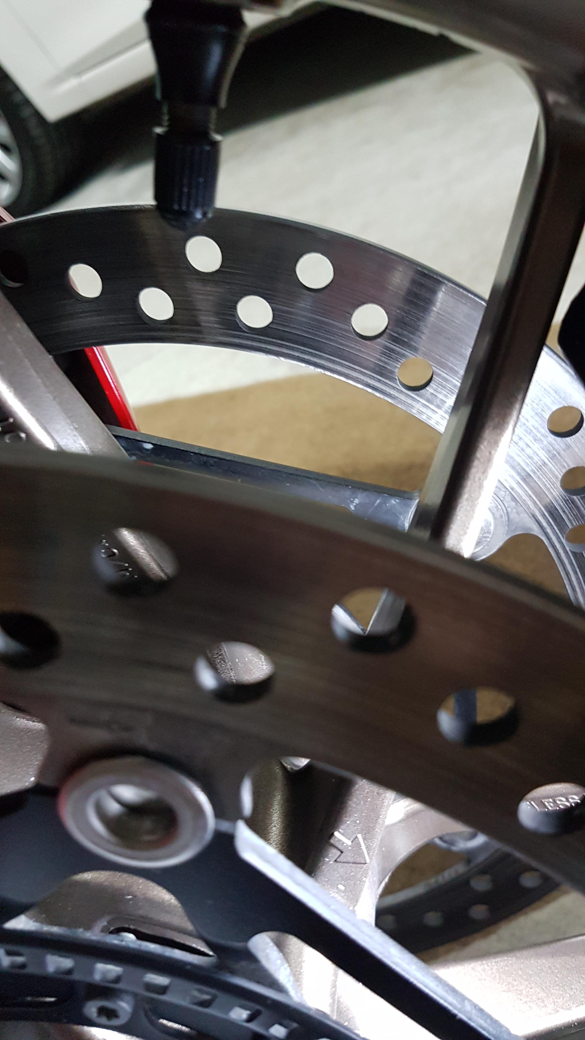

Check that they have fitted tire and wheel for correct Direction Of Rotation. See picture. On the right side of the wheel on the first spoke forward of the valve stem and looking down through the disc rotor there is an arrow, this arrow must match the DOR arrow of the tire. You may have a tire that is installed the wrong DOR, its happened before.
See also left side spacer.
6gen spacers are Long to the Right, Short to the Left.
Grum is right again. Checked parts fiches, the 8th gen uses identical spacers left and right, got confused by 6th gen. Checked direction of wheel and tire, both are correct. Re-did everything, axle, torquing, bouncing forks, still the same space on left. When I blow up photo from Grum and compare it to mine, the gap is almost identical, so I'll have to say all is well!
Thanks again!  And orientation does not matter, right?
