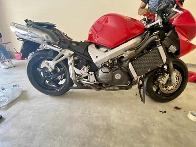

I'm guessing your bike has been lowered, judging by the handlebar locations on the fork tubes.  Which would mean the rear was probably lowered, too.  I don't know if that's a good or bad thing for you, but even if you don't need it that low, this being your first bike you might be more comfortable flat-footing it at stops for now.  You can always raise it back up for more cornering clearance later if so desired.

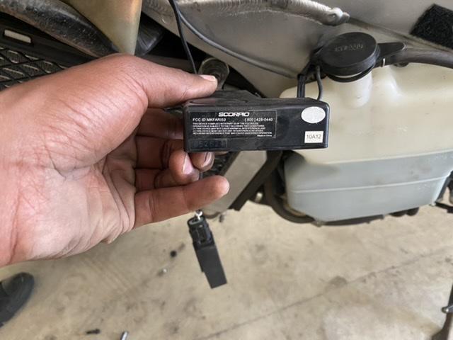

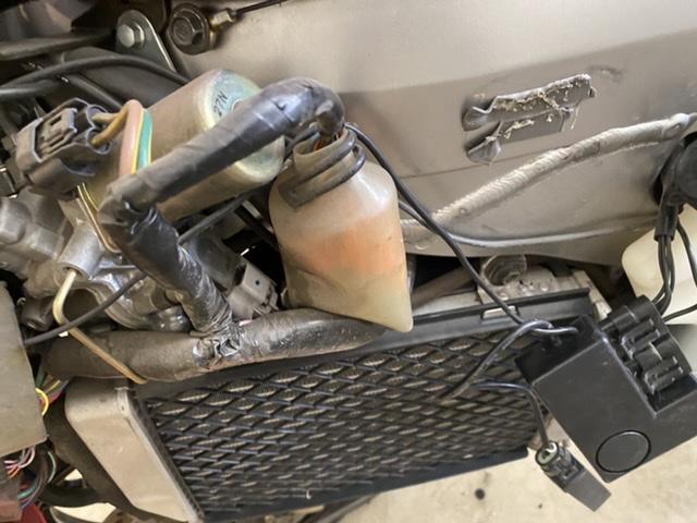

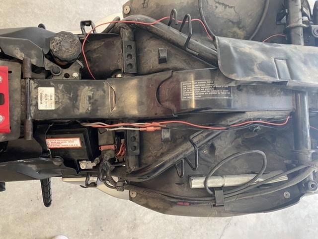

Thanks everyone for the welcome. Bike has been riding well up till this past week. She cuts out on me couple times during a riding session. We dialed up the RPM's up to 1200 but she falls back to under 1000 and shuts off. Couple things bothered me on what was wrong, injectors, fuel pump, air filter and the main thing I'm thinking is the battery. I but some BJ44K in the tank (two small cap full) and my goodness did it ever blow out fumes. Right amount went in on a full tank, so I was wondering if they were that bad. After two full tanks the smell and smoke has went away. She still cuts out, so I'm going to swap out the battery to see if thats the problem. The way the previous owner had things wired up (USB power cable and alarm..I just didn't like how he did it). I post a picture shortly. Oil seems fine, but I m going to swap out the K/N filter it has on there with the OEM and some Motul oil to know its been changed myself. Air filter as well, but I can't seem to locate an OEM air filter. Plugs since the tank will be off as well. Hopefully these things will get me through for awhile, then I'll send it in to the shop for a complete over haul to get service records going on it.

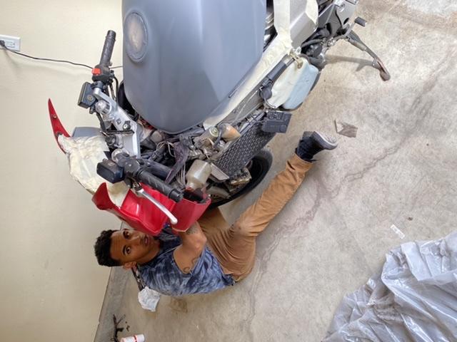

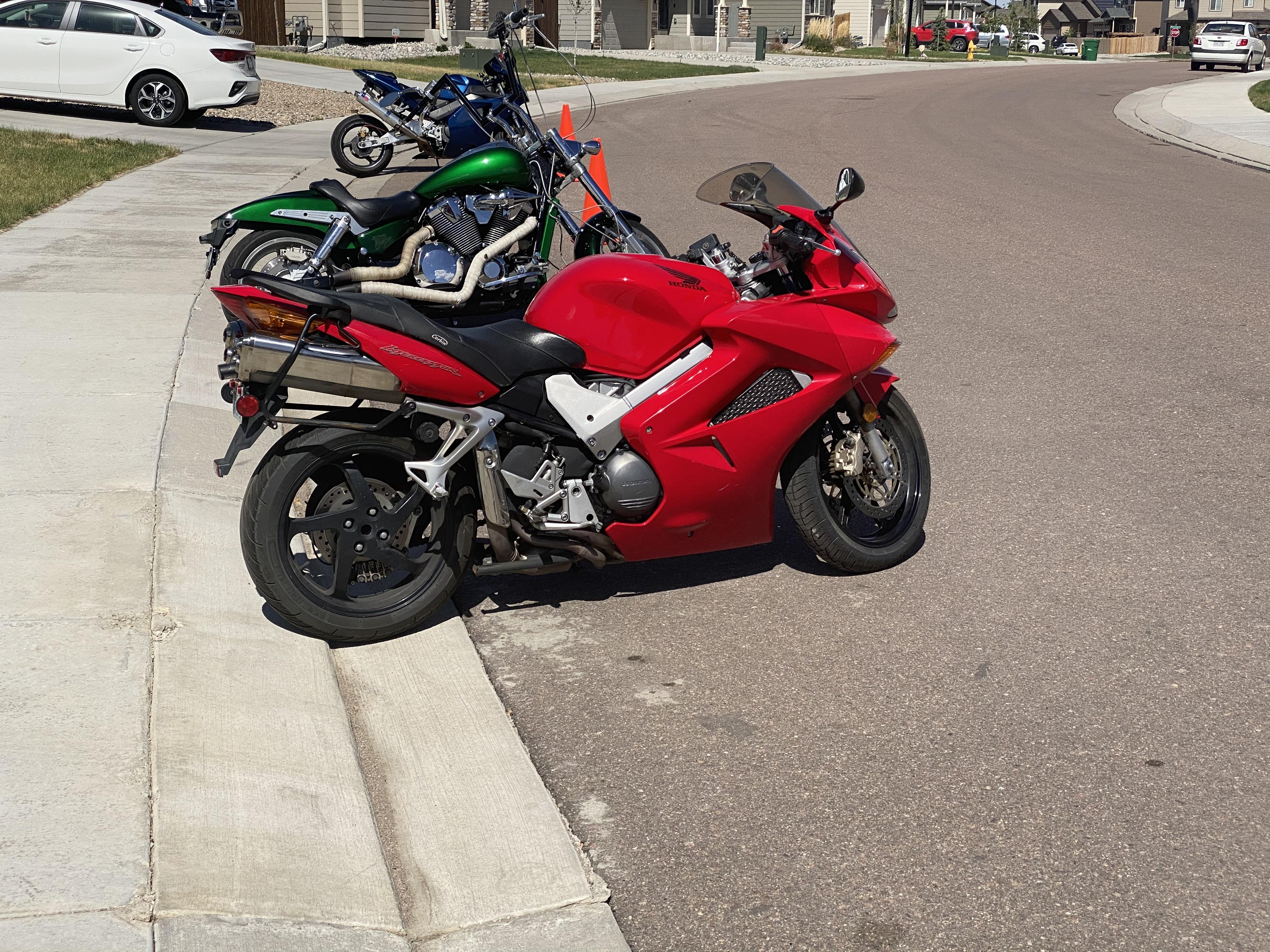

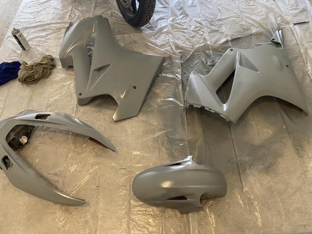

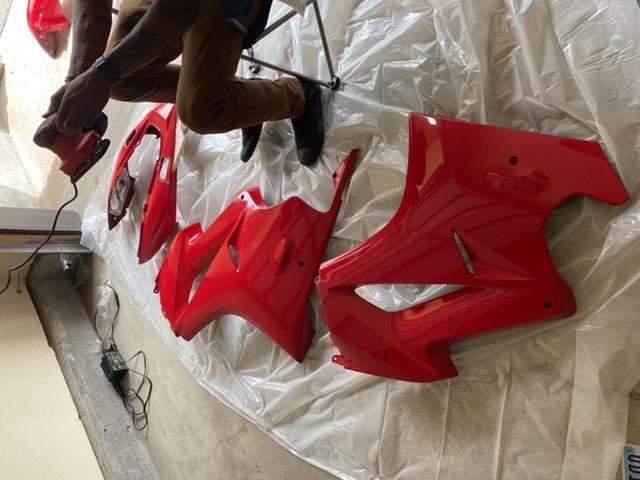

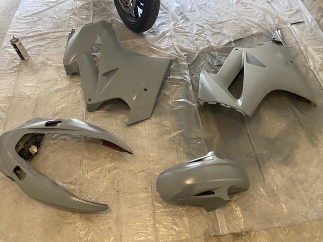

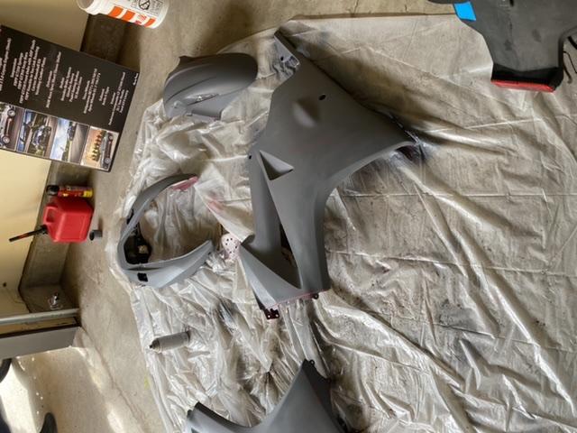

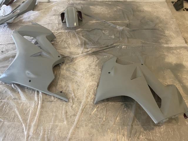

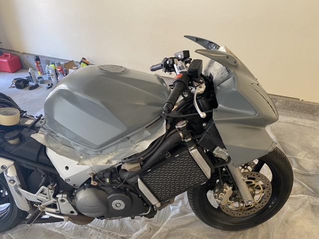

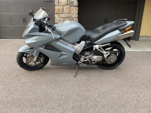

I also wet sanded and painted the bike, which I think looks awesome. Bike decals coming too. Thank you everyone for the tips in getting her running right!

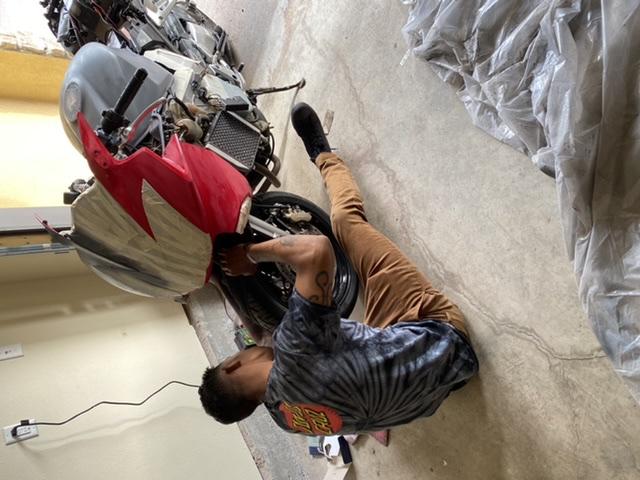

Did a little make over on her over last weekend. Last one is a video of it cutting off. You can see in one of the photos the wiring job 🤢. Last photo is how it cuts off on me. Hope to have everything good to go by the weekend.
