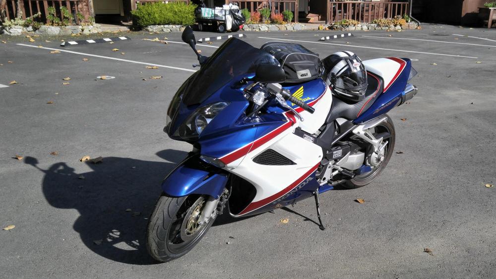

First of all I'd like to introduce myself and my new (to me) 2007 RWB VFR800 Vtec. I bought the bike with just 20k miles on it, it wasnt cared for as much as I would have liked, but was very clean and it was a RWB VFR after allo (hard to pass up). So I immediately changed the oil w/ Mobil 1 10/40 (motorcycle specific), oil filter and air filter, bought a new front 2CT to match the rear (almost new), right afterward I changed:
Chain and Sprockets (stock gearing)
Battery
and rear brake pads
and did the PAIR Valve mod and the Flapper Mod.
Right now as it sits the only other modification to the power plant was the Delkevic slip-ons that came on the bike, I also found:
a nice used Sargent seat
a slightly defective solo cowl (had to epoxy the rear tab on)
new grips and bar ends (to replace the disco ones on the bike)
Some used Gen Mar bar risers
I dropped the rear with the Triangle mod (@ 19mm)
Front down 13mm (forks raised) (I plan to drop them back to 10mm)
set static sag at 38mm (1.5") both front and back, a little soft, but OK for now.
There are other small parts I added/upgraded along the way, but recently I installed a (used) Power Commander V and AT-200 Auto Tune, set a base map, am running 330 ohm resistors as O2 eliminators and hooked the Flapper back up. So this brings me to my questions, now I must say that I went through all 47 pages in this forum. digesting every topic I could, as well went through 130 pages of the other forum threads for the 6th gen bikes, and I'll add that the bike runs much better, as I can cruise around at 4000 rpms without bucking (with the exception of 6th gear) and the VTEC transition is much smoother.

Do post a picture of your bike; to "prove" u exist! 😎
Welcome to the asylum apextech from The Land Of Interesting Weather. You obviously have fabulous taste in mc's.
Welcome to you. You jumped in with both feet! Well done.
