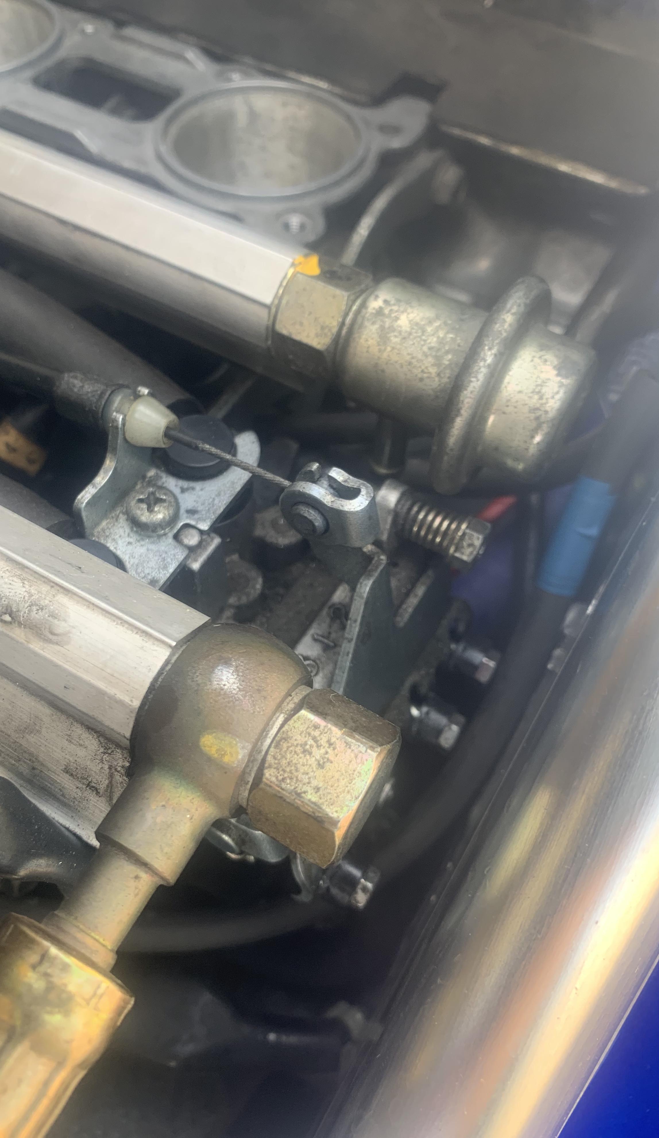

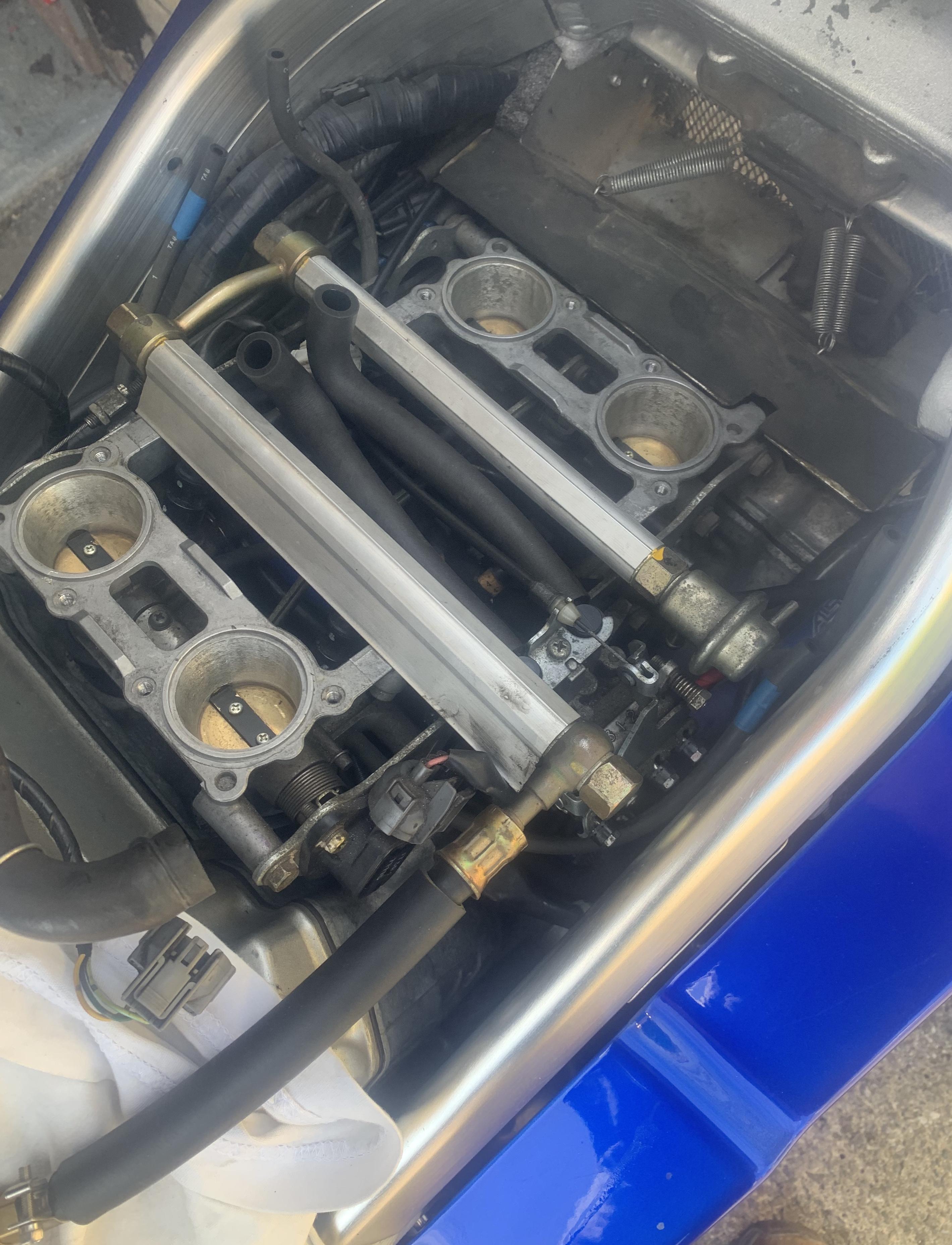

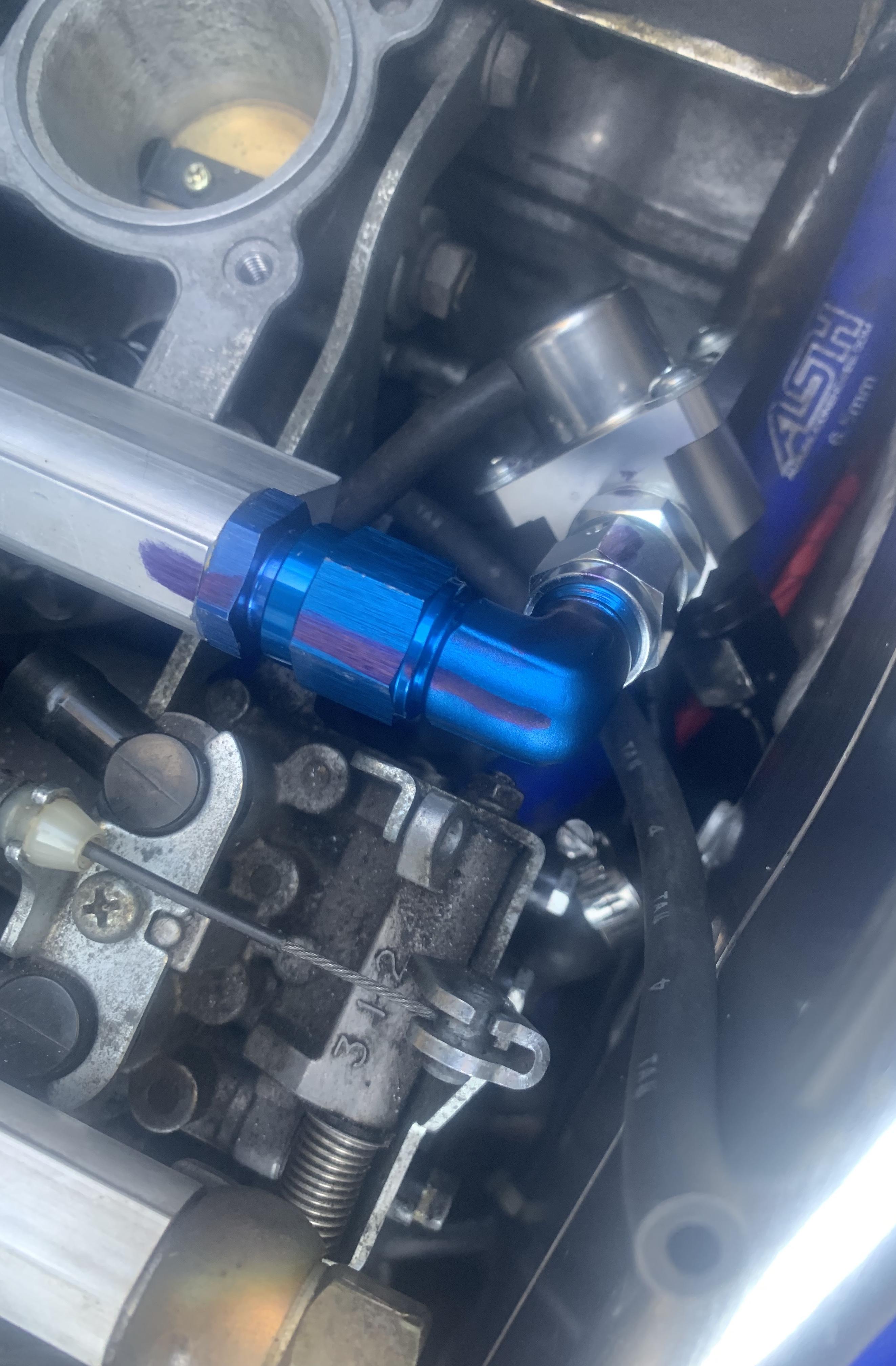

Member Contributer Mohawk Posted September 13, 2019 Author Member Contributer Posted September 13, 2019 I did order 3 of those, but all 3 were not delivered & cancelled by the sellers ! So after much searching I came across this small unit. "Saxon M/spt Silver CNC Machine Housing for Bosch Fuel Pressure Regulator Jenvey" on the bay. So with a few AN-6 adaptors & converters I was able to do this. Before After All sealed & adjusted & now 4bar pressure to suit the CBR929 4-hole injectors requirements. I've set the RBR to a zero fuel map & will do some miles & see how it adjusts. 1 Quote
