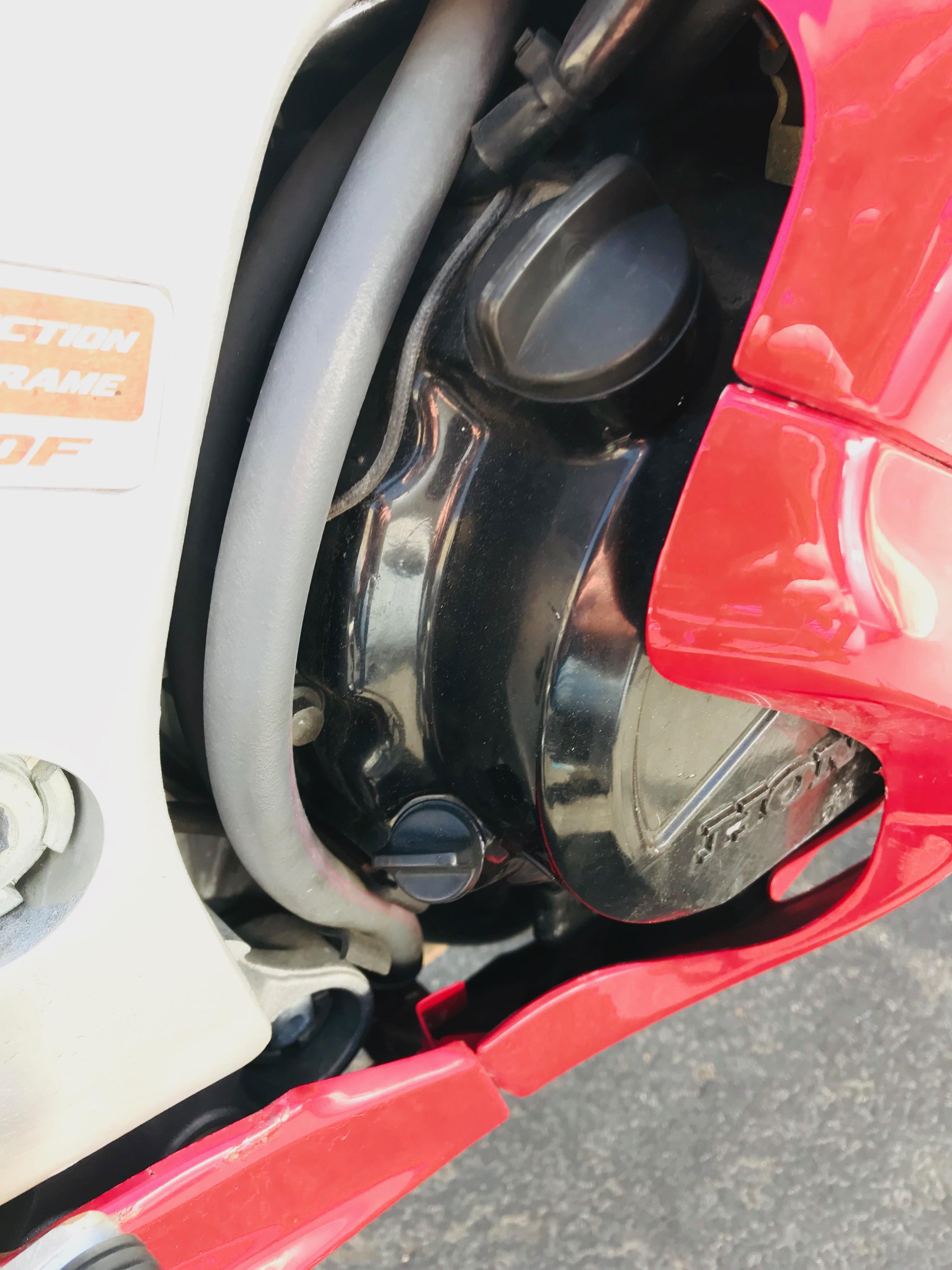

1991 VFR 750F. Couldn't find the parts in the manual & I'll bet most of you could tell me what these 2 caps are screwed onto. I'm eager to learn more about my VFR.

do u mean the 3 cap screws under the VFR sticker?
They affix to parts #19 and #20 in this fiche
https://www.bike-parts-honda.com/honda-motorcycle/750-MOTO/VFR/1993/VFR750FP/Frame/COWL-VFR750FL-FM-FN-FP-/13MT4L41/F__3200/2/10242
I assume that based on the last picture, you are asking about the Oil Filler Cap and the Oil Dipstick.
Exactly, thanks COS. I've been reading about Seafoam-type products being applied directly into the oil tank. I've waited to make sure that what I was looking at was actually oil caps. I'm happy to say the Seafoam and Berryman's B-12 have already proven their effectiveness even after 24hrs of the solvent being in the fuel lines, carbs, etc...
