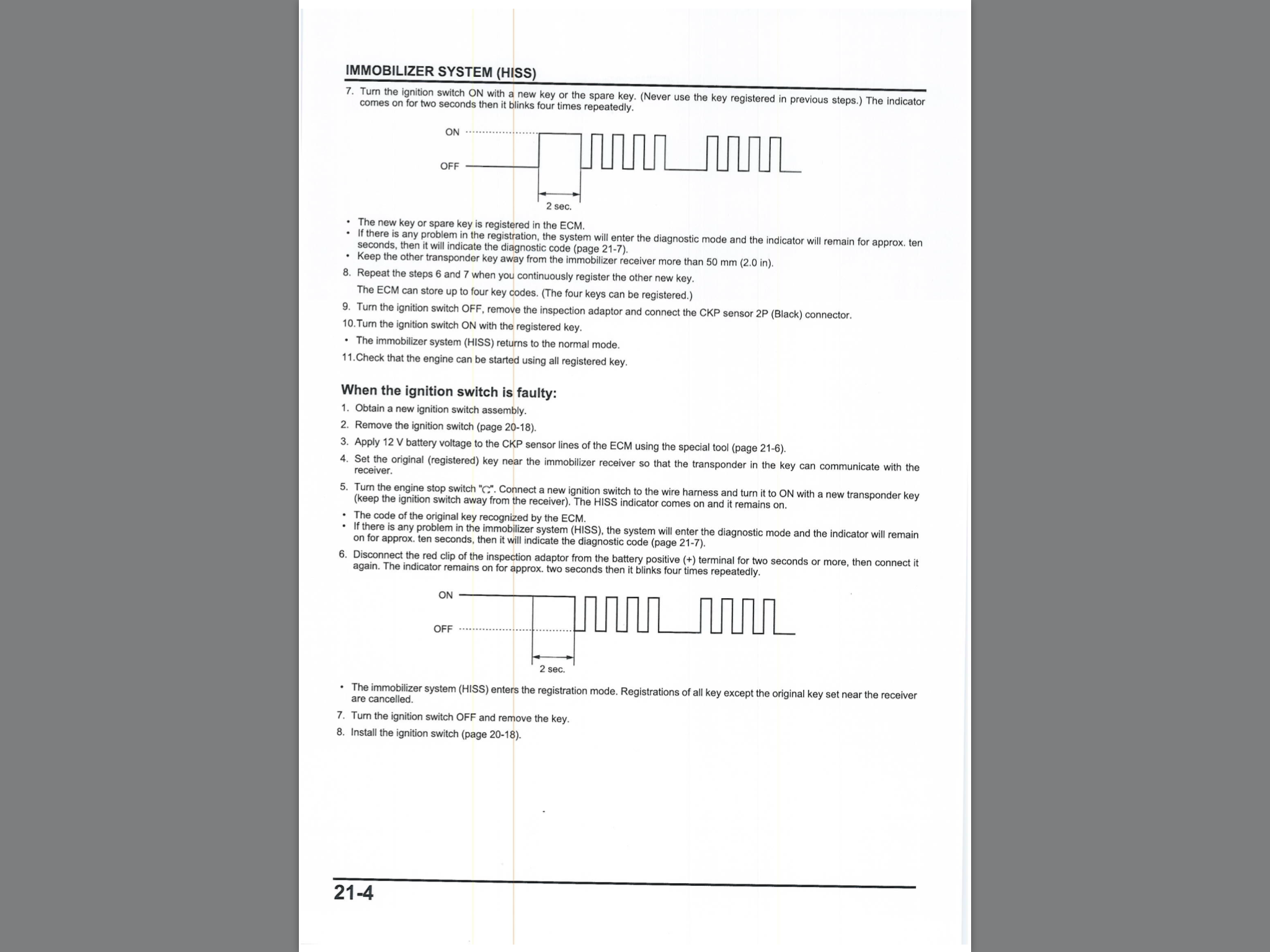

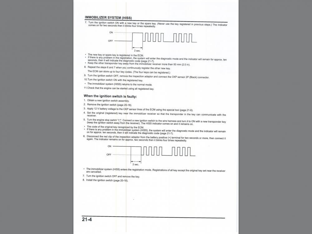

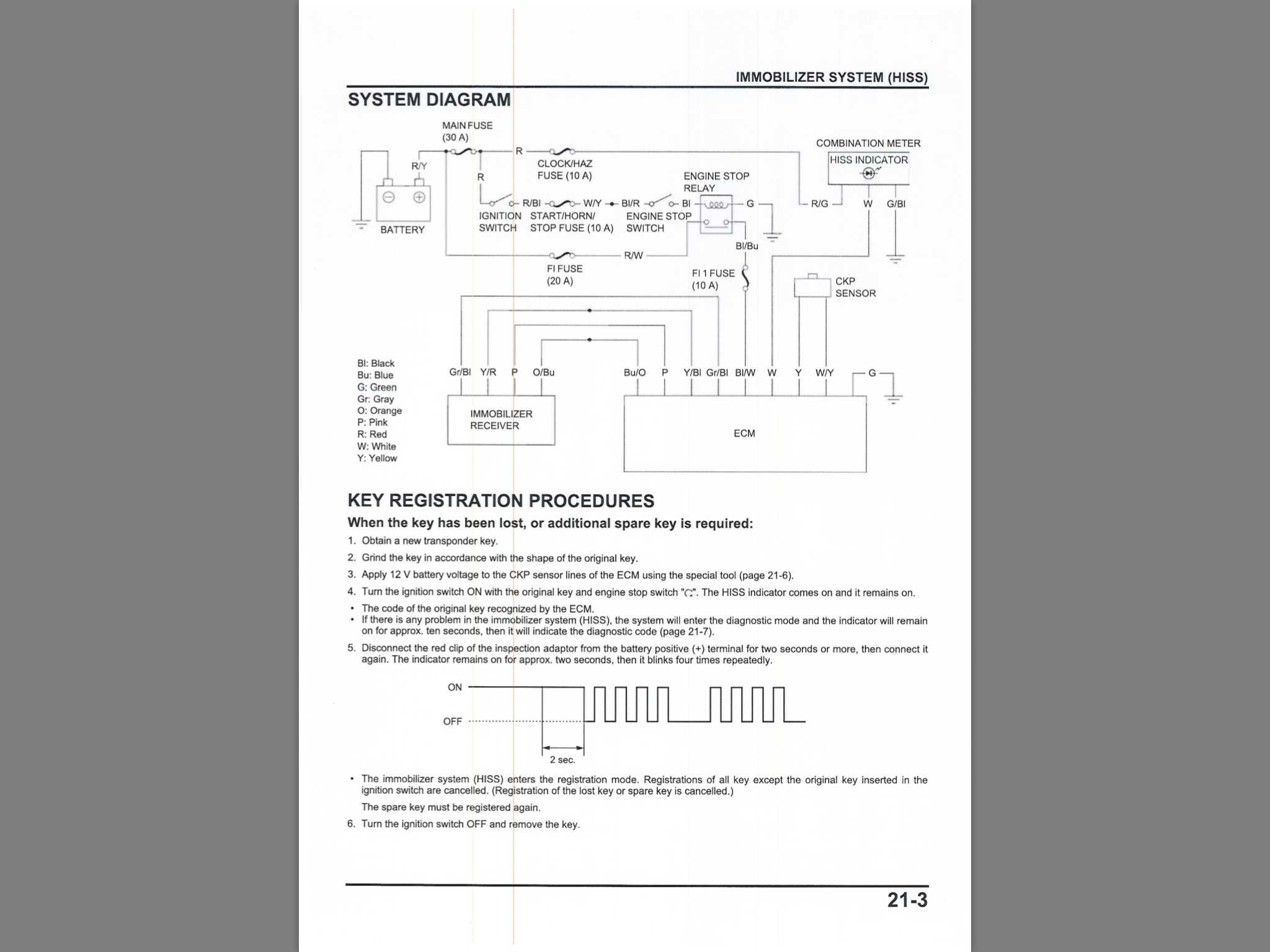

Also the key registering process is probably the same as the 8gen which is also the same as the 6gen. Attached is the 8gen procedure.
He just needs a correct blank, have Honda or a locksmith cut it to match the original, then have Honda or himself go through the registration process of key to the ECM.
