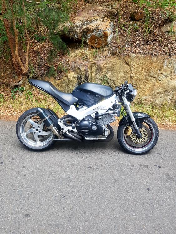

i am about waist deep into a naked conversion. i could stop here and be moderately happy with it, but i thought of putting a monster tail on here. the thought wont quit nagging at me until i check into it further.
here's what the bike looks like right now.
[/img]https://imgur.com/OD92eOg[/img]
has anyone swapped a monster tail onto a vfr800? i have seen tons of hawk gt riders do this mod, and the frames look pretty similar. i guess i need to know some measurements of the subframe mounts, and to know what all i'm getting into, before i get into it.

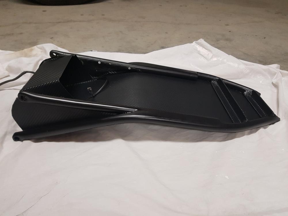

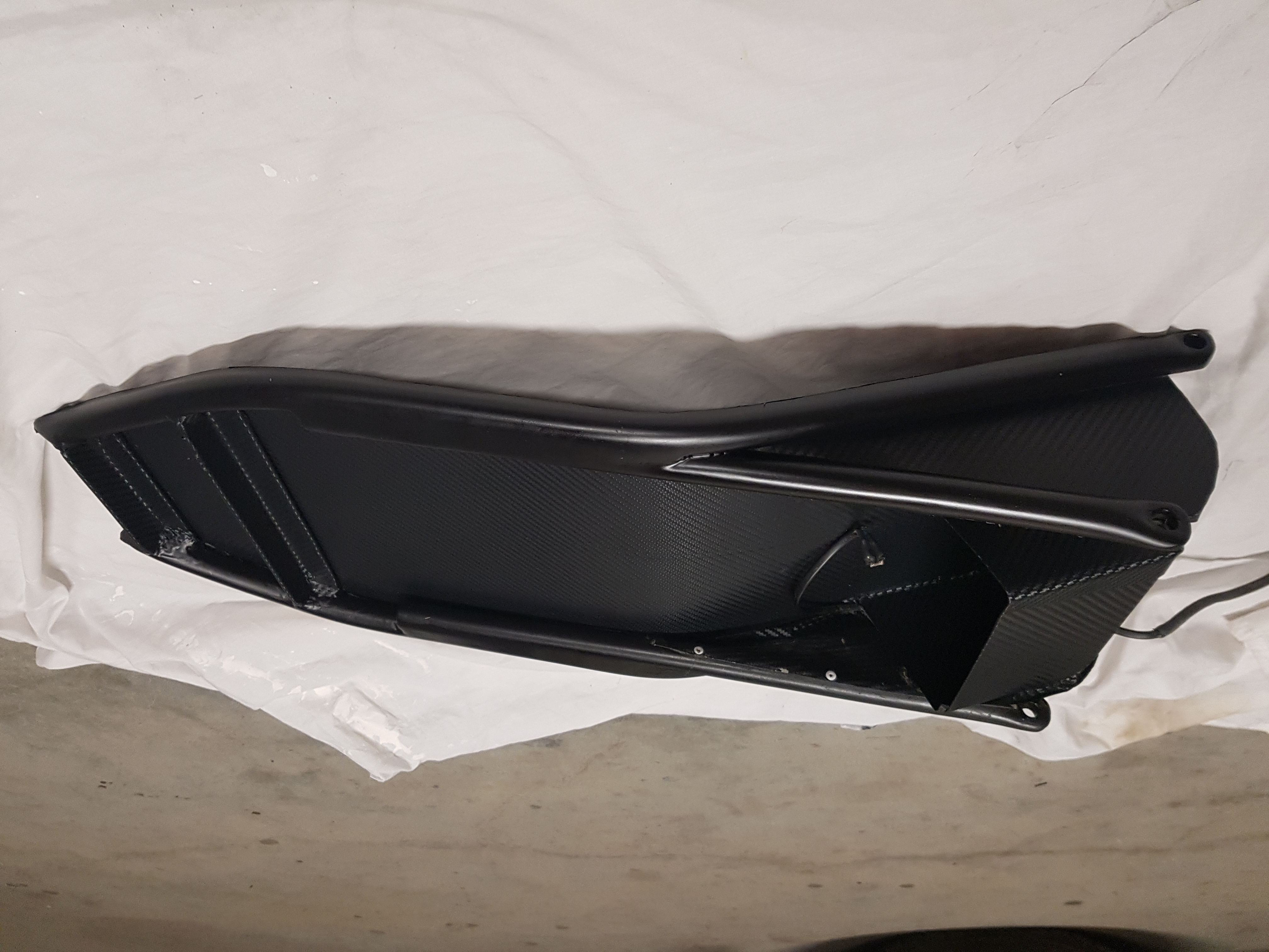

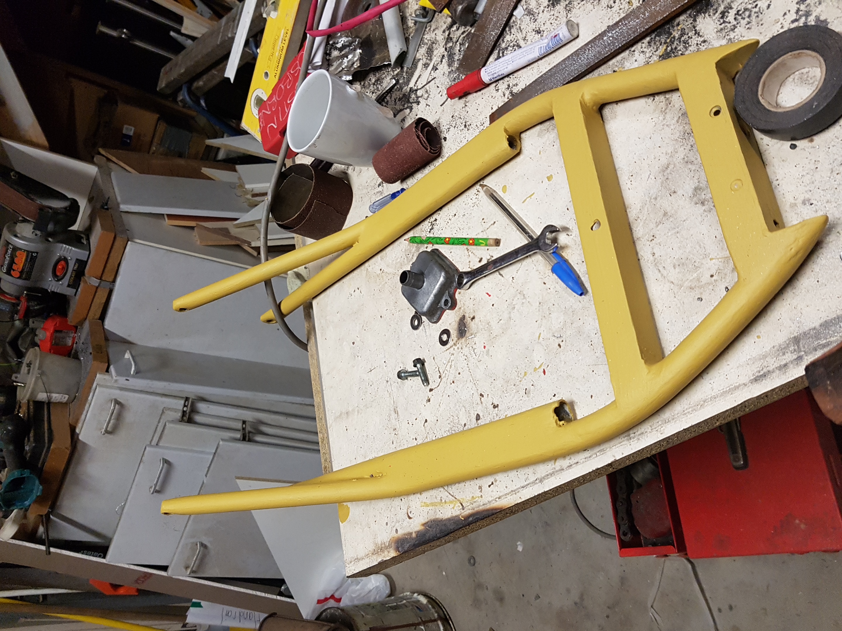

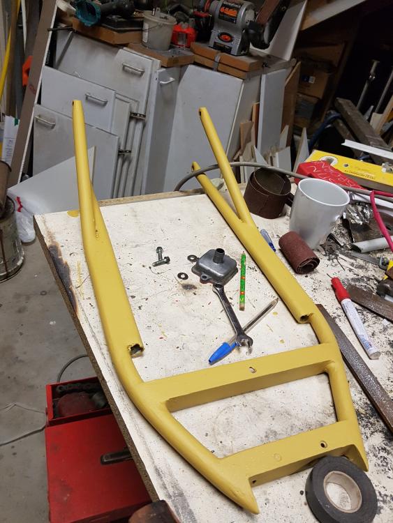

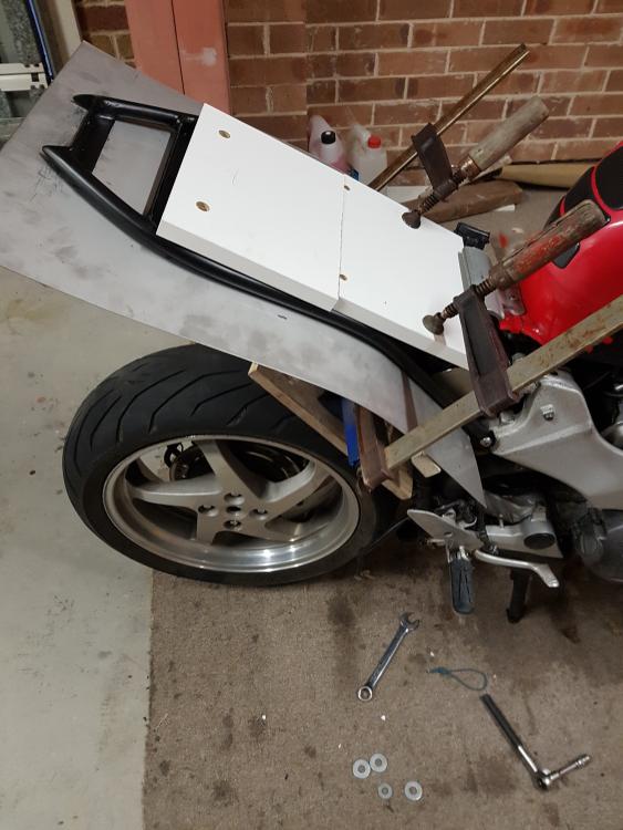

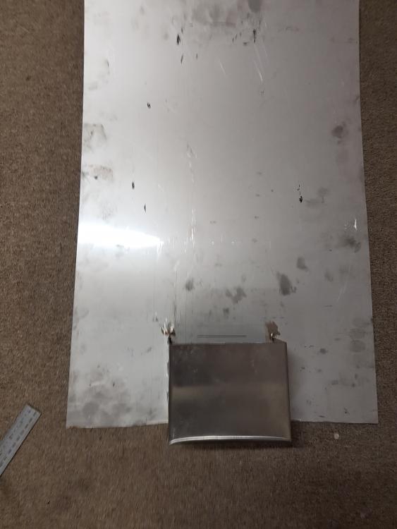

Thanks for the kind words.
Once you have a monster seat and a tail light, the sub frame is just 4 bent tubes ,2 angles and a base.
Here's some pics to help.
Sub frame.
Base with battery box.
Base riveted to sub frame.
I'll put up some pic's I'm sure a local could fab it together for you.
S.V radiator is a lot easier to fit.
Search zerfarton here, he modded an existing vfr sub frame to suit monster seat.
