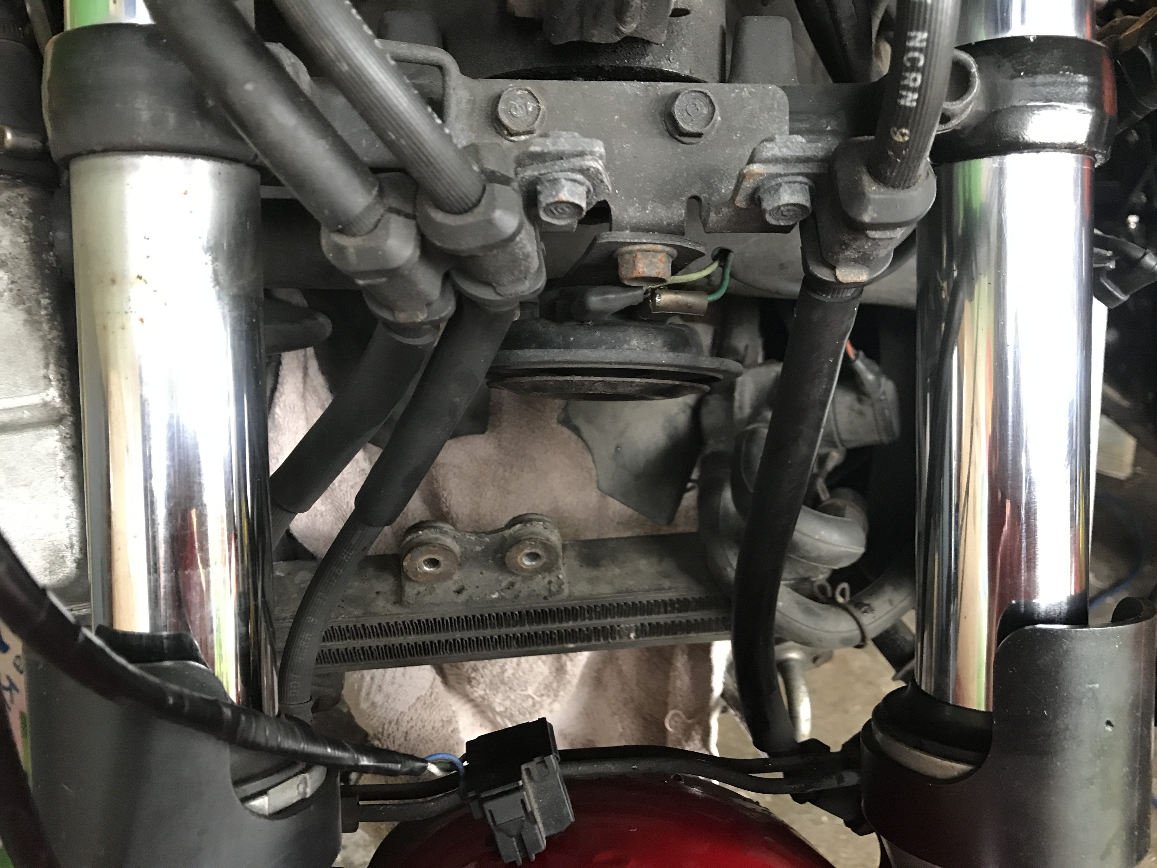

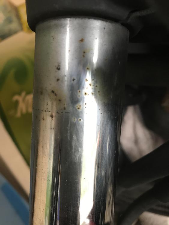

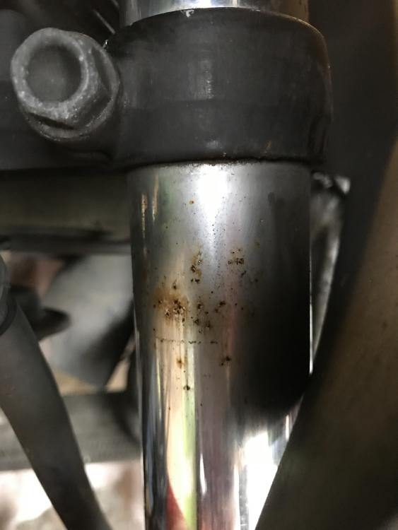

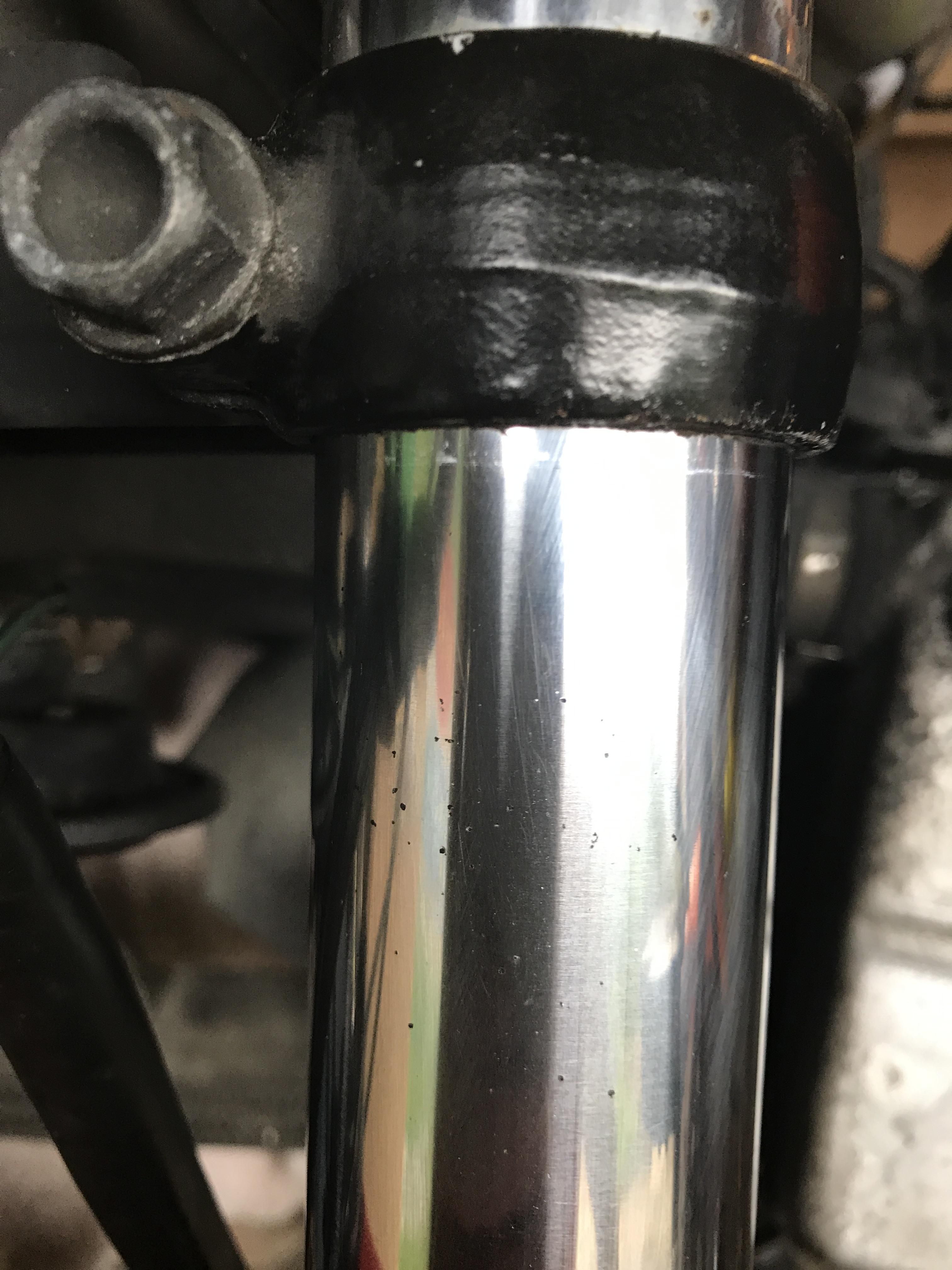

You can can see from the pics how much of an improvement there was, although some deeper pits remain, although  they are much smoother and kinder to the seals.

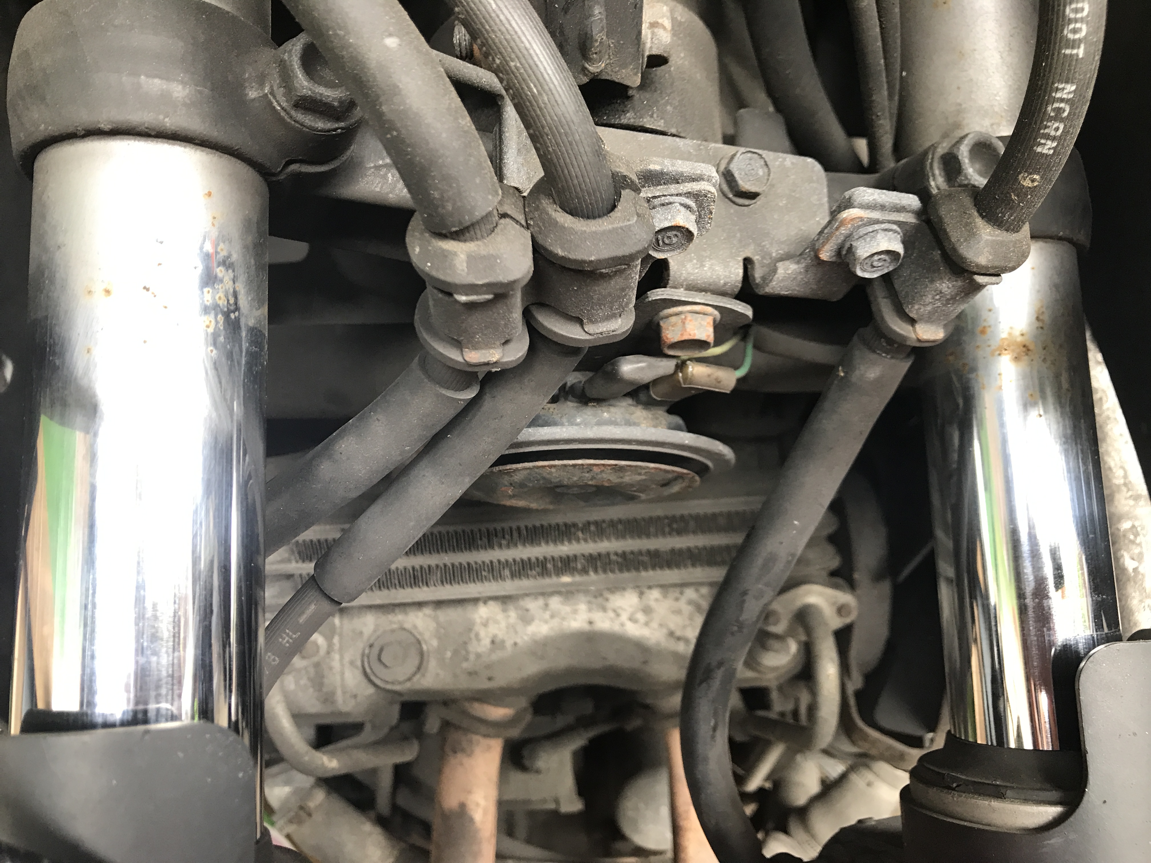

Firgot to say in the last pic the left fork is still rusty whereas the right one has been cleaned. It's not perfect but you can see an appreciable improvement.
