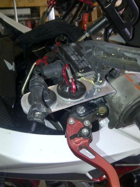

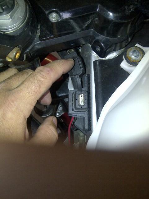

Here is the usb
Here is the camera mount. The mini red 'biner is for the tether strap
