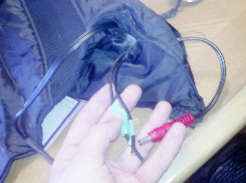

This is the coax-in.

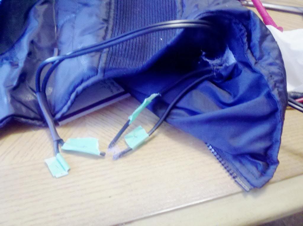

Coax-in and out-to-heating-elements, marked for polarity because I'm only 90% sure polarity doesn't matter and better safe than sorry.

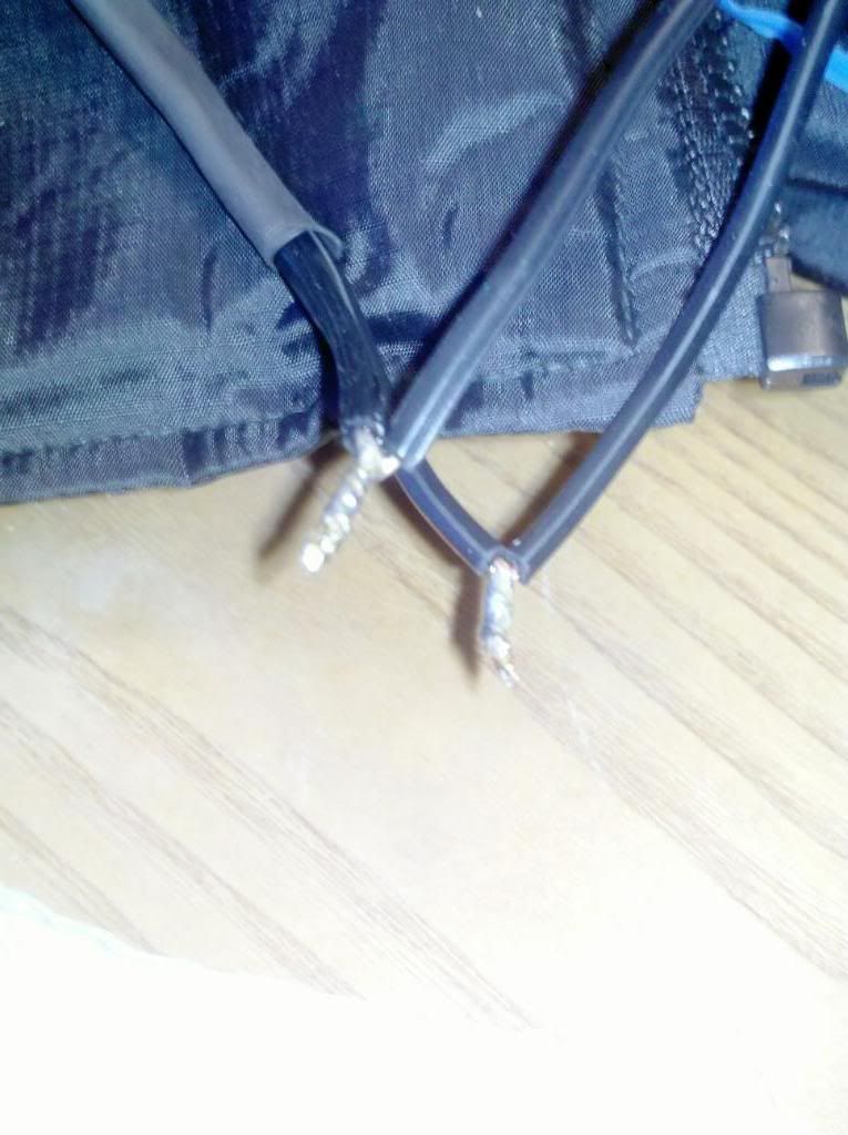

Be sure to make a good connection, a lot of current will be passing through here.

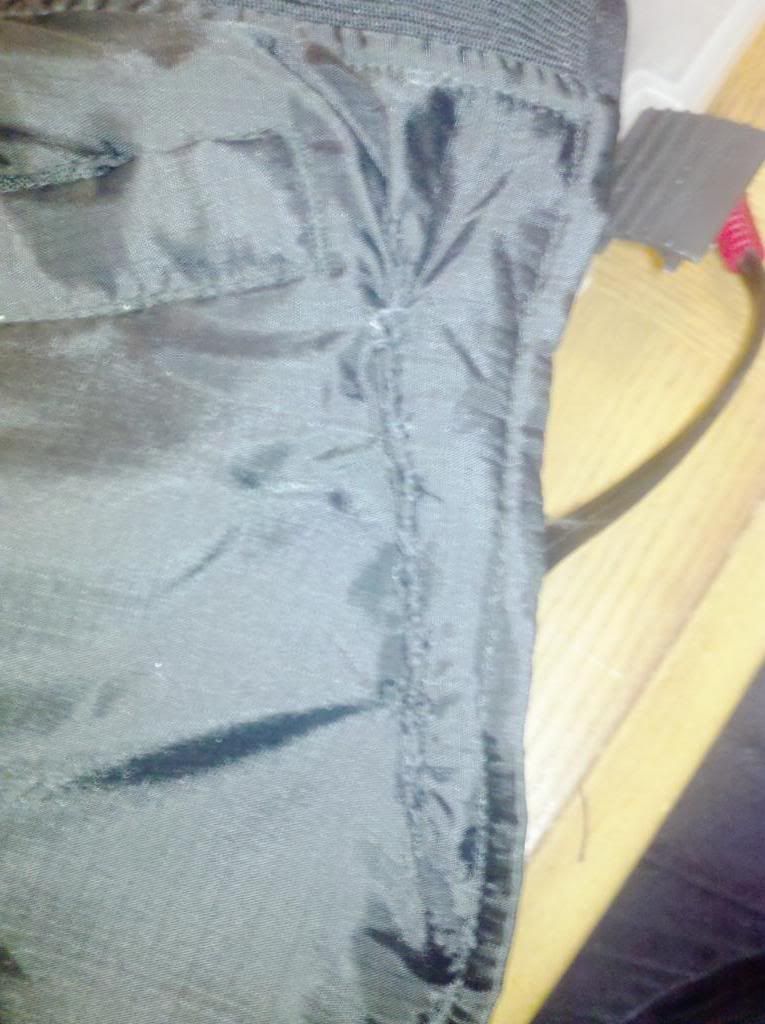

With such a talented sewing assistant, you can barely see the scar from the controller-ectomy!!!
