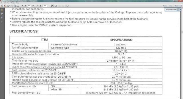

It should state the correct fuel pressure in the Blackbird Factory Service Manual.
I agree... that is where I was hoping the number came from.
Anybody have a Blackbird manual that can check?
Posted (edited)
there you go 99 and 00 are the one you want confirmed. I think thats a mistake in the manual it should be After 00 (01-03) as 50psi. I would go with a 99 just to be safe.
16740-MAT-E02 replaces 16740-MAT-E01.
16740-MAT-E22 is the 50psi 01+ fpr
Edited by klrtovfr
Thank you!
So the 99 BB is 43psi... that's a couple pounds more than I wanted for the 800... might work on the track bike though...
Do you know if they change something, maybe injectors on the later models?
