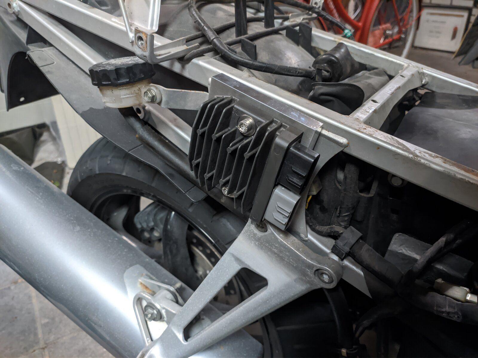

However i've also had some electrical issues in the first few weeks.
Left me stranded twice with a empty battery.
As that issue is well known, it was also easily fixed.
Just placed a FA020AA with a beefy cooling aluminum cooling block.
Added some spacers to the frame while it tends to get hot from the rear cilinders.
Replaced the stator wiring and connectors and got the output routed to the battery directly (fused).
At the moment i'm collecting some parts to service the bike and get it ready for when winter ends.

Sorry to hear you got the dreaded electrical issues.  Hopefully you get to put some miles on it after your fixes.
Did you get a good deal on the vfr?
"Replaced the stator wiring and connectors and got the output routed to the battery directly (fused)."
Did you check/measure the stator's internal reasistance over each pair of yellow wires and Vac output at idle and 5,000RPM (engine hot)?

@Dutchy I did. Luckily nothing wrong with the stator.
Before the new regulator the charging voltage was 12.5 at 2000rpm and 13.6 at a high rev, if the lights where off.
After the mosfet regulator was swapped in, the voltage was a stable 14.53V. A high rev only followed by a short 0.01 increase in voltage

You measured Vdc and that is ok.
With the voltage regulator disconnected (the bike will start fine w/o it), measure the Vac (wisselstroom) output over each pairing of the 3 yellow wires). There should be no major delta in the readings.
I suggest you instal a small voltmeter. The actual reading is not that important, you will soon know what is "normal".   If and when the readings are 1- 2 volt "off", you know it is time to head home 🙂

I measured resistance in Ohms across all stator spools actually.
Indeed haven't measured the resulting Vac, but the guilty part was quite clear while the old regulator was "bleeding"
The voltmeter is already bought, just not mounted yet.
