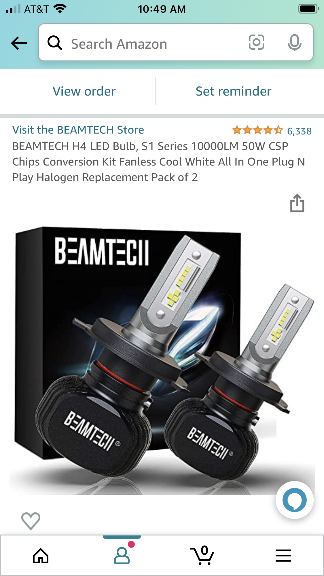

I bought the Beamtech “fanless” ones off Amazon, broke off the the lower tabs, and stuck ‘em in WITH the factory housing caps. They work perfect. I put them in my SV, as well. No problems there, either.
