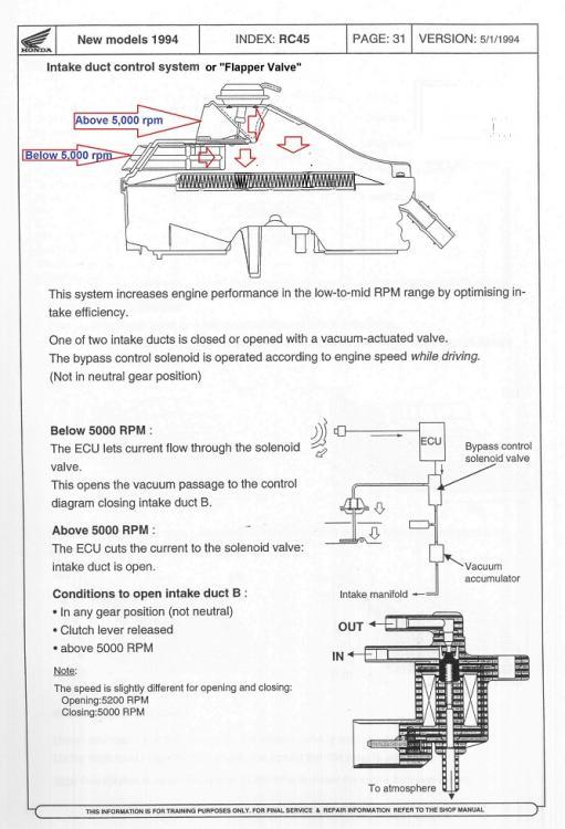

Why? The ECU commands the flapper valve in the airbox to be open in neutral, or closed in any gear with the clutch released (below 5500rpm), or open with the clutch pulled in, in gear. Don't ask me why Honda set it up that way. If the microswitch is a bit dirty, the vacuum solenoid flickers and the vacuum signal fluctuates so the flapper intermittently operates. On my VFR it sounded like electrical arcing, which was more alarming than your mouse noise.
The microswitch can be cleaned out with electrical contact cleaner and a bit of working; if that doesn't help, the microswitch is cheap to replace.

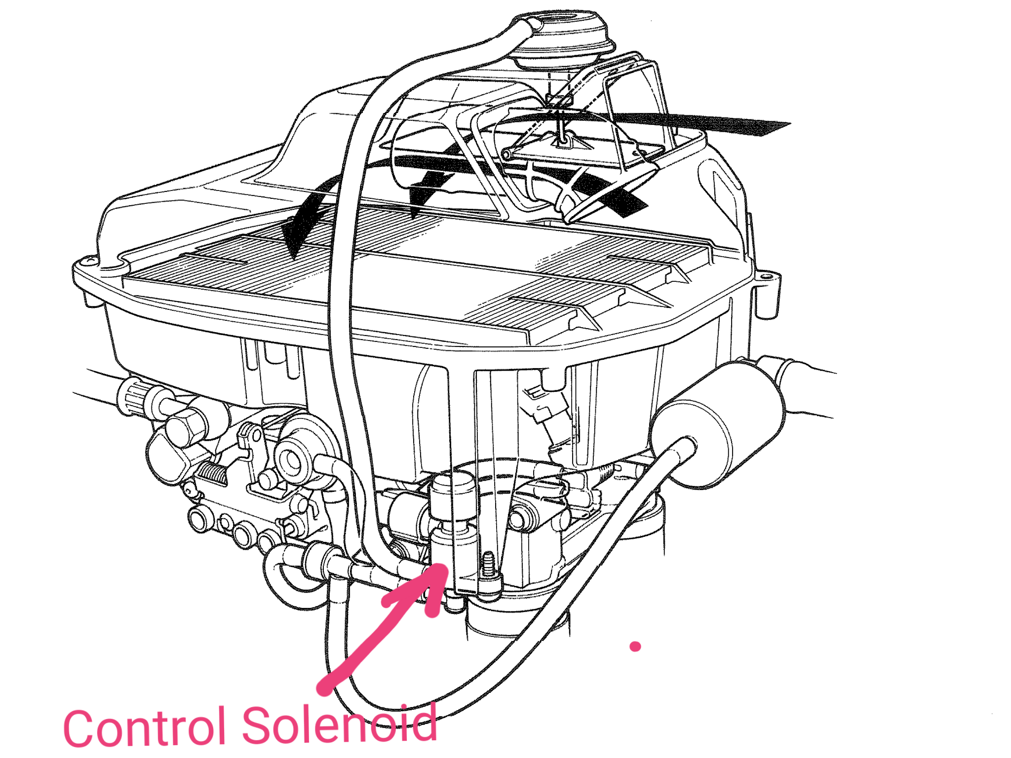

Further to what Terry has suggested. To establish if the noise is coming from the air intake flapper system, try this easy test.
Locate the Control Soleniod for the Flapper diaphragm. Its located next to the airbox on the right side. Follow the vacuum line from the Flapper diaphragm on top of the airbox, it goes down to the Control Solenoid. See attached drawing.
Unplug the electrical connector of the Control Solenoid.
Now go through the same test. Do you still have the noise?
