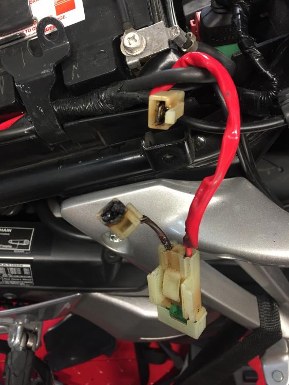

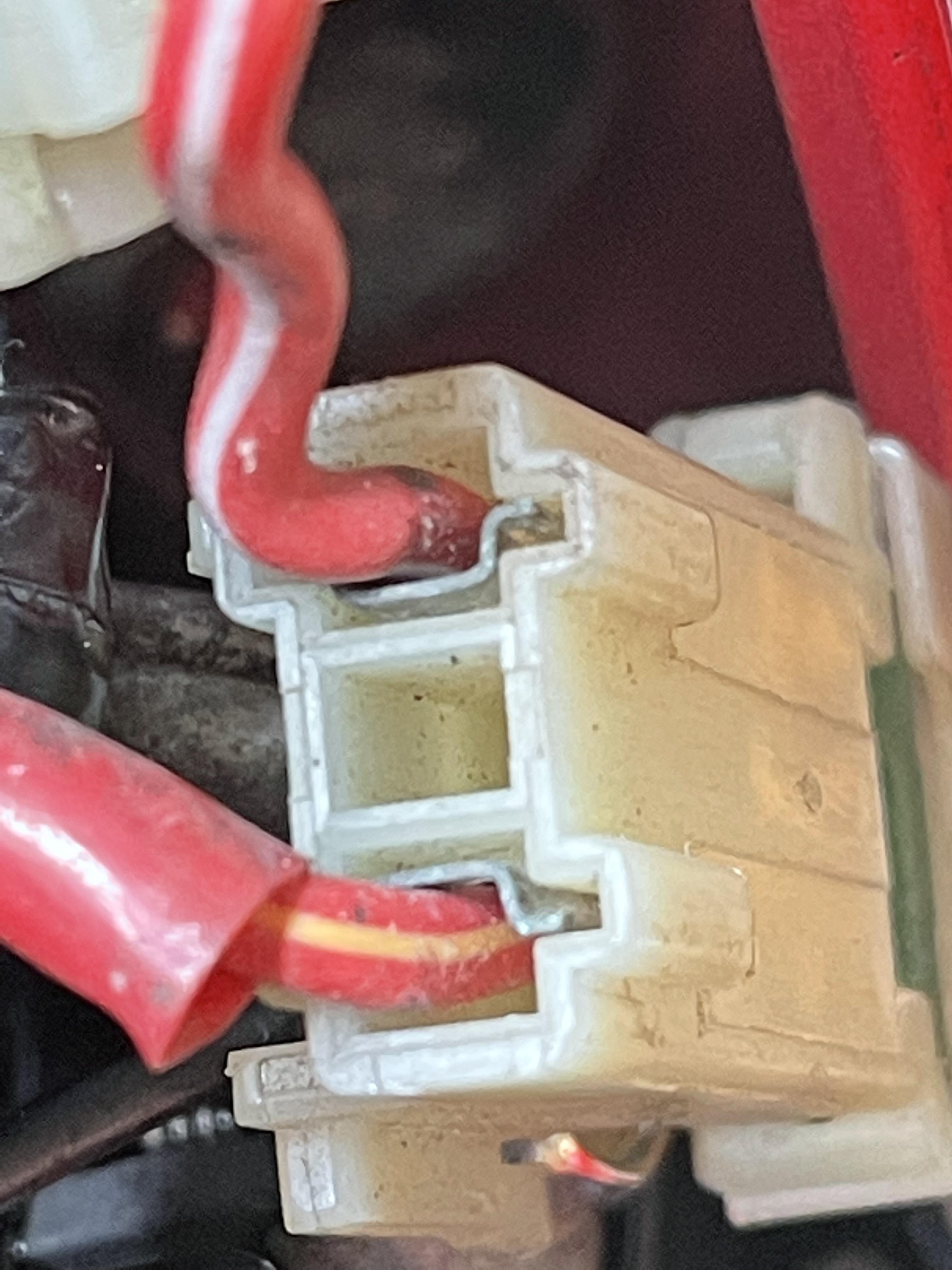

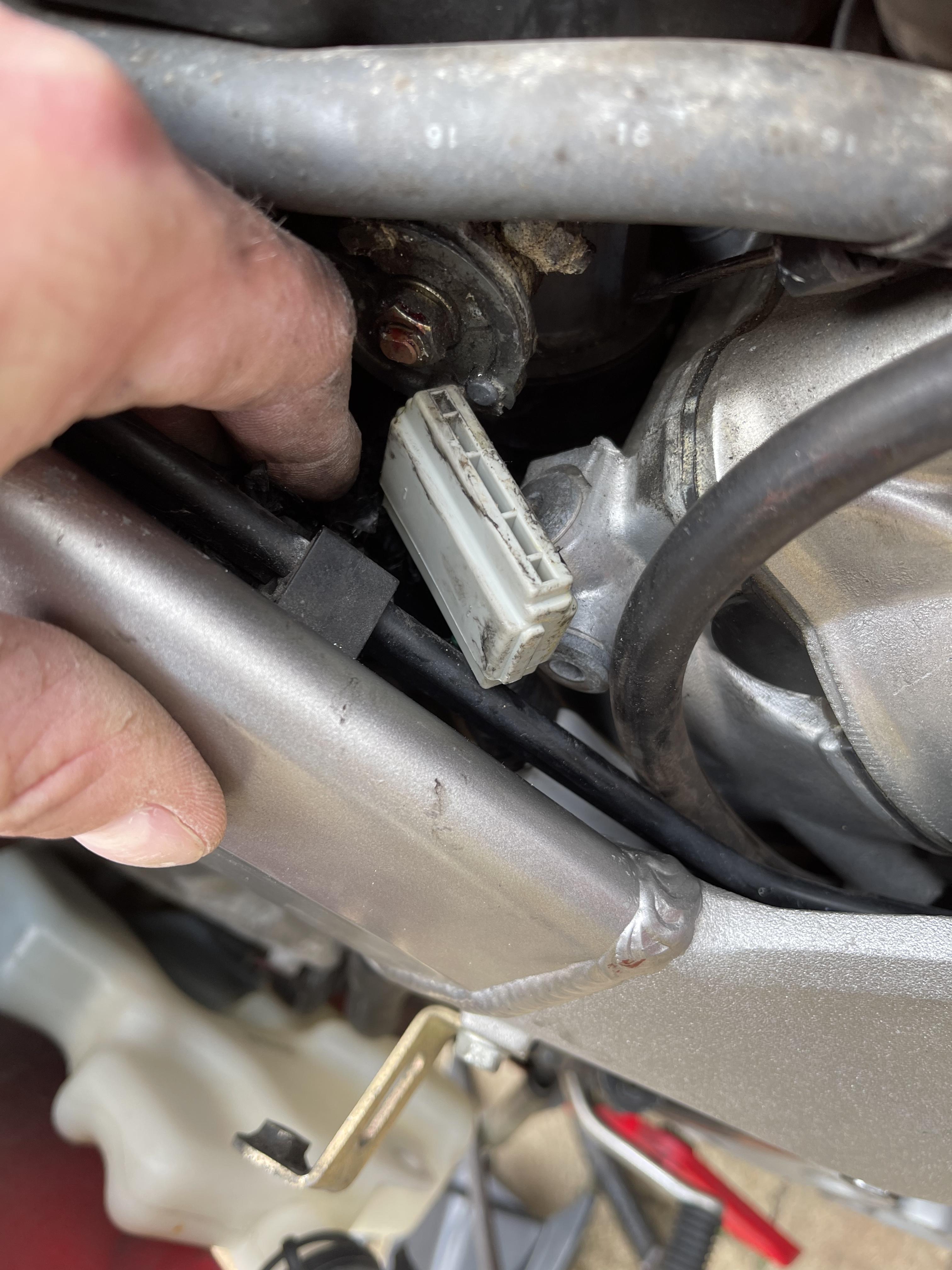

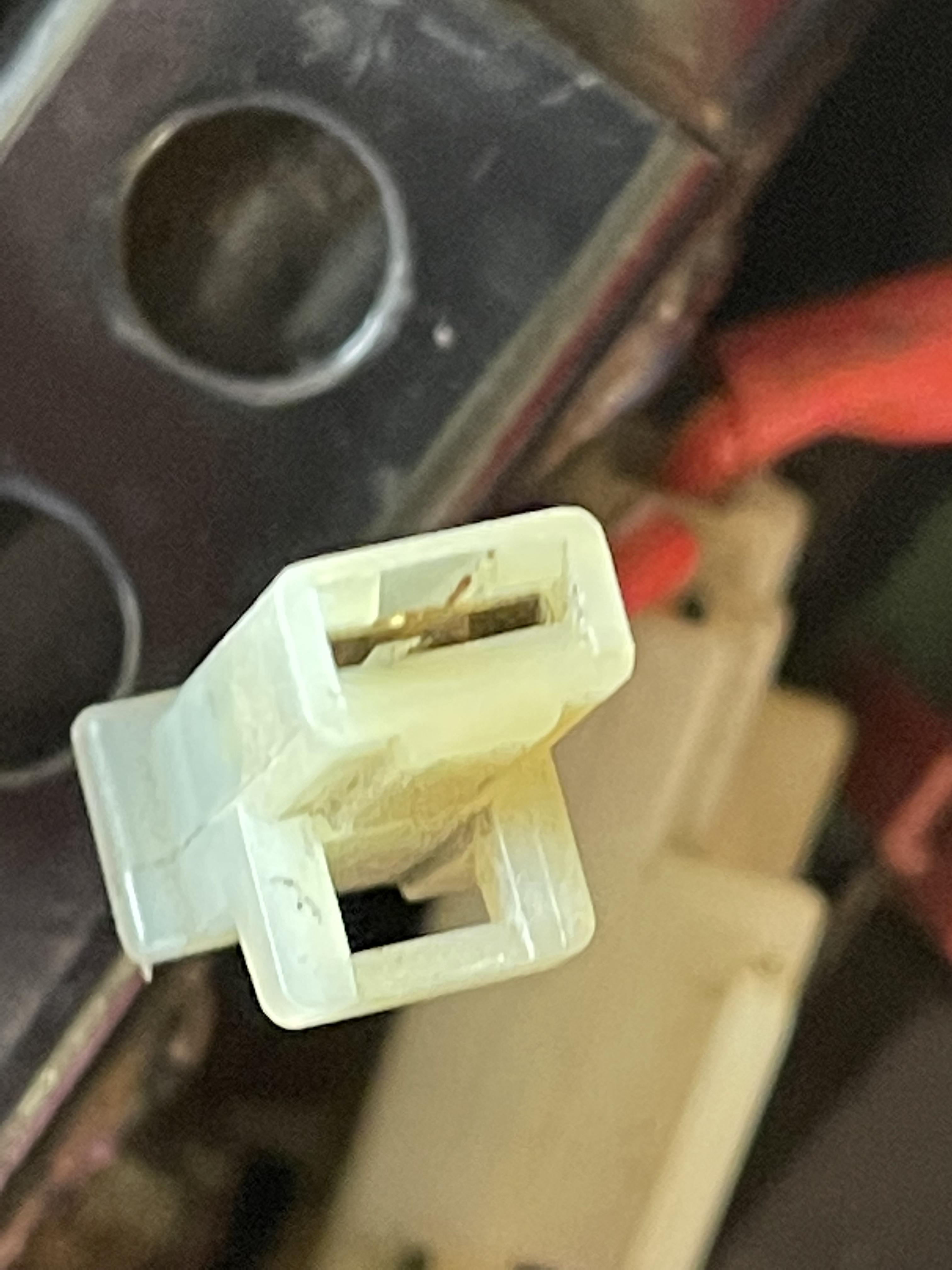

Hello again BSR67.
Ok, first thing is have a very close look at Main Fuse B 30amp located next to the Starter Relay. This fuse provides the main power for All your EFI stuff. It can suffer badly from overheating and high resistance connections, check for any heat stress for the fuse and wiring especially in inline connector. See photo.
Regards your "alternator/rectifier" concerns. If you can get your bike going confirm your charging voltage with a voltmeter directly on the battery.
What voltage do you read at Idle and 5000rpm?
Check these two items and get back to us.
I am also suspicious about bad Grounds for your ECM!

Hi Grum
Connections look to be in good shape. Multimeter landing tomorrow.
The bike does run but the FI light stays on.

Hi Alex. Good to know your bike at least runs and Main Fuse B and its wiring are in good shape.
Its really important chasing the fault you have that when referring to the Fi Light, what is the position of your Sidestand?
In the UP position and you have an Active fault or something wrong with the ECM the light will be constantly ON.
In the DOWN position if you have an Active fault the light will flash the code. Do you still have the code 23 flashing? Or is the Fi light just permanently On, irrespective of Sidestand position?
A code 23 Oxygen Sensor will not kill your bike or give issues like you're describing. So don't worry about this just yet, you have bigger fish to fry at the moment!
When doing the charging voltage test mentioned. Do this in both cold just after start And when the engine has fully heated up.
Also check your Battery Terminals are clean and tight.

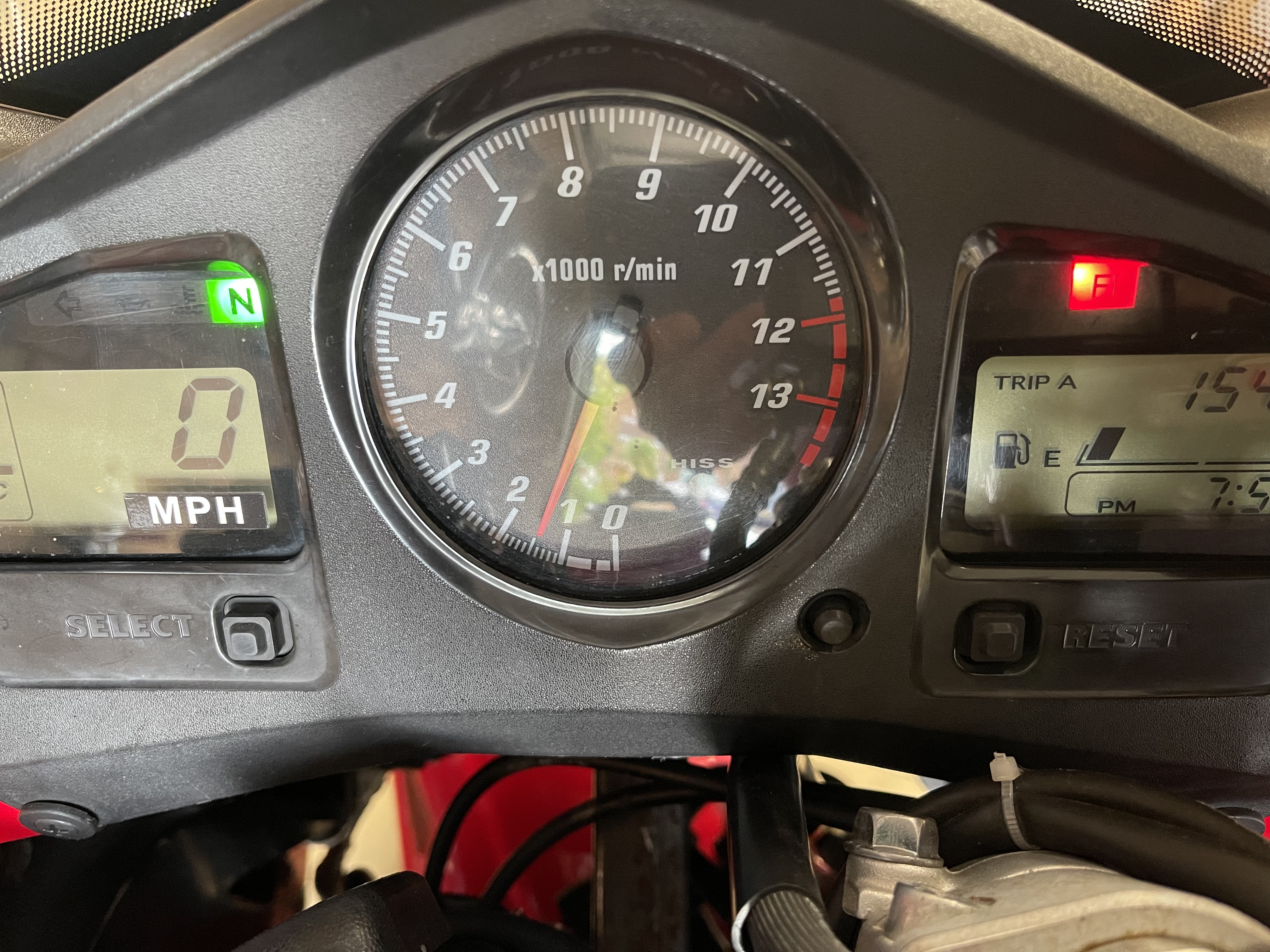

FI light not on. On centre stand. Side stand up.
The only other thing I have done is disconnect these two wires from the +ve and -ve of the battery which I think feed a 12v socket outlet/USB which is not connect at the USB end. The terminating wires are tapped up.
Have checked continuity of 30Amp fuse. 100% OK. They get bloody hot don’t they!

I’ve cleared the fault code. FI light stays solid when dealer plug bridged. At the moment FI light goes out after removing bridge ……..!!!

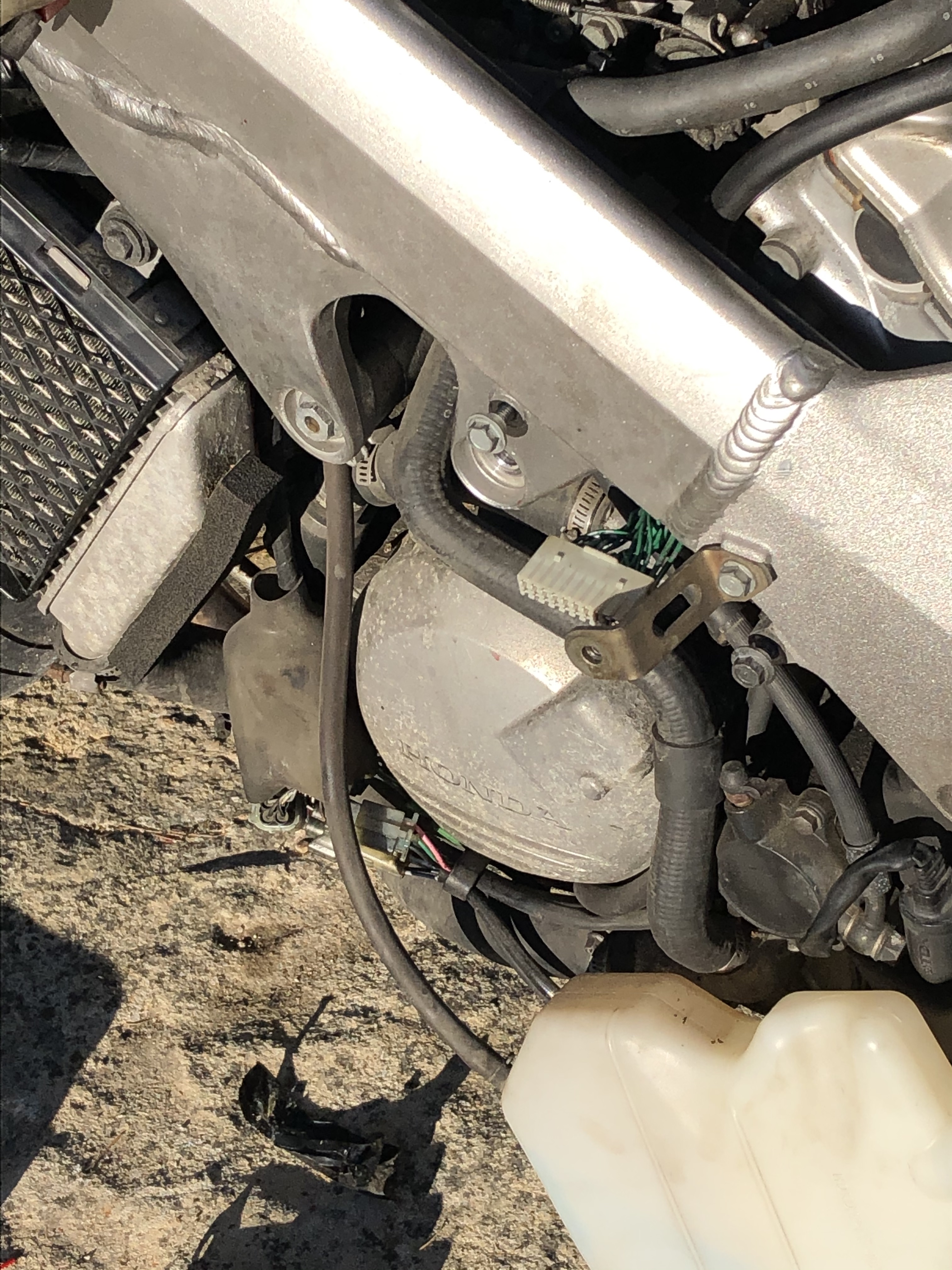

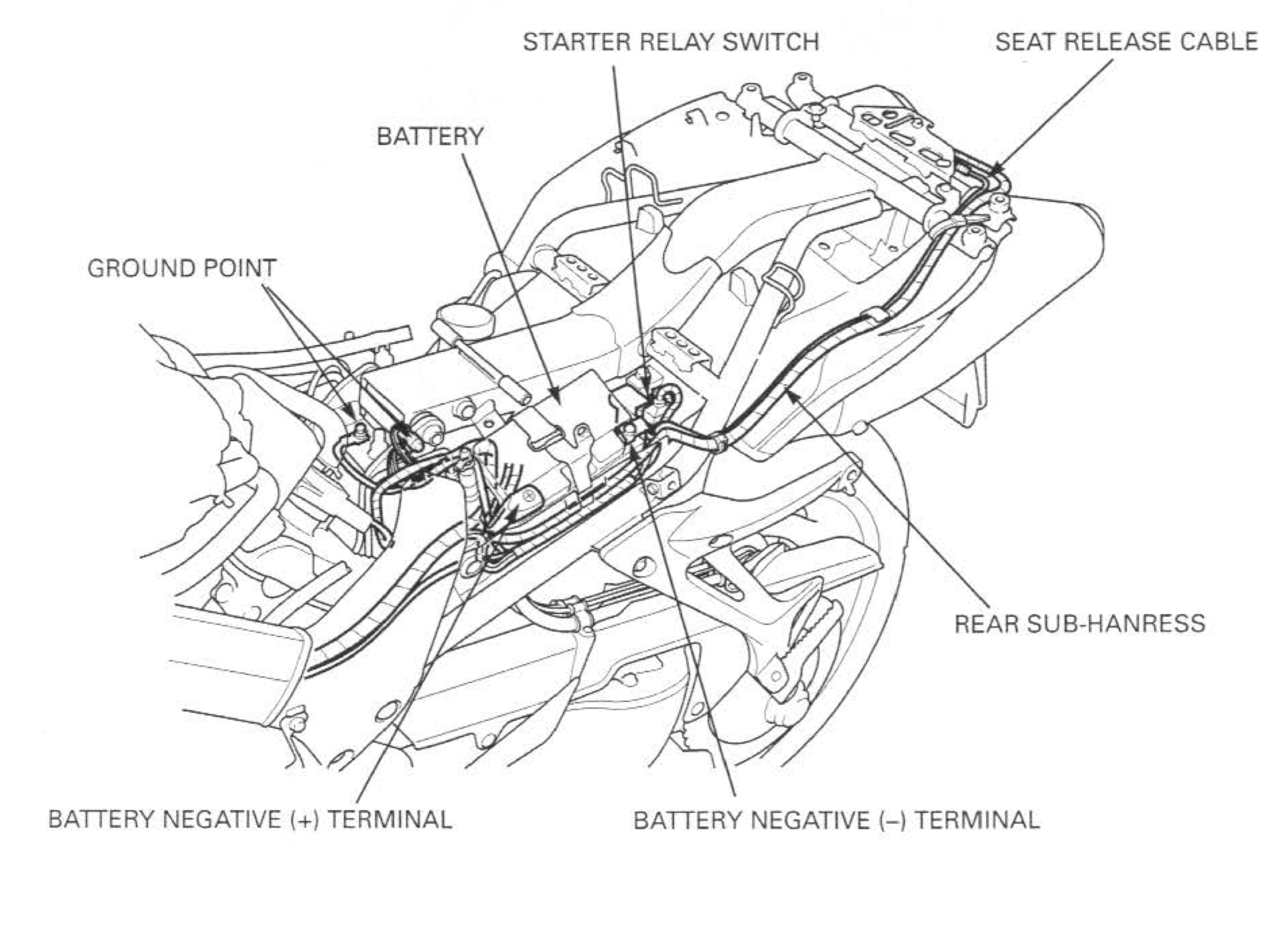

1. Check these two ground points. Make sure they are well bonded to frame, no damaged wires and they measure Zero ohms/continuity back to the battery negative terminal.
2. Remove your left main fairing and remove the coolant reservoir. Just behind the frame weld taped on the wire harness is this ground junction block. You'll need to expose and inspect it. Remove its cover and a common buss bar that joins all the sockets. Hopefully you'll see something like this with a burnt connection. Take a photo or two, see what you find.

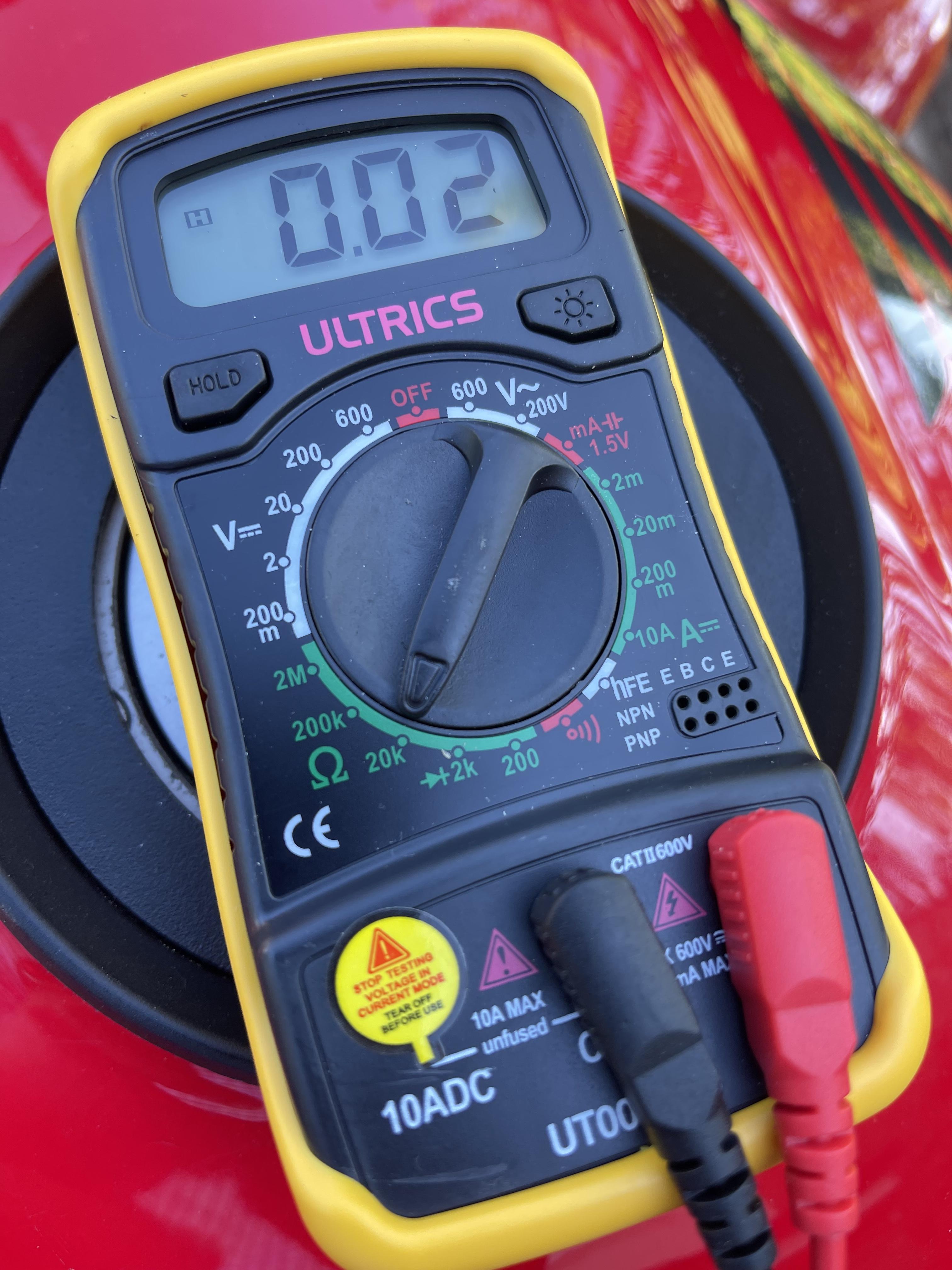

Resistance between battery negative terminal and frame grounding point - see photo!
Will pull side panel this evening. Got to get to work!
Thanks Grum - appreciated.
Alex
Ok lets forget any issue with your battery or charging system. It appears to be in order!
HOWEVER you have your meter on the Wrong scale for measuring continuity! You are actually reading 20ohms on that scale and thats NOT good for a Ground!
Recheck those Grounds with meter set to the 200ohms range. The value you should read should be virtually the same as shorting the leads together 00.0 ohms. Again Black lead on negative terminal red lead probing the two Ground points.
If you do read anything like 20 ohms then you have a BAD Ground point.

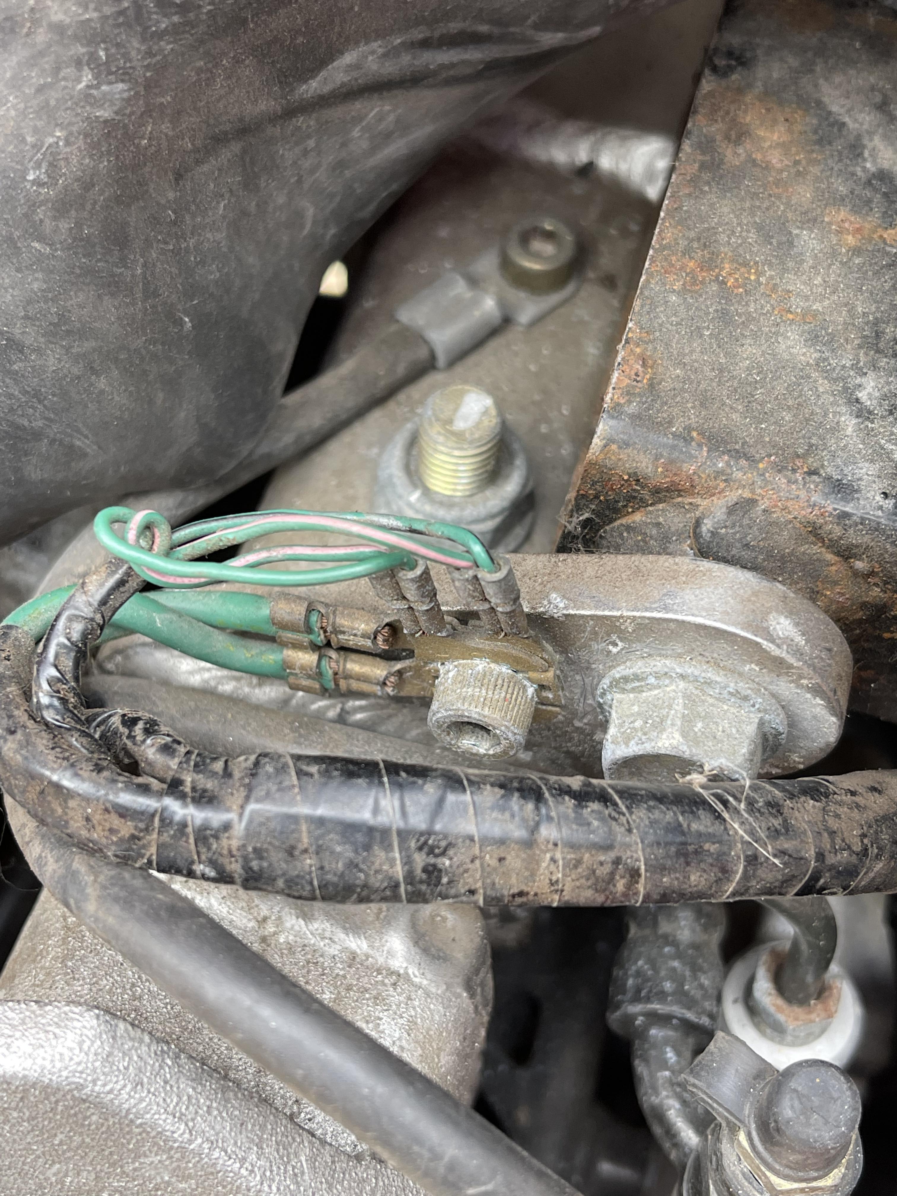

Two of the ECM grounds being the Green/Pink wires B1 and B2 possibly are at the rear tank area grounds, do you see at least 2 Green/Pink wires at that Ground point?
The other B14 Ground Green wire possibly goes to that Ground Block.
The block needs to be checked after confirming frame grounds.

Are you sure there's not enough flex in the harness to access the ground block as per photo?
Can you see a cable tie anywhere that you could remove that may allow better access by allowing you to carefully pull the harness down slightly again as per photos?
So again.
1. Confirm Frame Grounds are good or bad back to battery negative.
2. Inspect the harness Ground Block for any defects, refer photos.
3. Confirm the 3 ECM grounds B1, B2 and B14. These must also be well Grounded back to battery negative.

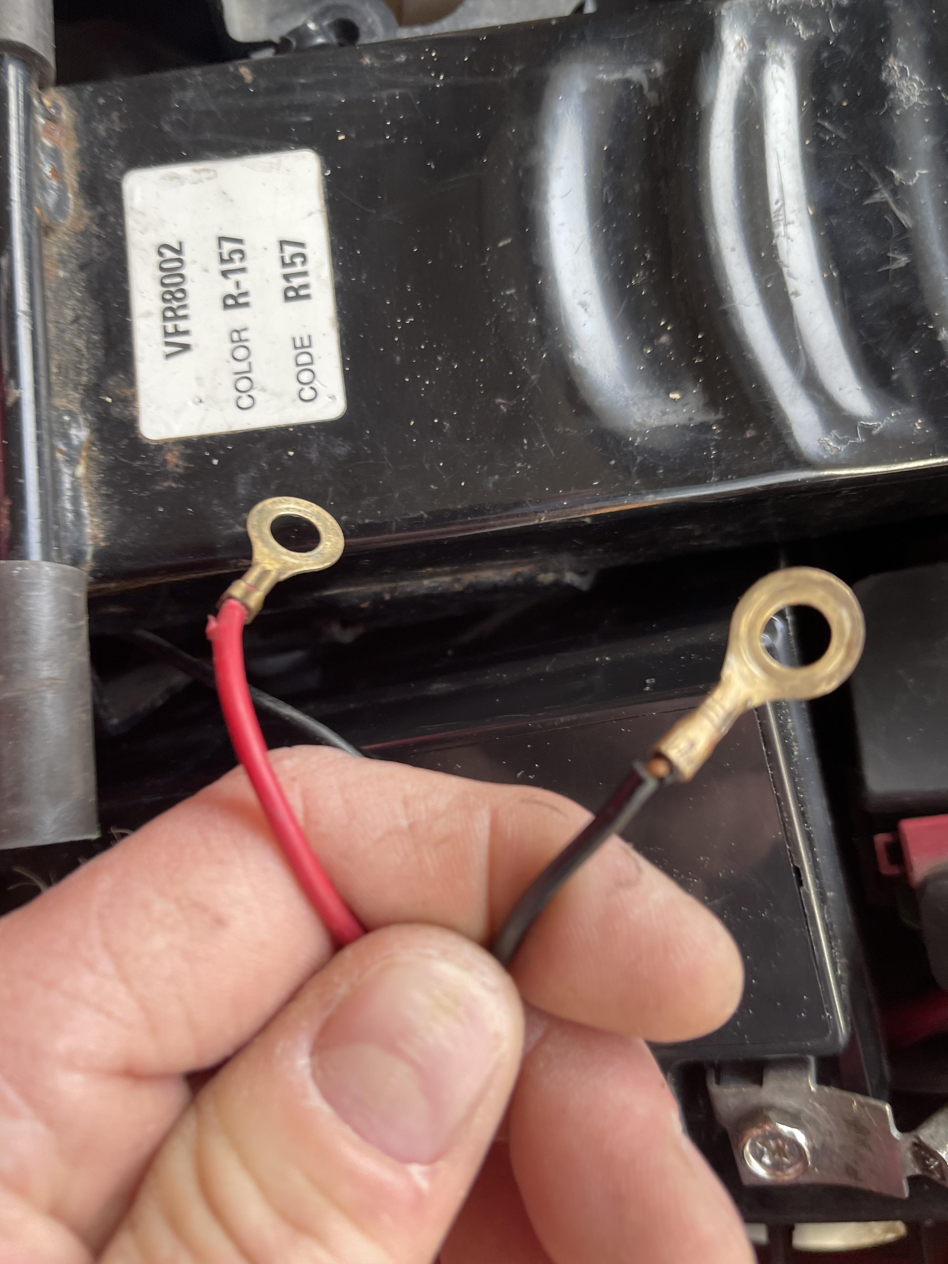

Hi Grum
A small step.

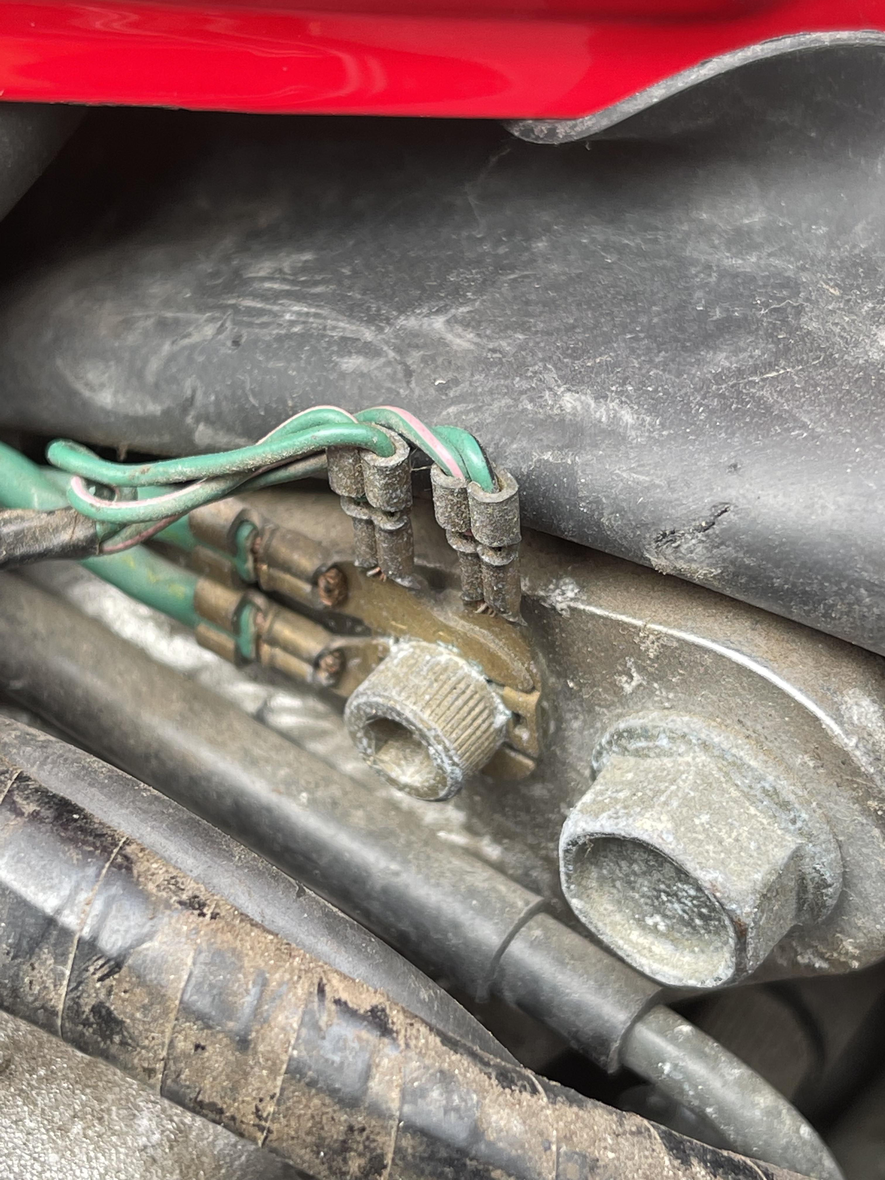

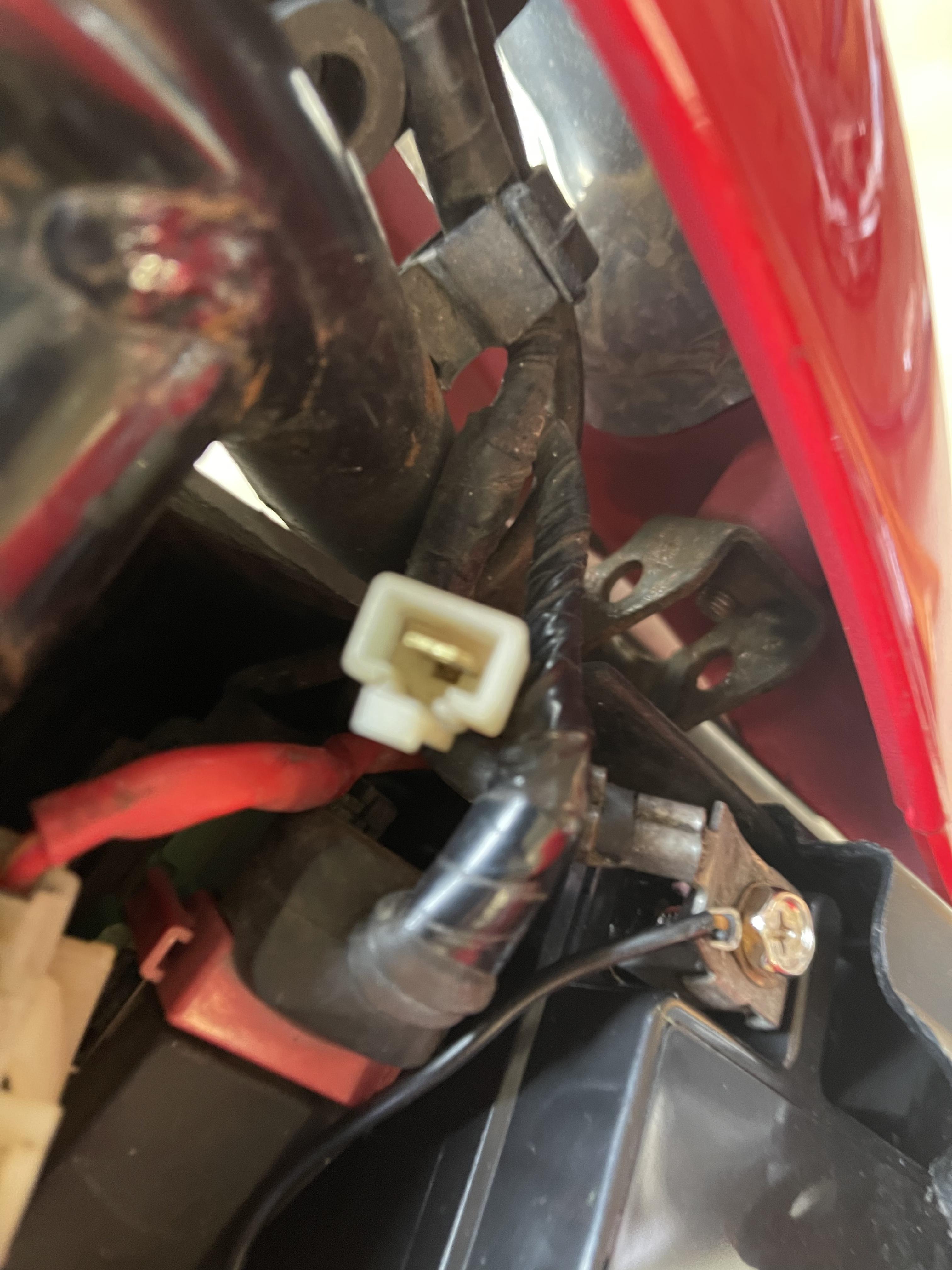

Photograph attached of ground anchor point left hand side of the bike (as you sit on it). It shows the two green/pink wires. Also two further green wires.
The second photograph shows the battery ground bolted to the frame cross member.
ALL readings (black multimeter lead on battery negative, red lead to anchor bolts/copper/steel connectors and to alloy frame immediately next to the anchor points) are the SAME as touching the two multimeter leads together - on 200 ohm gauge the reading is 0.08 ohms. The ground function is consistent and works.
I have cleaned all spade ends and frame mounting points with grit paper as a precaution. All readings are the same at 0.08 after cleaning. The photographs are before cleaning.

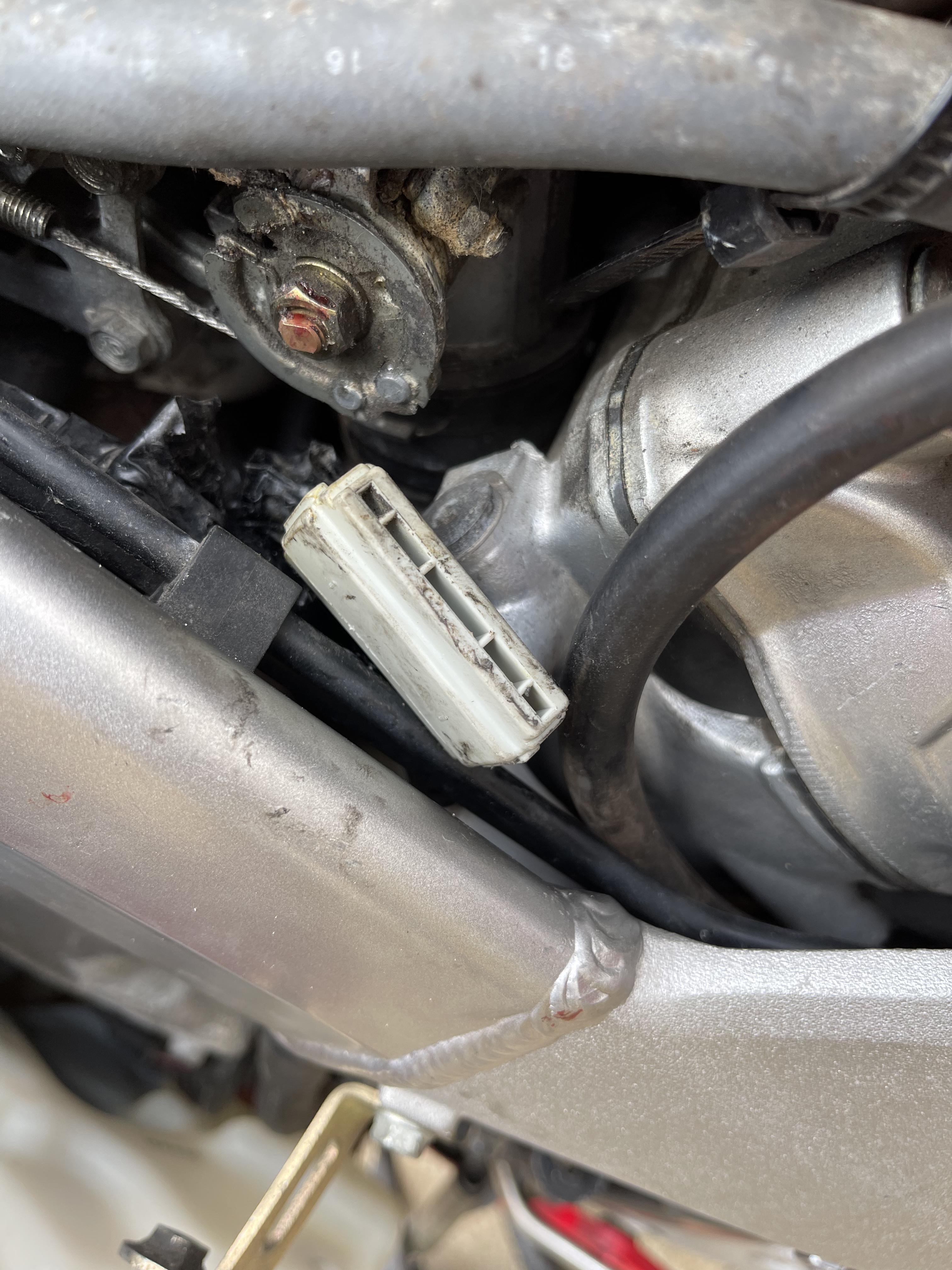

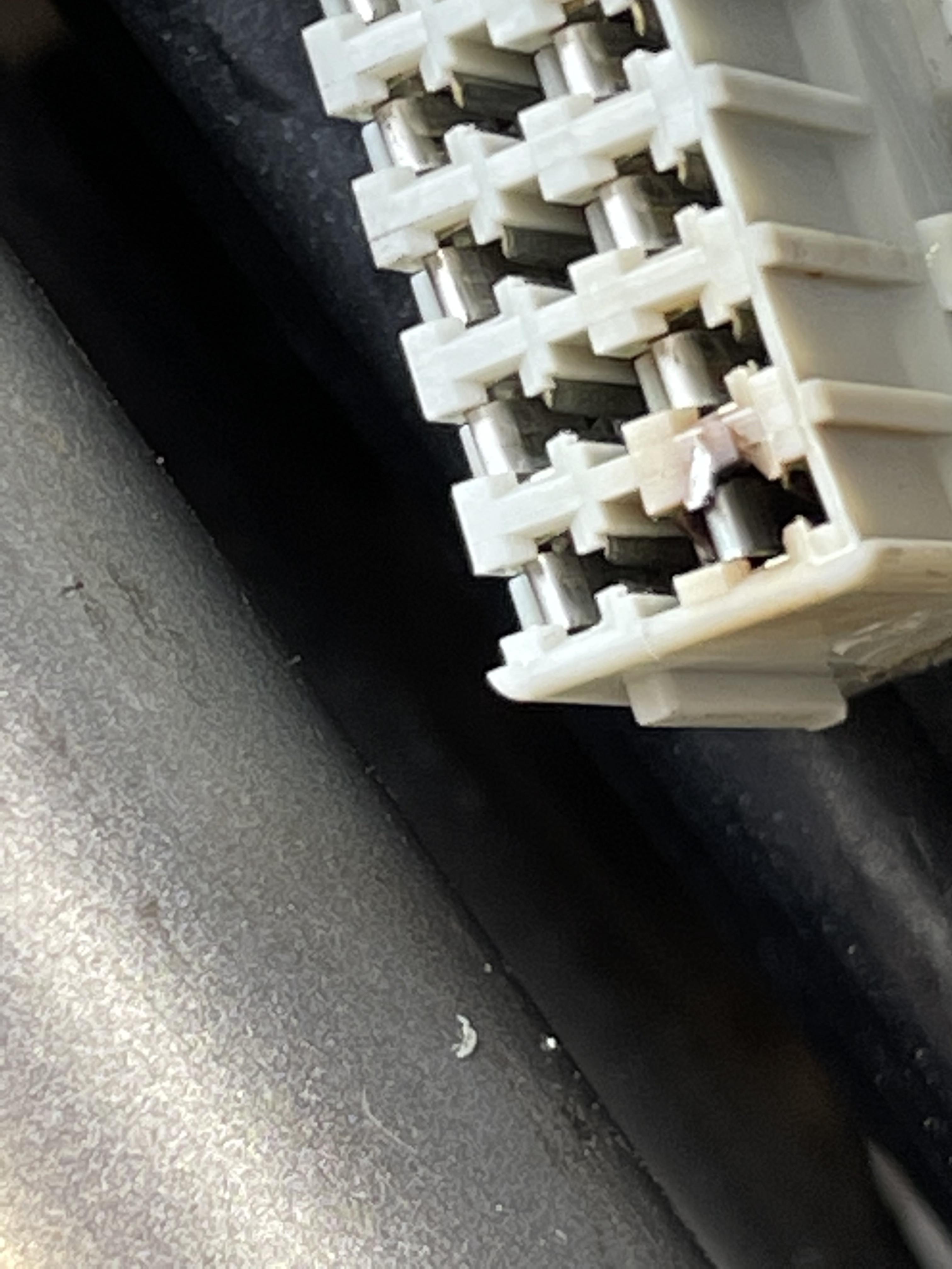

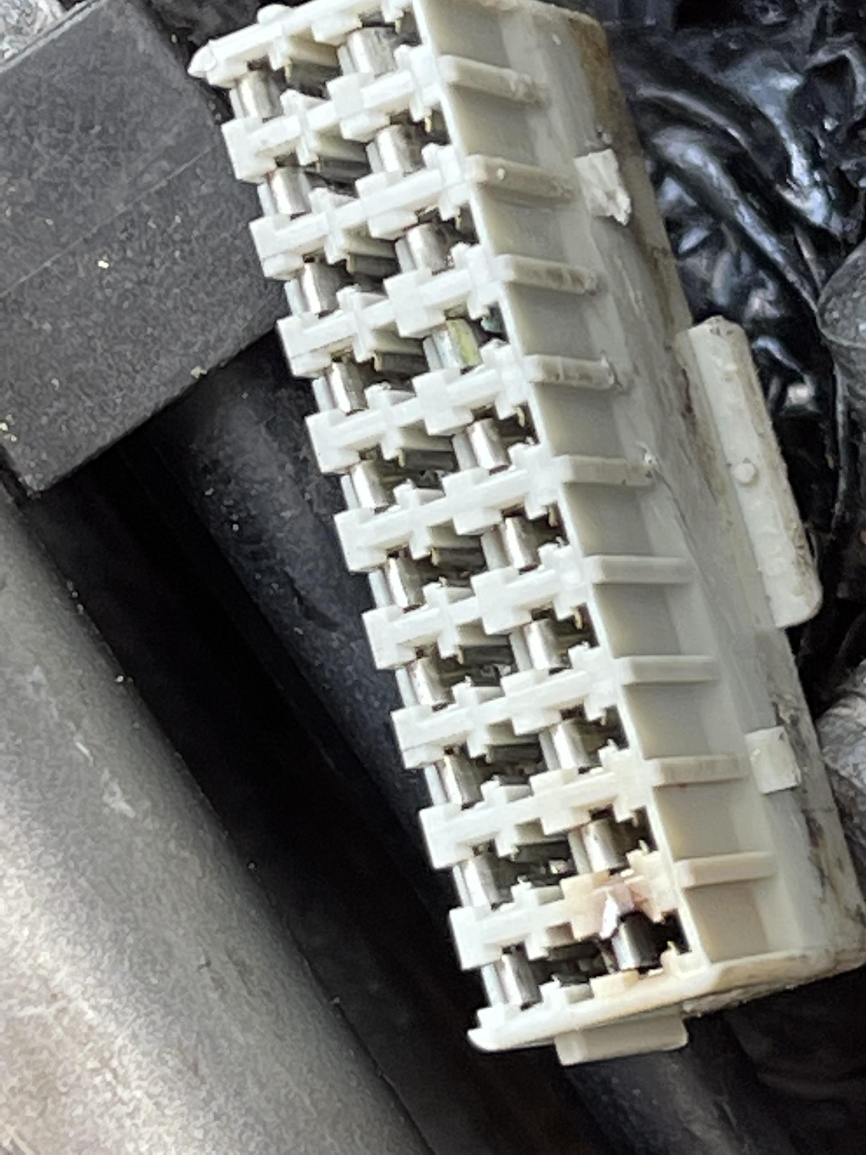

Step 2
Here is the earth block. I’ve unwrapped it. It is far easier to access from the top.
Going to separate the cap shortly.
alex

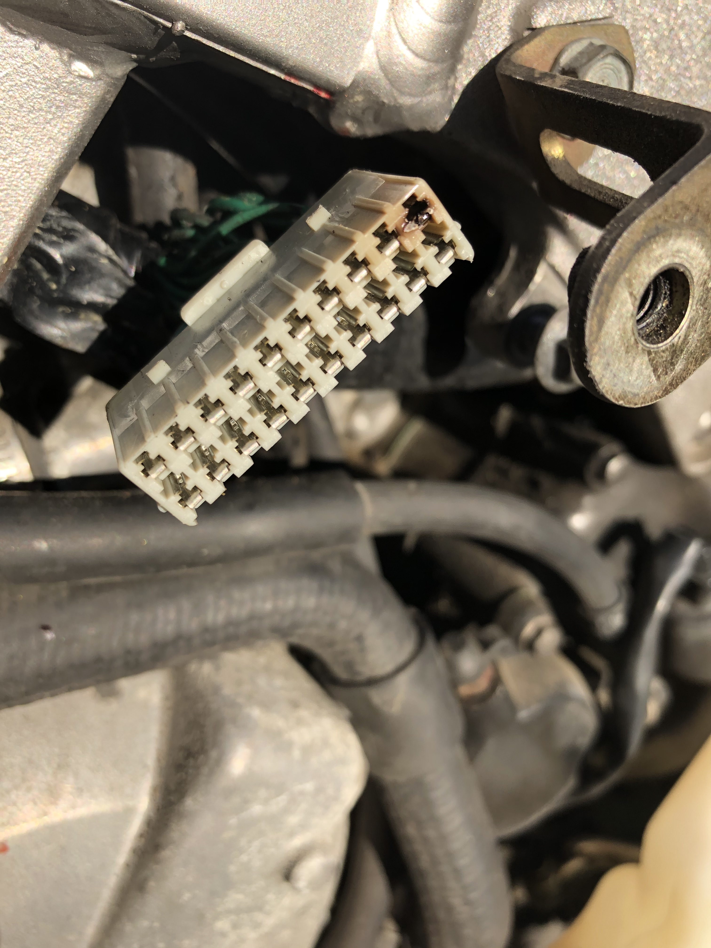

Stage 2 continued.
Plug exposed. Some light scorching.
The lightly scorched terminals across from one another read 0.08 ohms when linked back to the battery negative. Others give no reading. Some are Differing values. Video to follow.
