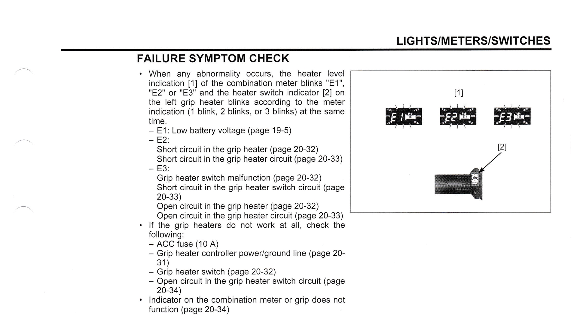

At switch on and Grip Heater selected, the memorized level OR the default level of 5, the light flashes the number of pulses and does this 7 times then the heated grip light remains ON.
Also for example, if the level is changed to say 3 then the light will give 3 rapid flashes for a total of 7 times then the light goes to fully on.
Any fault with the grips should produce an error E code on your instrument panel, see attached.
Mine is a 2014 model. Perhaps they changed the flash code repetition to only three for later models??
Hope this helps!
