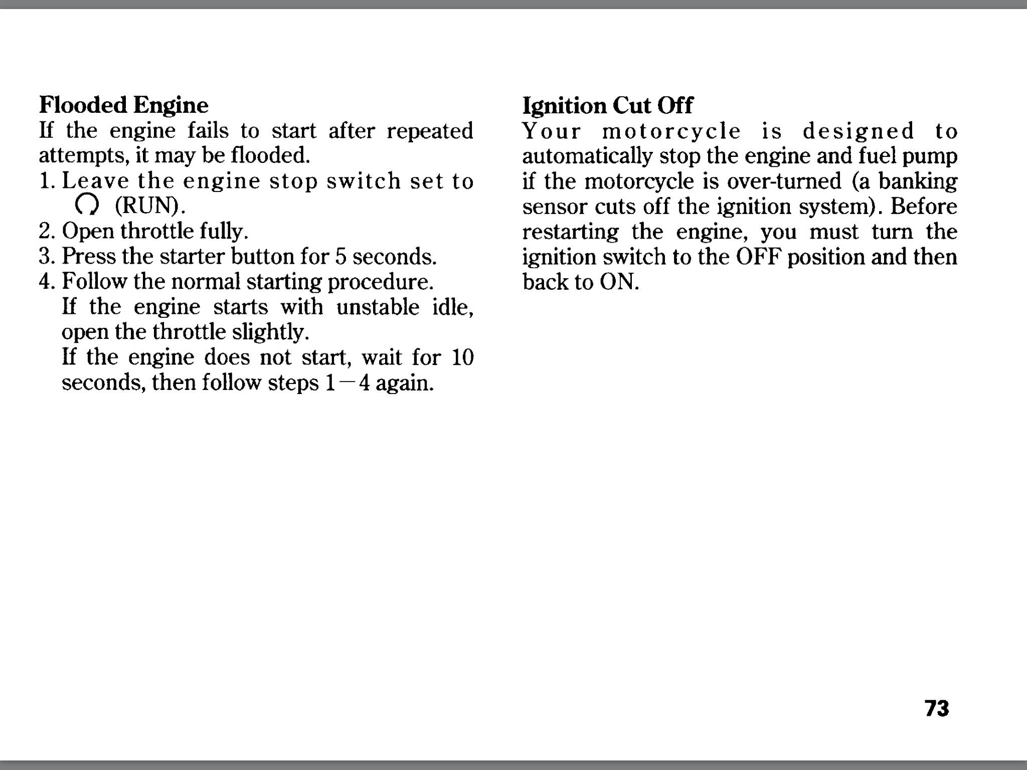

Member Contributer Grum Posted February 5, 2021 Member Contributer Posted February 5, 2021 Have you actually confirmed there is no spark? Try raising your sidestand, does it start? What is the status of your FI Light? Any flashing code? Or does it normally cycle on then off at switch on. Could you have a condensation issue or bad fuel? After all that cranking and not starting you would now probably have a flooded engine. So try the flooded start procedure and make sure you have a healthy battery. Quote
Phye07 Posted February 5, 2021 Author Posted February 5, 2021 Hey Grum, Need an extension to extract the plugs. We're still in lockdown here so have had to order one online. Will be waiting until next week before it arrives. *No flashing codes, the light cycles normally. *I've checked the tank a few times. *The bikes on the centre stand and checked the kick stand switch more than once. *The engine will be flooded as I was cranking with the air box off to check injectors were pumping. I.e. the fuel pump/injectors are functioning. *Taken down and reattached all connections on the bike. *Checked every fuse on the bike. Also going to use a multi.meter to check continuity and voltages. *Battery is solid. Was wondering if there was a simple answer as I've probably missed something. 👍 Quote
Phye07 Posted February 5, 2021 Author Posted February 5, 2021 Don't know the flooded engine procedure? Quote
Member Contributer DannoXYZ Posted February 5, 2021 Member Contributer Posted February 5, 2021 To clear flooded-engine, twist throttle to 100%, then crank engine for 5-sec. 1. No need to remove plugs to check for spark. Just pull one spark-plug wire and insert spare spark-plug into it. Ground case of plug to bolt on engine and crank. Do you see spark? What colour is it? 2. Measure side-stand switch's continuity to chassis-ground. Up and down positions. 3. Measure resistance of all fuses across legs. If I had nickel for every time I've heard, "fuse looks OK", but actually didn't conduct electricity.... 2 Quote
Member Contributer Grum Posted February 5, 2021 Member Contributer Posted February 5, 2021 Having the throttle fully open while cranking shuts off the injectors and purges the engine of excess fuel. Just out of curiosity. Place the bike in gear, Sidestand up, clutch pulled in. Try starting, does the bike crank over? 1 Quote

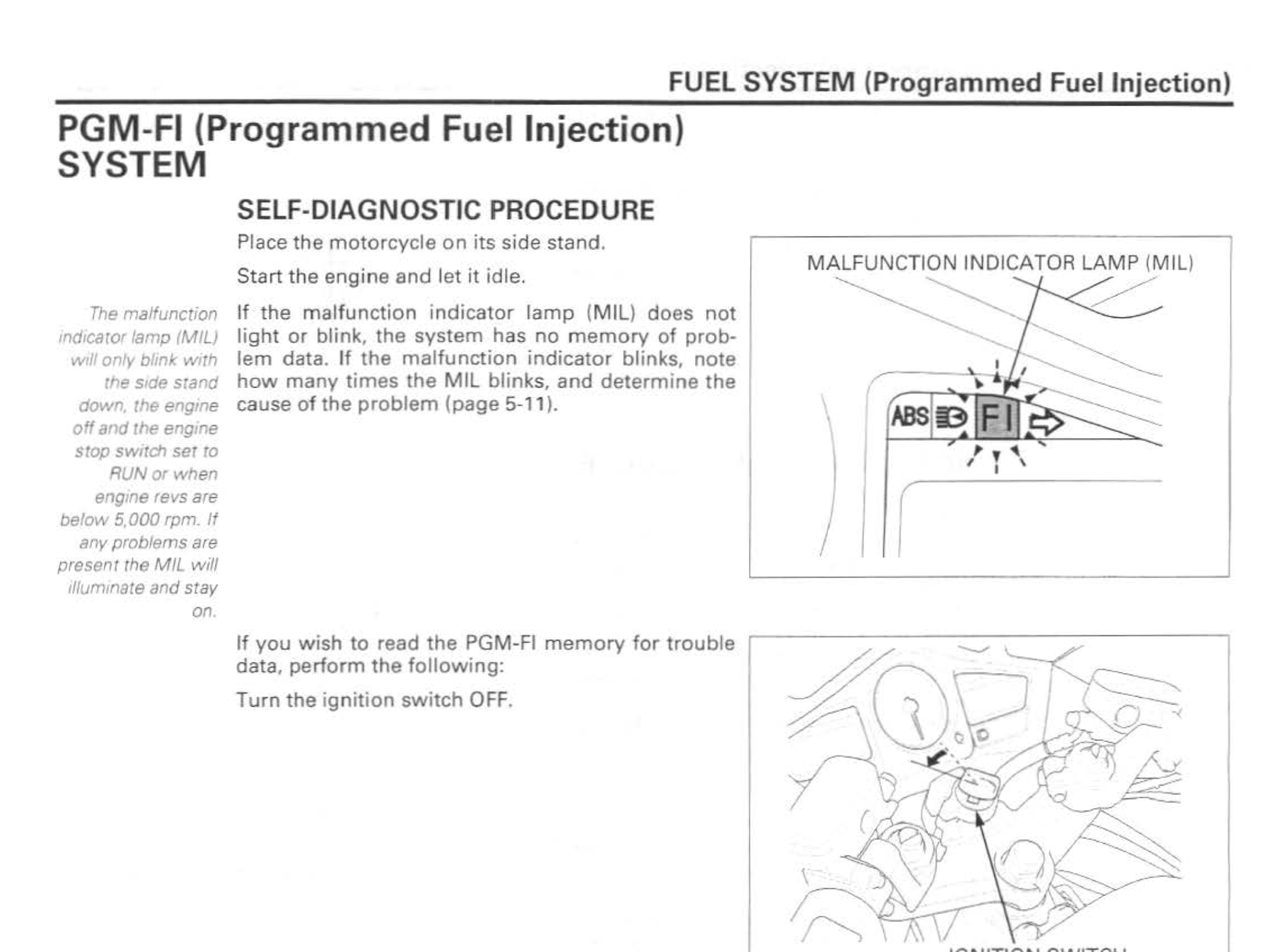

Member Contributer Grum Posted February 8, 2021 Member Contributer Posted February 8, 2021 Once your battery is fully charged. Go through the Flooded Start procedure a few times. Let's know how that goes. P.s. If you had any current EFI fault codes they would be displayed/flashing while your ignition is on with side stand down. 1 Quote
Member Contributer DannoXYZ Posted February 8, 2021 Member Contributer Posted February 8, 2021 19 minutes ago, Grum said: P.s. If you had any current EFI fault codes they would be displayed/flashing while your ignition is on with side stand down. Oh, no jumpering needed? I must be looking at wrong manual. Quote
Member Contributer Grum Posted February 8, 2021 Member Contributer Posted February 8, 2021 1 hour ago, DannoXYZ said: Oh, no jumpering needed? I must be looking at wrong manual. I remember doing starter valve synch on my 6gen. Because the MAP and IAT were unplugged during the process and my side stand was down, these error codes were flashing. Once the process was completed and the MAP and IAT were plugged in, there were no flashing codes (no current/active faults) and everything was normal, however, no doubt those error codes would have been stored and I could have retrieved or deleted them via the shorting link process if needed. 1 Quote
Member Contributer DannoXYZ Posted February 8, 2021 Member Contributer Posted February 8, 2021 49 minutes ago, Grum said: I remember doing starter valve synch on my 6gen. Because the MAP and IAT were unplugged during the process and my side stand was down, these error codes were flashing. Once the process was completed and the MAP and IAT were plugged in, there were no flashing codes(no current faults) and everything was normal, however, no doubt those error codes would have been stored and I could have retrieved or deleted them via the shorting link process if needed. Ah thank you! I don't have 6th-gen to play with, so just going by manual. There are numerous errors in manuals that's not updated with each new generation. Quote

Phye07 Posted February 9, 2021 Author Posted February 9, 2021 Hey guys, As always, thank you so much for your input and time. Your helpfulness is not unappreciated. It is welcomed. Firstly, To answer your question DannoXYZ, *I have since jumpered the ECU and retrieved the error codes. *I do not have a compression gauge. I did the old school trick of placing my hand over the intakes and feeling for compression. All suck down hard and effectively. *I have a good multimeter *No, I do not have an oscilloscope 👎 wouldn't know where to start with one. Secondly, I've run through all the error codes on the bike. Checked them against the service manual and they are what would be concurrent with everything that I had unplugged whilst doing the throttle bodies and testing. Noting out of the ordinary. If you'd like to know, they were: 1, 2, 7, 8, 9, 12, 13, 14, 15, 21, 22, 23, 24. Everything that would cause errors due to removing the throttle body and all the applicable sensors. Obviously while having power to the bike these have caused such error to the ecu. The fuel in the bike is good, it is pumping to the valves without interruption. The bike also hasn't fired since it first cut out completely last Friday. After it cut out, I then tried to restart it twice. That is when it had some coughing spluttering. But, since those first to attempts to get an ignition, there has been none at all. No coughs, no sputters, no firing of any sort there is no fuel smell in the exhaust. Well, that I can tell. It is super windy here and now also -2°. I am totally stumped. I guess it's time to call someone and shell out who knows how much? Quote
Member Contributer DannoXYZ Posted February 9, 2021 Member Contributer Posted February 9, 2021 We've just started to troubleshoot! 1 = MAP sensor connector issue or bad MAP sensor 2 = loose or leaking MAP sensor hose, or bad MAP sensor 7 = loose or poor contact ECT sensor connector, or bad ECT sensor 8 = loose or poor contact TP sensor connector, or bad TP sensor 9 = loose or poor contact IAT sensor, or bad IAT sensor 12 = loose or poor contact #1 injector connector 13 = loose or poor contact #2 injector connector 14 = loose or poor contact #3 injector connector 15 = loose or poor contact #4 injector connector 21 = faulty #1 O2-sensor 22 = faulty #2 O2-sensor 23 = faulty #1 O2-sensor heater 24 = faulty #2 O2-sensor heater I usually never run engine without everything completely assembled. So now ECU's way confused and is taking massive evasive action to compensate. Fuel-trim is probably maxed out super-rich. Ok, now that you've put everything back together, clear the codes and see what's left. Things aren't black & white with these things. We live in an analogue world with gradients. So get used to measuring and coming up with numbers. Exact values of those numbers point to where problems are. There's difference between 12.9v vs. 12.6v measured at battery. There's difference between 12.0:1 vs. 16.0:1 AFR. Here's an example. I got call from guy who's bike just quit on way home. Crank, crank, crank, would not run again. He pushed it back and started ripping it apart replacing plugs, wires, coils, battery, ECU, injectors, FPR, fuel-pump, etc. I asked him how much gas was in tank and he sent me picture of gas-cap!!! Not, "I just put in 15-litres 5-minutes ago" or "shows 1/4-full on gauge". Having numeric target would tell us he ran out of petrol. If you want to pay someone to do what you're going to do anyway, that's OK. They're just going to consult manual and reset codes on page 5-8, then proceed to measure voltages of various sensors, MAP and TPS being extremely important. Along with measuring vacuum going to MAP to verify it's actually reporting what it's supposed to. Or you can follow manual and do exact same testing yourself. Quote
