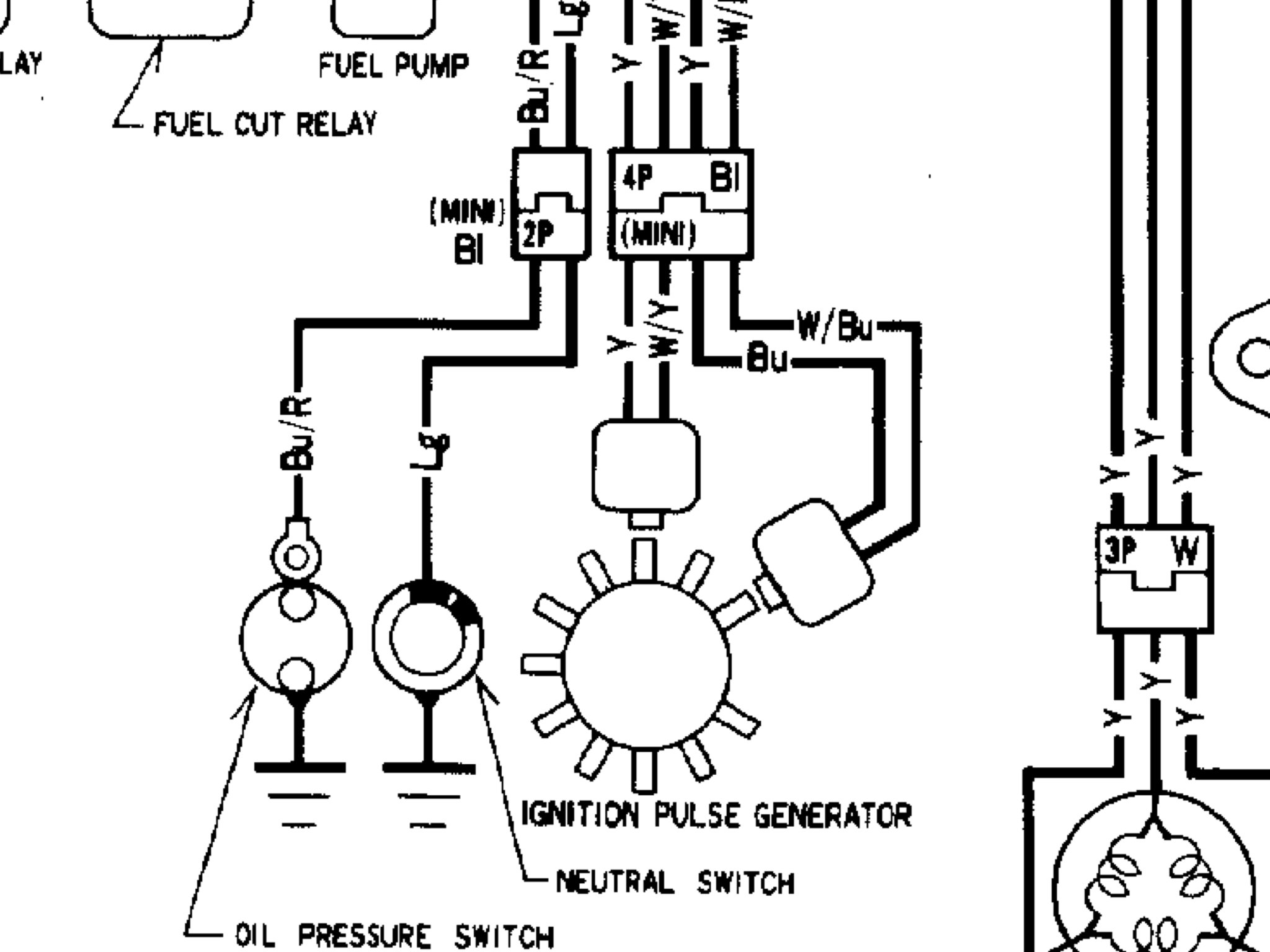

Hi Daniel.
The procedure for checking the Ignition Pulse Generators in the manual has a typo error.
Its states to measure between the Yellow and the White/Blue this is incorrect.
Should be Blue to White/Blue. 200 to 400 ohms.
And the other is the Yellow to White/Yellow. Again 200 to 400 ohms.
Refer to drawing attached.
Hope this helps
Cheers.

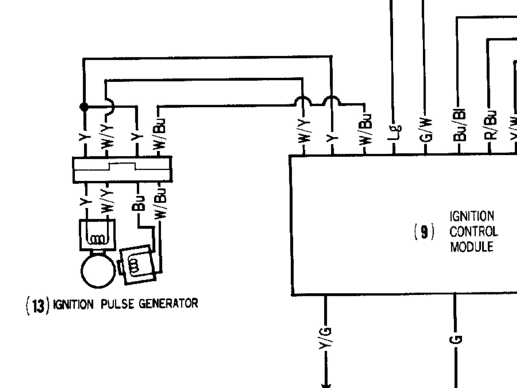

Are you measuring this with 4p plug still connected to the Pulse Gen Coils? This would explain your reading of 290 ohms.
From what I read, the coils need to be unplugged for this test, you are measuring the resistance of wires Yellow (common) to White/Yellow and Yellow (common) to White/Blue.
This is a measurement of the ICM internal resistance to these wires and you should have between 450 - 550 ohms for the two readings.
You have already confirmed both the Ignition Pulse Coil resistances are correct, and with the coils still connected it would be impossible to read 450 - 550 ohms in the above test unless they were unplugged to then measure resistance on the wires back to the ICM.
Hope this helps, also I don't have a 4gen. Just going by the circuit diagram and the test procedures!

if you unplug the connector to pickup-coils you can't measure them.
The idea is to unplug everything except what you want to measure. And you're measuring terminals at the ICM connector right? Not the ICM itself.
Note from diagram, that wire-colours change for pickup coil after connector. Best to do 2-readings, one at pickup-coils themselves and one at ICM connector to verify wiring in between.
Better test is to use oscilloscope to test output of pulse triggers at ICM connector. Do you have access to oscilloscope?
