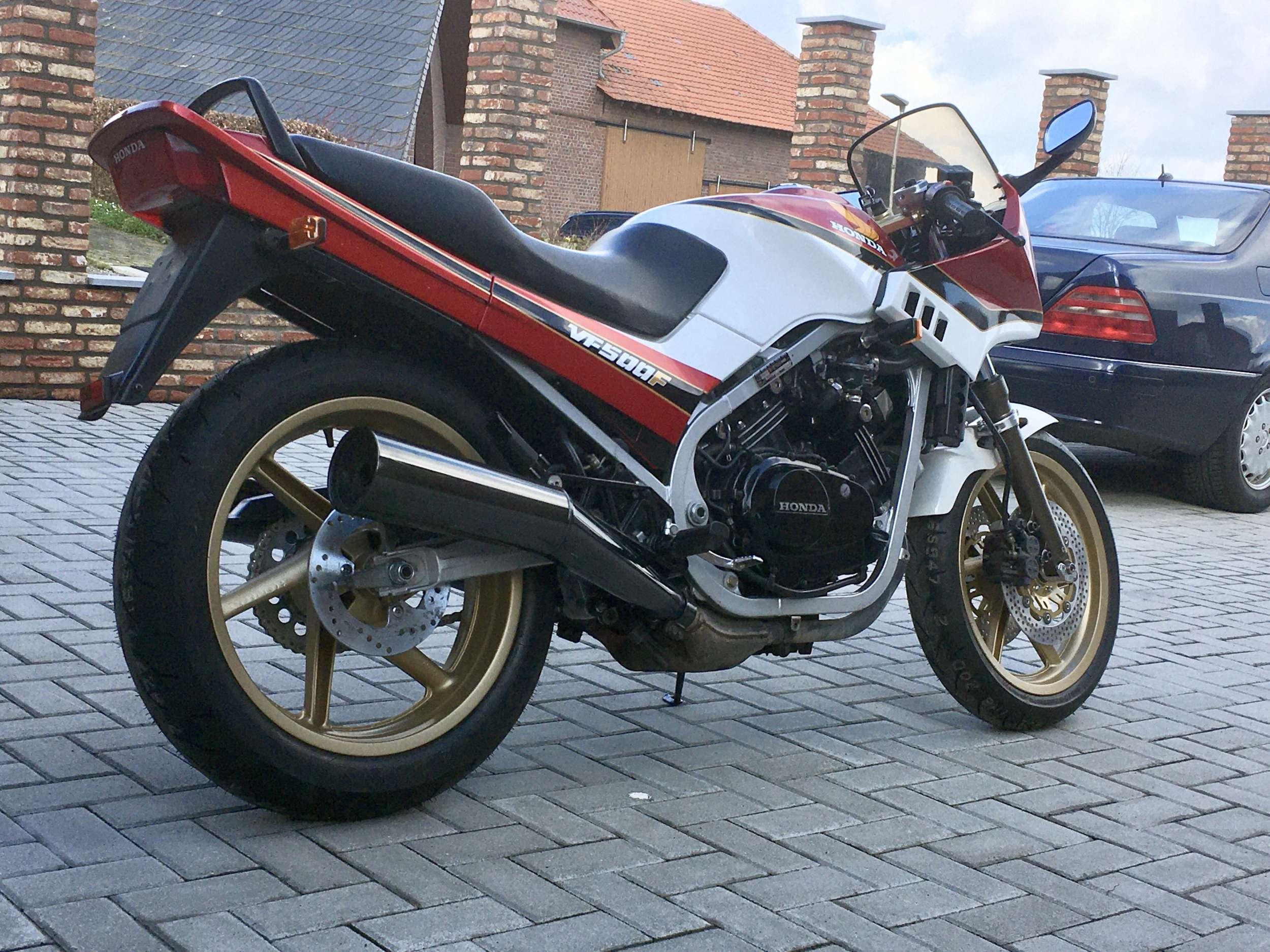

this winter I have started a little modification project on my VF500 dated from late 85.  My intention is to give the bike a more modern look and ride.
It should get the look Honda would create for a VF600F instead of launching the CB600F. But they did not so somebody has to do it.
Beside changing the wheels, the fork and brakes I have converted the instruments to the VFR400R NC30 clocks.
The speedodrive sprocket cover and drive was a mechanical job to do and works fine now.
The temperature gauge works as well but the tacho does not. It acts but shows only readings up to 2000 rpm, even when the engine is defintily reving much higher.
It seem that the tacho signal from the ignition box is different to the from the VFR400R....
Does anybody have an idea or a solution for this conversion?

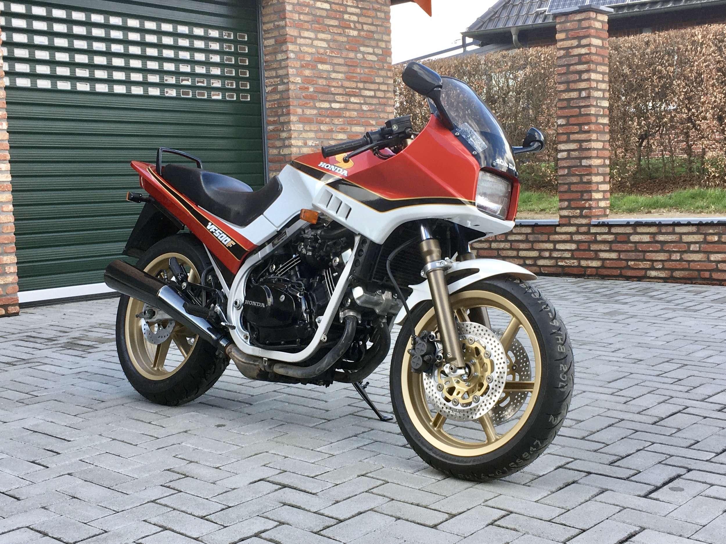

Ok I can show some more pictures but I would not deviate to much from my problem.....
What I have found so far is that Honda has different ratios for the tacho signal coming from the ignition unit. Similar to the mechanical speedodrives you find 1:2 and 1:4 ratios. No idea for the reason.....
For my problem it looks that the VF500 emits only a fourth signal of the VFR400 unit, or so.....?
And it looks not a good idea to transfer the internal from one casing to another. Does not look like a straight fit....

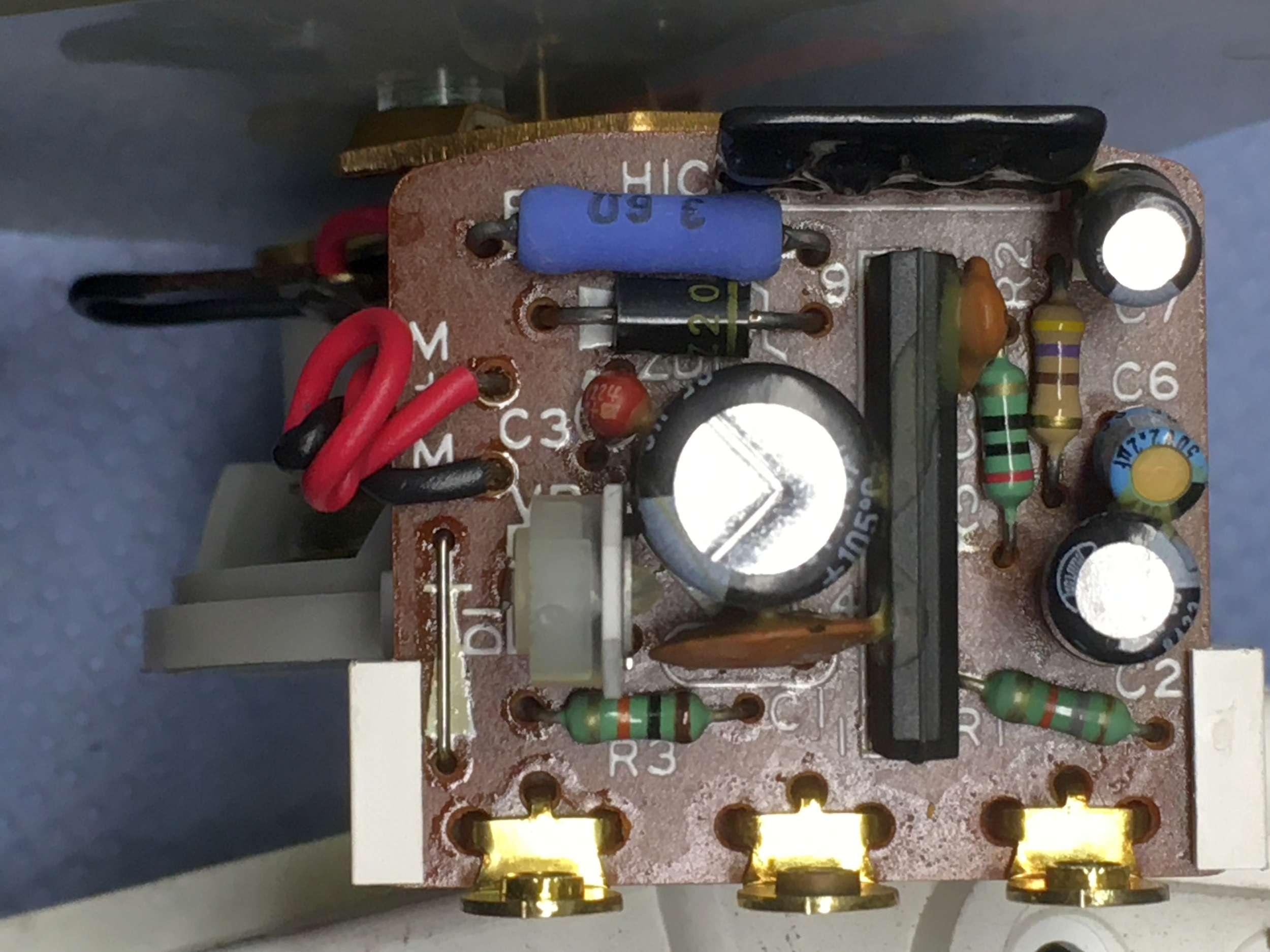

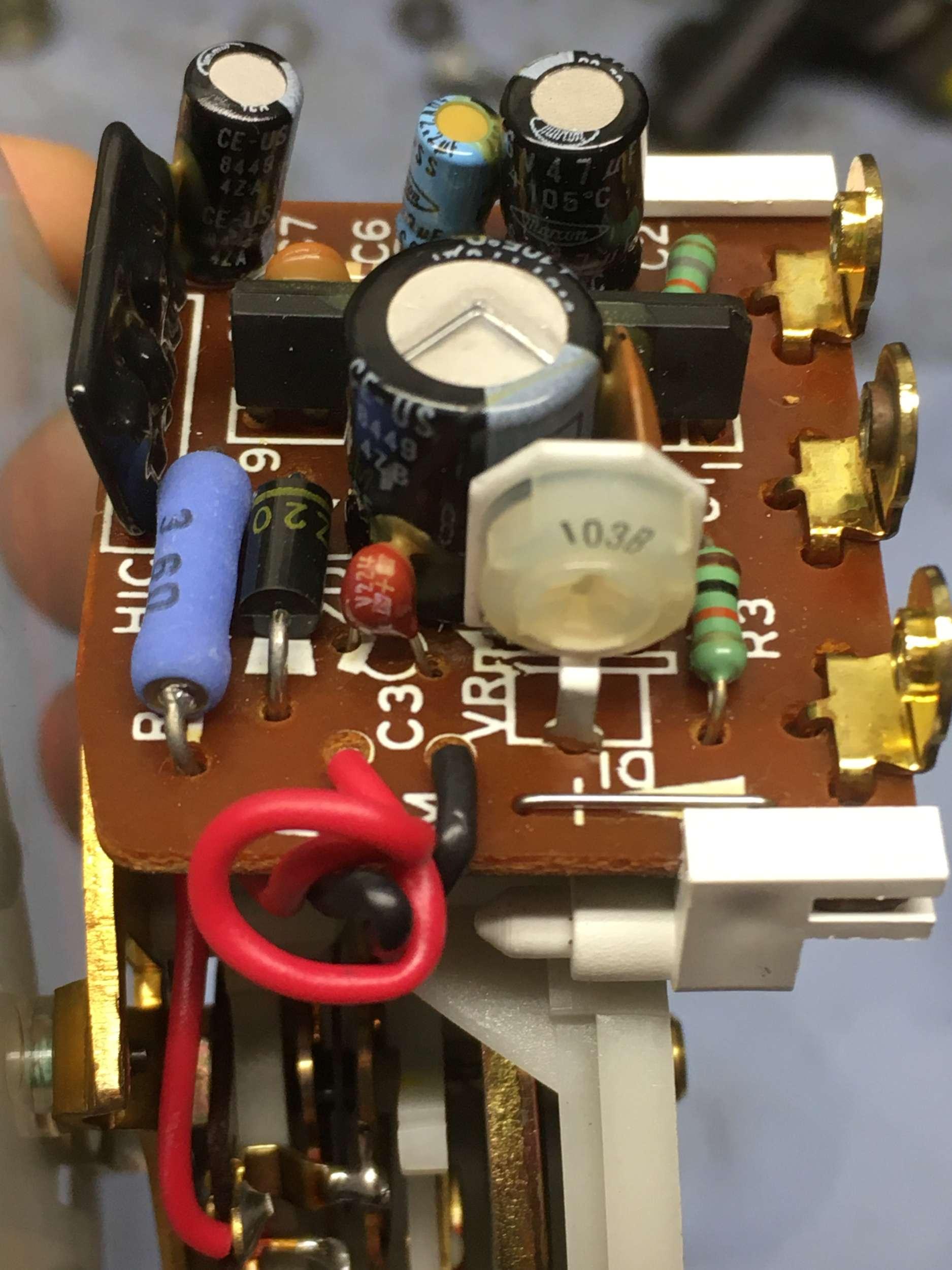

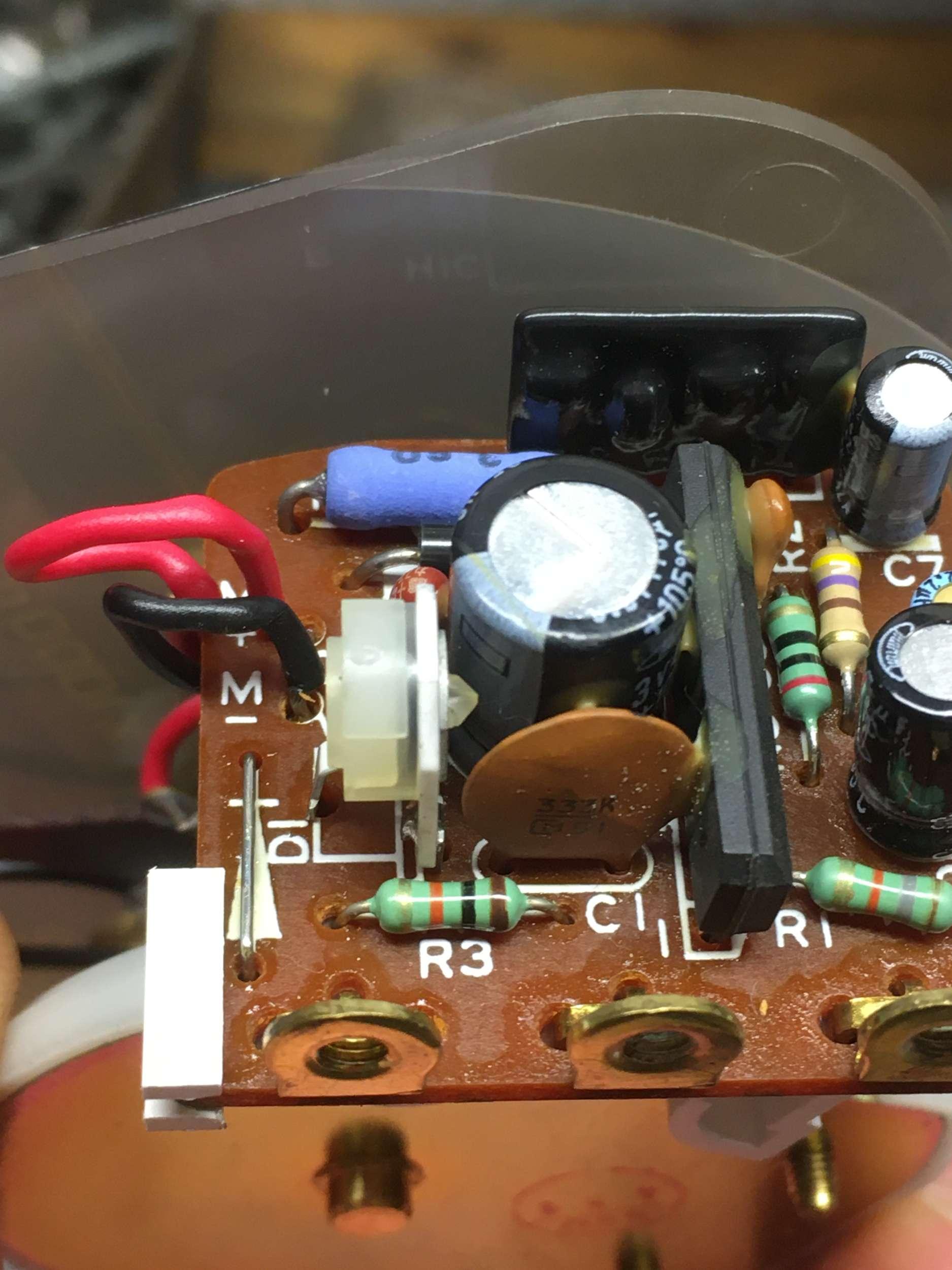

Meanwhile I opened the vf500 tacho to have a close look to the circuit board, see it on the picture.
1445486712_circuitboardvf500.thumb.jpg.4cff5685d55c5776f4538cb0085f8a76.jpgre.
The connector bottom right is the tacho input signal (yellow cable), R1 above is about 18 kOhm. Middle connector is ground (green cable) and left connector is 12V (black-brown).
Because of the 12 V source connector I would not expect a 5 V tacho input signal, but who knows.....?  The red and black cable go directly to the instrument coil.
The Arduino solution sounds easy but would take me to the next level. (I am still a mechanic related person).
But I can ask some colleagues in my office at work for support. They should know it when programming cnc controllers every day....    (o:
  • 0
I'm looking at that "R1" resistor and I can't tell which end is the gold band, so I can't tell which direction to read the colors, in the picture it isn't quite in focus and has some glare on it.  But if I read it right-to-left I get brown-violet-red-gold = 1.7kohms or if I read it left to right I get brown-red-violet-gold = 120Mohms.  So I'm guessing the gold band is at the left-hand end.
It would be informative to see the connecting traces on the back side of this circuit board.  I'm assuming the circuit board is probably a single-layer, but maybe a 2-layer board.  Is it possible to get a picture of the backside, or short of that maybe you could draw/diagram out what you see on the backside?
And what is the letter designation above the kinda transparent-looking item above R3?  I can guess the function of most of the other components but that one is a mystery to me.
And I'm guessing that the red and black wires at the left-hand side of the circuit board are marked M+ and M- (can't see the "-" below the lower M, but guessing it's there)?  Do these wires lead to and from the galvanometer (i.e. electromagnet) portion of the gauge?  And are they the only two wires that go there?
But yeah, very interesting just in this one picture.  For instance the resistor that is banded red-black-black-gold (I think it's marked "R5") is a 40 Ohm resistor which would be perfect for the job of reducing 12volt to 3volt in an application that is pulling about .25 amps.
  • 0
The first thing I would do is replace the 4ea Electrolytic Capacitors on the board, C2, C6, C7 and whatever the large one is, especially the low valued ones like C6 which is a 2.2ufd 50v.
Being a 1985 device these capacitors are at least 35 years old, they tend to internally dry out and loose their capacitance and can become resistive, in other words, stuffed!
 Their values will be printed on them as per C6. Make sure your new ones are all 105degC temperature rated and the same capacitance value, you may probably be supplied with higher working voltage ones but that's fine, but NOT lower.
Before removing the capacitors MAKE SURE you note where the negative leg of the capacitor goes as they are polarity sensitive.
Any good Electronics Parts supplier will have these capacitors.
Also make sure there are no cracked or poor looking solder joints on the other side of the board. Good Luck, hope this helps.
Hi Greg.
The device is a potentiometer or variable resistor. I'm guessing it would be used to calibrate the instrument, it's possibly labeled as VR1.
  • 0
4 hours ago, Grum said:
Hi Greg.
Thanks Grum, now that you say it I can easily see the "V" in "VR1" in the picture.
I was thinking there would have to be a potentiometer included in this circuit board as there would be the need to do a bench-calibration of the completely assembled tachometer circuit board.  This post-assembly calibration would be necessary for quality control (with pass-fail evaluation criteria) and a fine-tuning calibration effect for the circuit boards that fall within the "pass" level of quality control.  This would compensate for small variations in the resistors, capacitors and such.
I can imagine the technician, sitting there with a pile of these circuit boards, hooking one-after-another into to a purpose-built bench testing unit that puts a set of controlled inputs into the circuit board and shows the results on something like an oscilloscope and/or voltage meter.

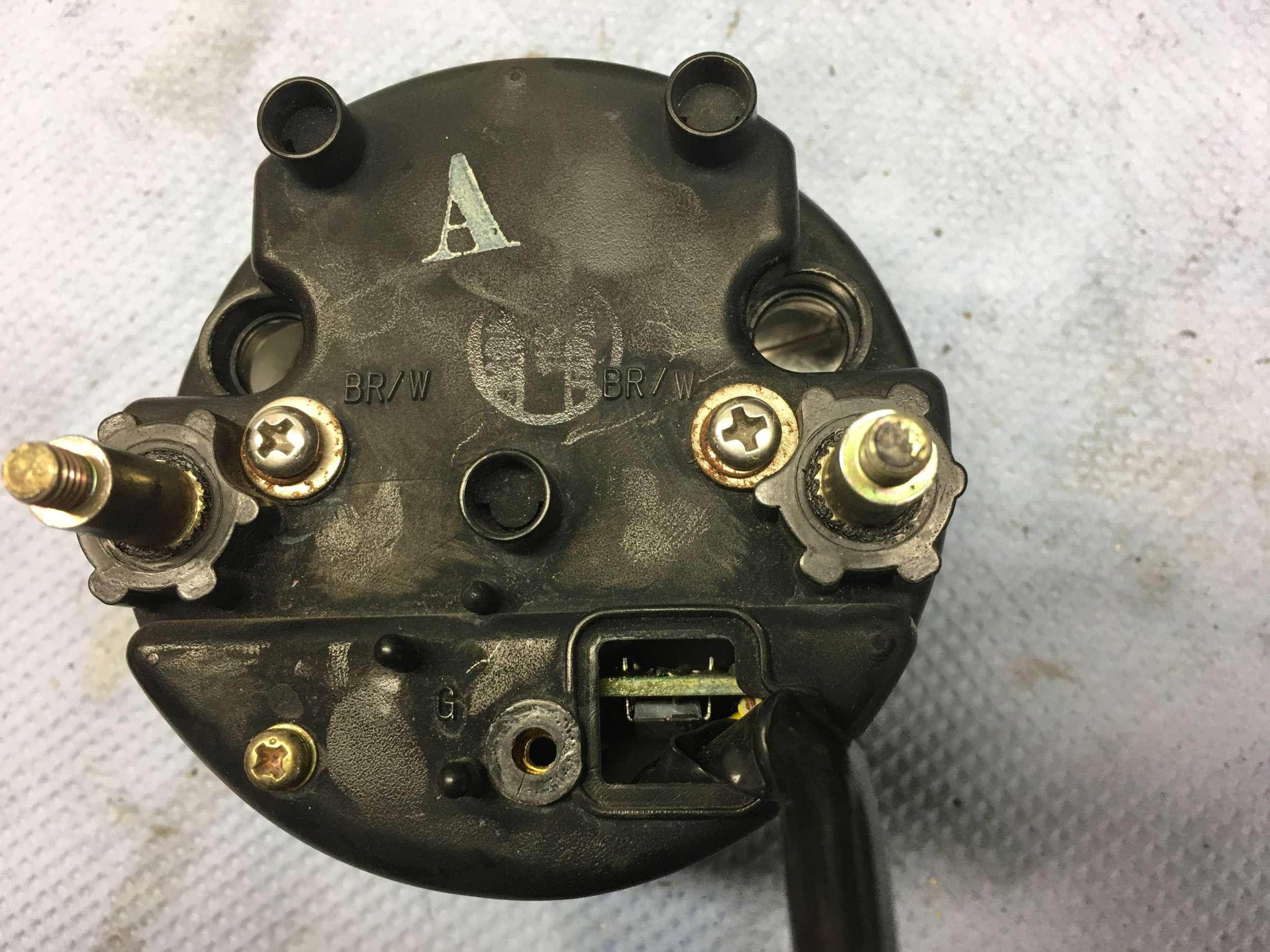

The pictures are only from the VF500 instrument but I will use the VFR400 clocks. The 400 tacho I will open when a solution is coming closer.....
Grum you are right that those capacitors are quite old, but this instrument was working fine before dismantling. But I will have think about your advice when working on the 400 tacho board....

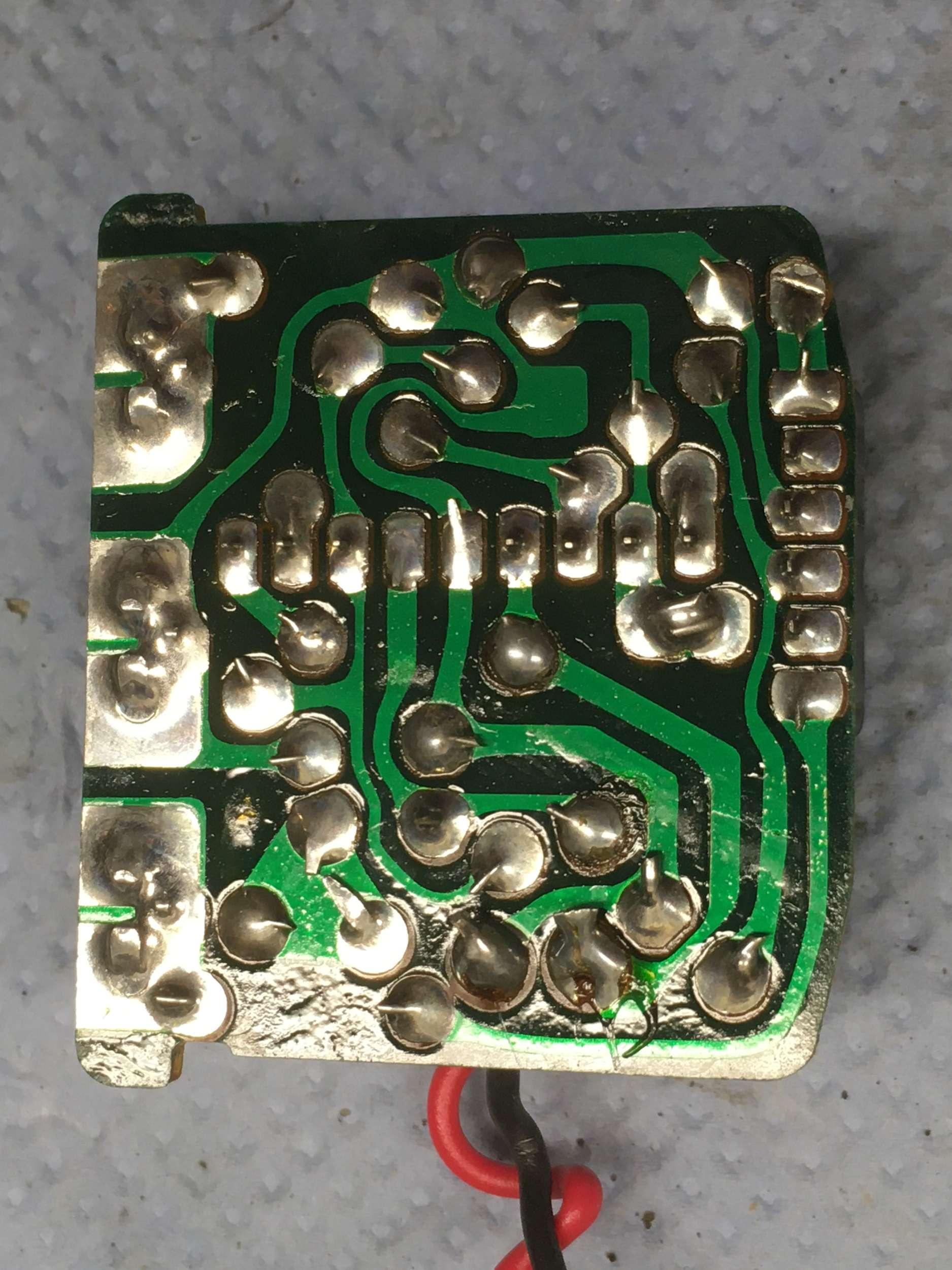

Gregs suggestions are correct and there is a potentiometer in clear plastic.
I did (can) not read the resistors markings, I have simply measured the resitance with a multi meter.
The bottom picture shows the connections and it is only a one layer board. So no secrets in between layers. Tacho signal input is left side top.

After looking at the traces on the backside and seeing how the components are placed on them I've learned a bit.  On this VF500F tachometer circuit board it's obvious that the input wire from the Ignition Control Module is used as nothing more than an input to the Integrated Chip, it only connects to the long black item labeled "I" in the middle of the circuit board after going through the 1.7K ohm resistor.  The 12volt connection wire is what's metered through to the galvanometer based on the frequency of the Ignition Control Module wire.
Will be interesting to see if the NC30 tachometer circuit board runs the same sort of setup.
If it does use the same setup the only problem will be getting either: 1. a matching the voltage that an NC30 Ignition Control Module would put on the input line or, 2. If the VF500F and NC30 input line voltages are close together, simply change the resistor it's connected through in order to put through the proper voltage to the Integrated Chip.
  • 0

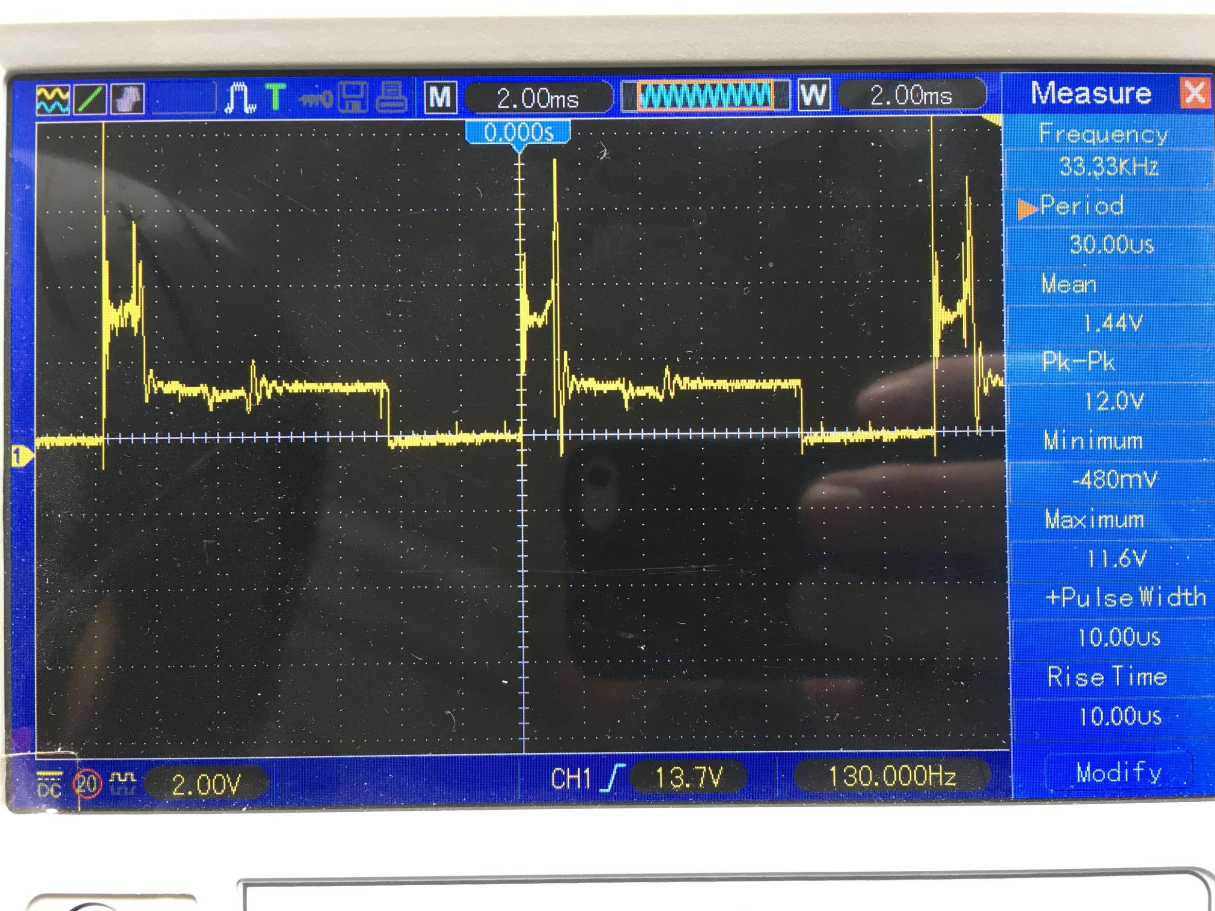

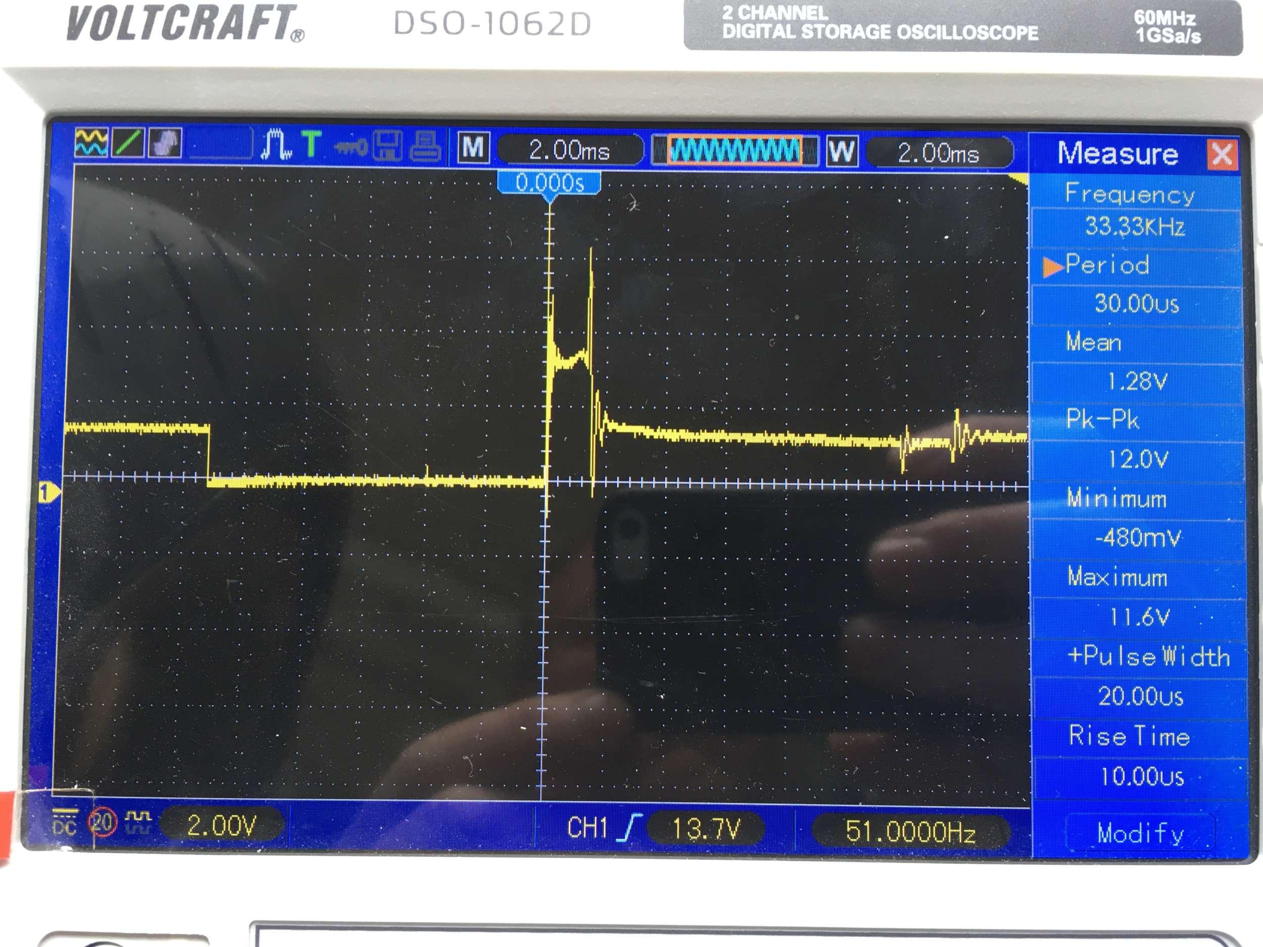

I did an oscilloscope check of the tacho signal when the engine is running. The signal is generated from the vf500 ignition module while the vfr400 tacho is connected.
The oscilloscope pre-setting is something new to me, but I think I could achieve what I expected.
A stable tacho signal of 12V and 30µs duration (33.3kHz). But the signal frequency related to the engine turns is interesting. It shows about 50 Hz at normal idle speed (around 1200 1/min ) and 130 Hz at high idle (est. 3000 1/min.)
Normally I would expect 1200 / 60 = 20Hz in case of a wasted spark ignition. Or half the amount 10 Hz at exact iginition timing.
What I see is about 2,5 times more tacho signals than expected ??
It seems that the vfr 400 tacho is expecting even more signals/engine turn which results in a reading of very low numbers of revs./min.
Any ideas?

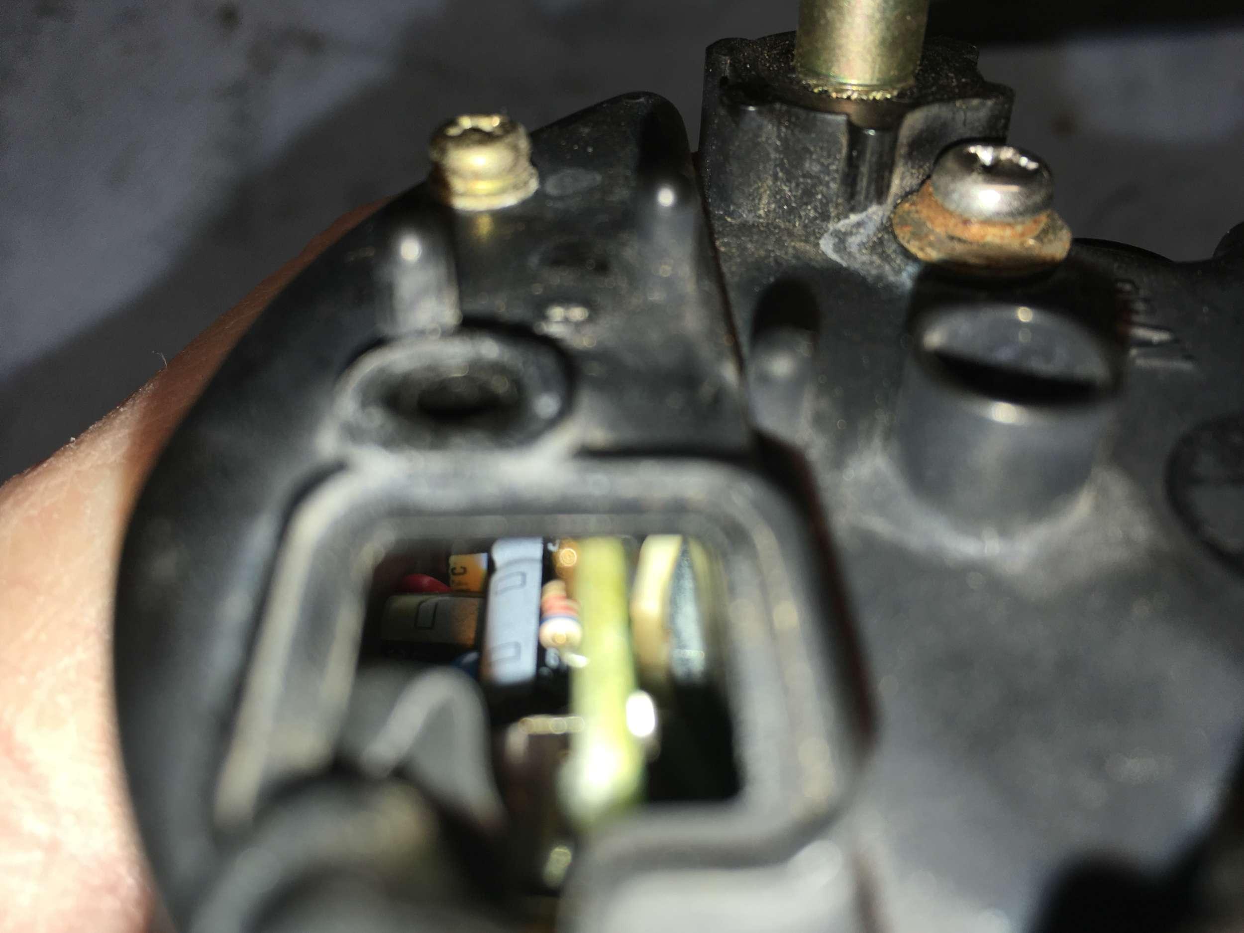

I am bit shy to open the vfr400 instrument because the bezel is curled to the instruments cup and might be destroyed when opened. That would solve my problem in different way....
Through the connection hole I can see the circuit board which is different to the vf500 board. There is a more modern IC and again some capacitors and restistor. But I can not identifiy anything inside.
For me it looks as the only chance is to exchange the vf500 ignition module to a vfr400 module? Or ask at v4-spark.com for support......
