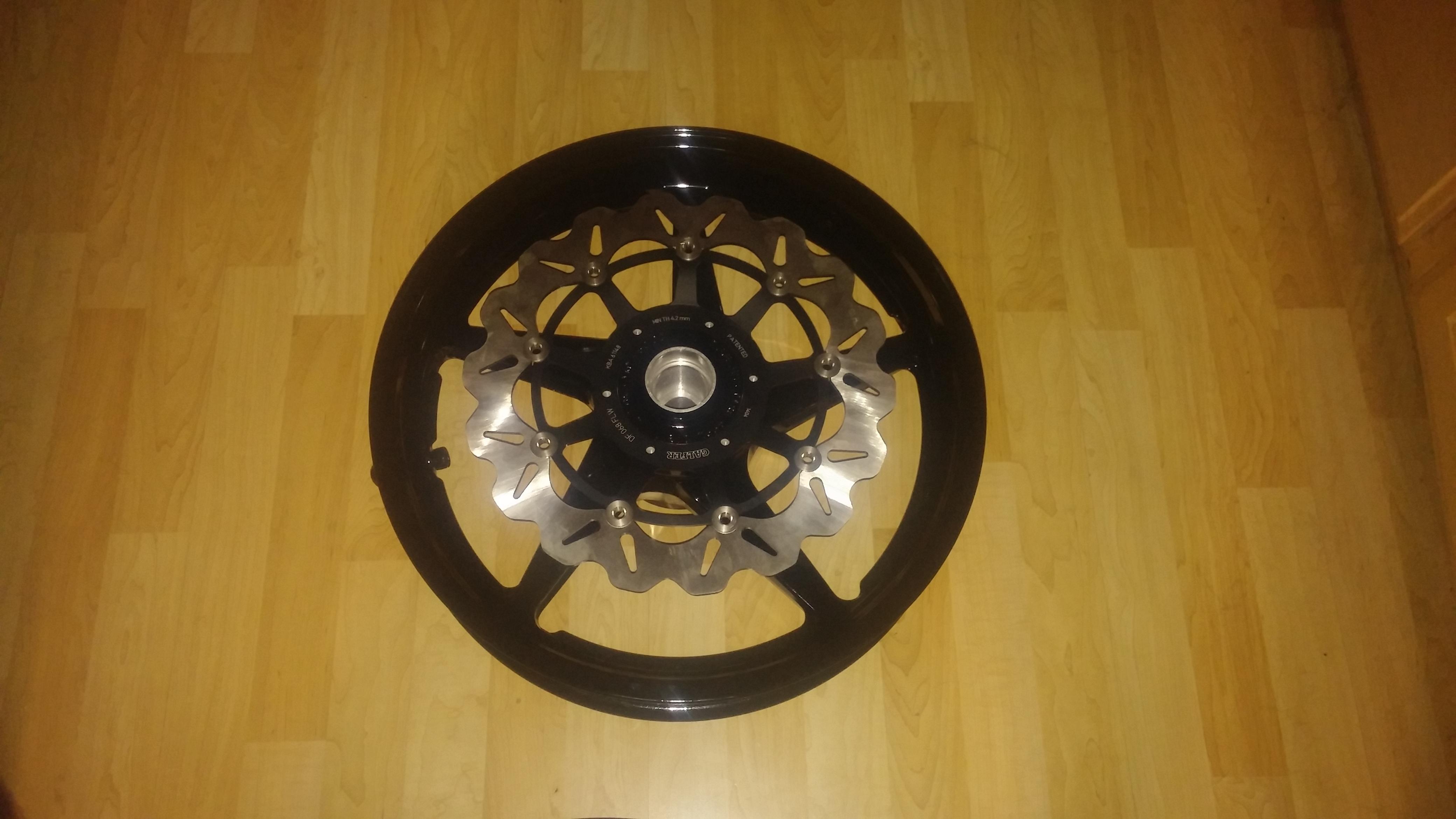

I bought Galfer, as I found one on Amazon for $75, but had to pay full price for the other ~$275. I ended up using them on my RC51 instead, as they do not have the ABS mounting holes. The EBC are the cheapest, unless yo go with Bike Master or Arashi, which I'm sure are both from China. Braking sells a set too, but they are almost $500 for the pair....expensive, but better than the $700 for the stock versions...
Be careful, as I found out with mine, even though they say they fit the 1200, you may have to drill ABS ring mounting holes, which is simple, but should fit the bike as stated...
