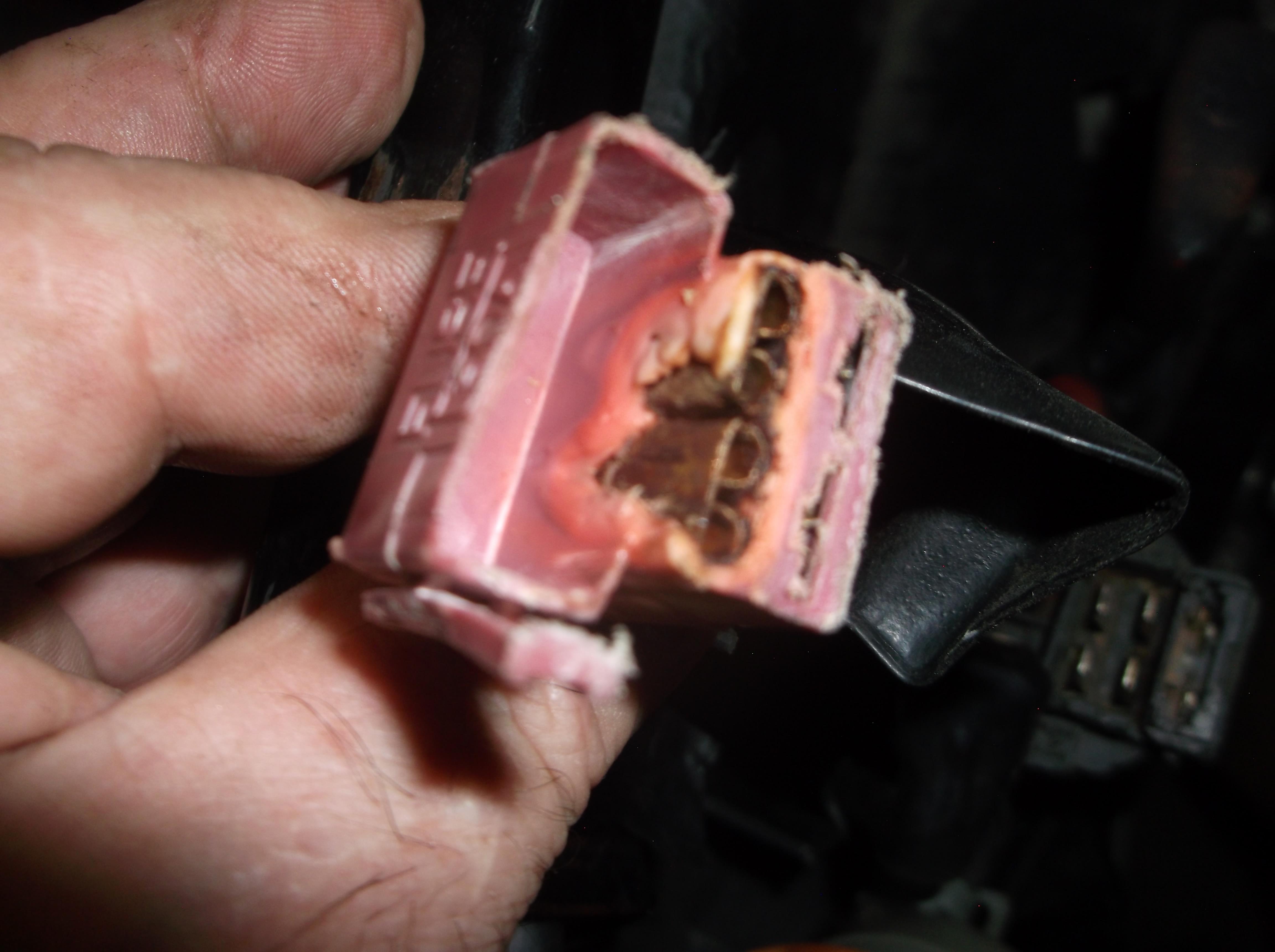

red plug on the starter solenoid needs constant inspection as they usually melt a lilttle or a lot and will reduce charging.
first signs of failure

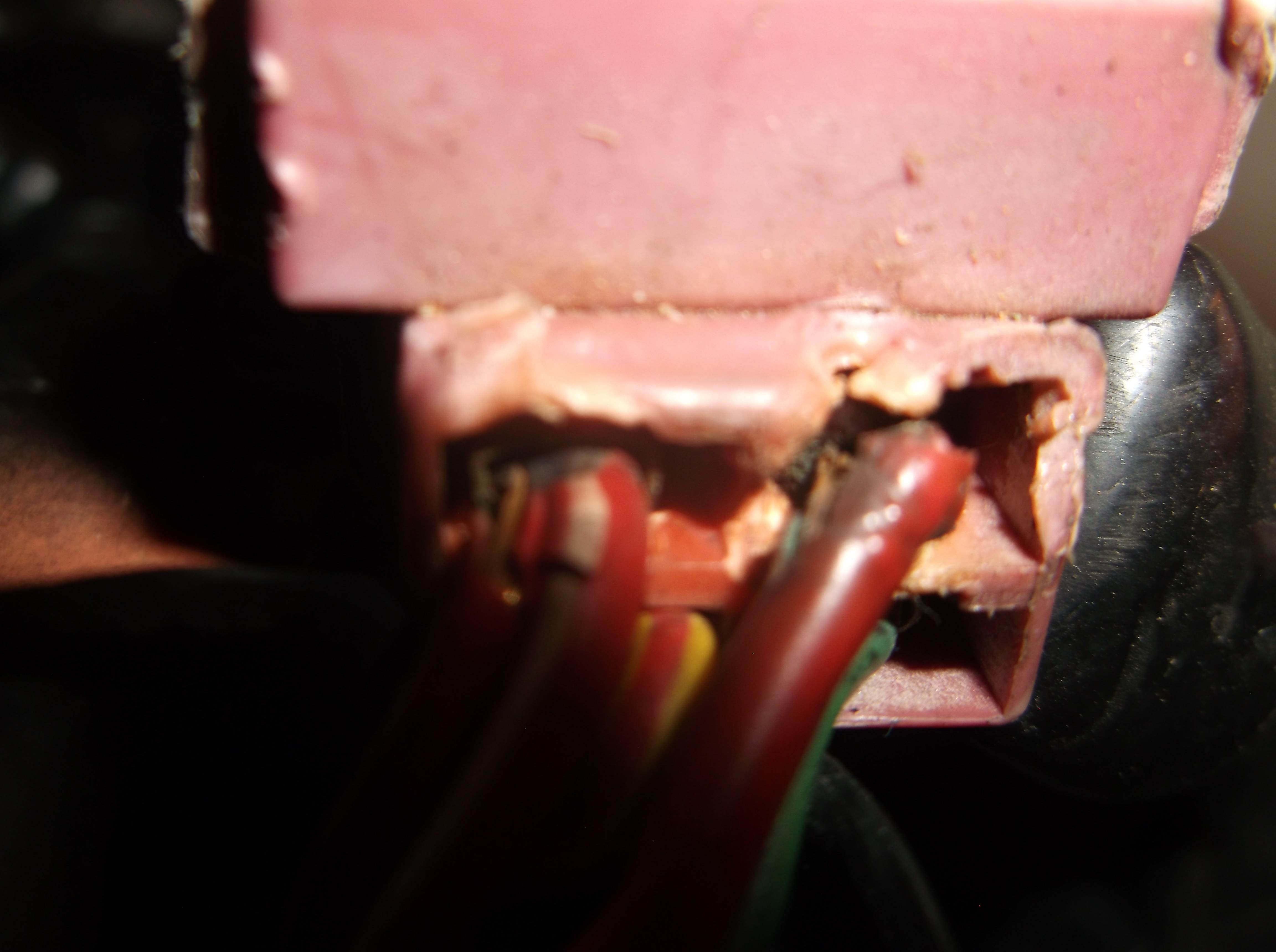

advanced failure

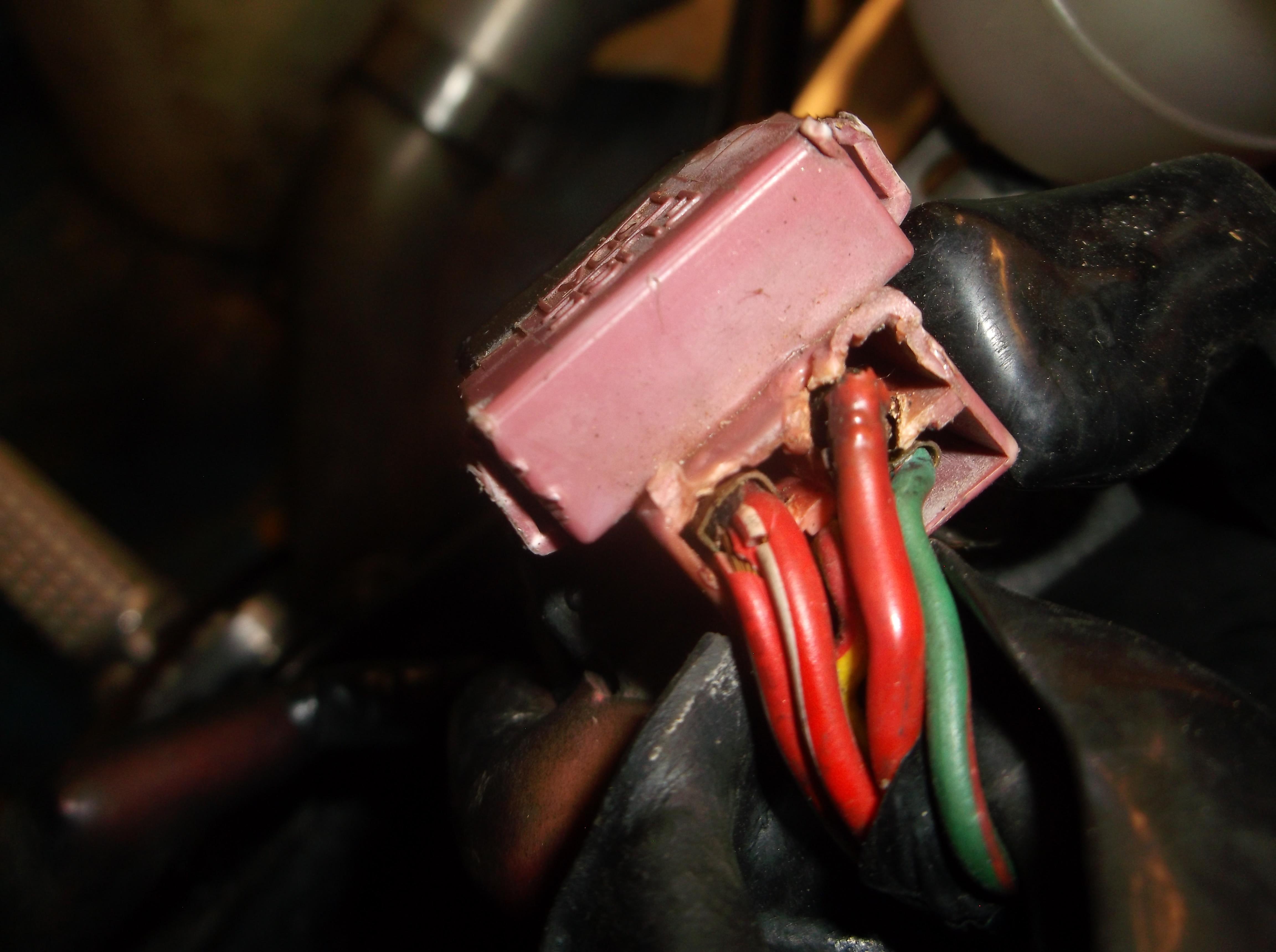

total failure

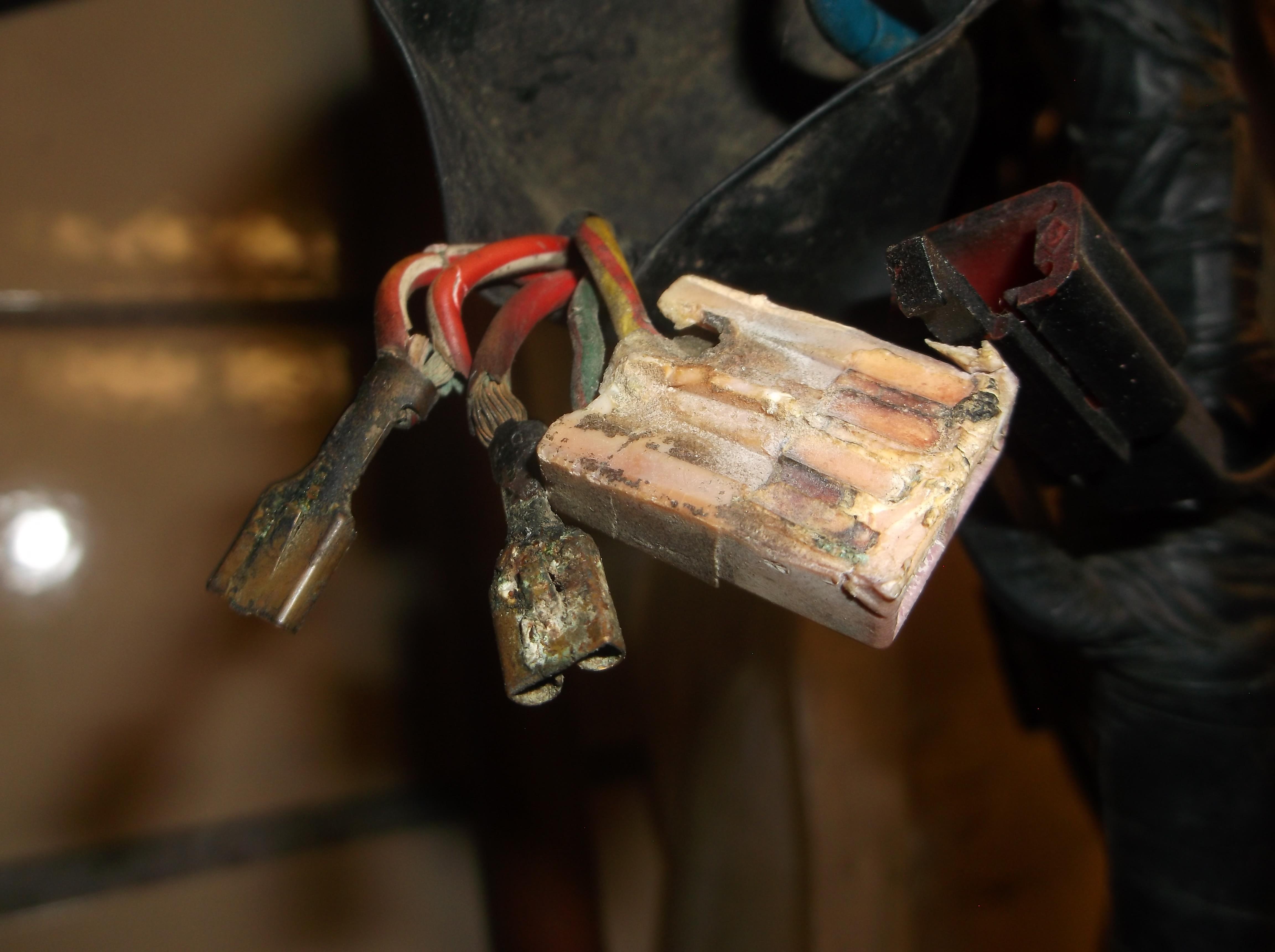

total meltdown

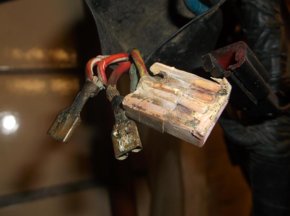

one way to fixit
