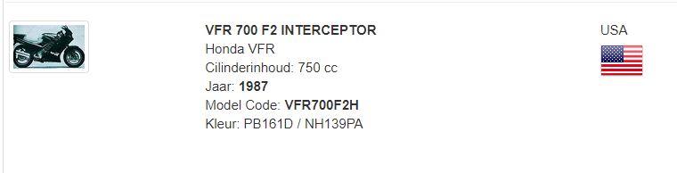

No red "kleur" in 87
States got 2

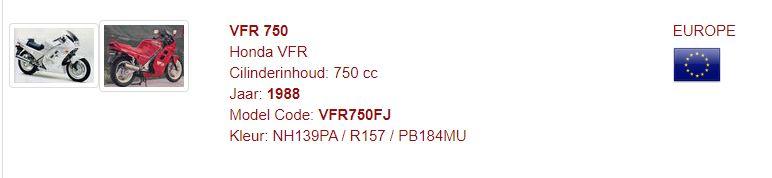

The 88 did see red :tongue:

For 1987 U.S. market there were two colors:
NH139P = Pearl Crescent White
PB161 = Candy Wave Blue (paired with a grey, but don't know that code)
The issue is that those codes are irrelevant today, according to my paint supplier. They don't translate into modern paints. You have to spectro-match the color and then physically tweak it to get as close a match as possible. Or, find a modern car/bike color that is close and use that code as a starting point. I've been through this a few times in recent years.

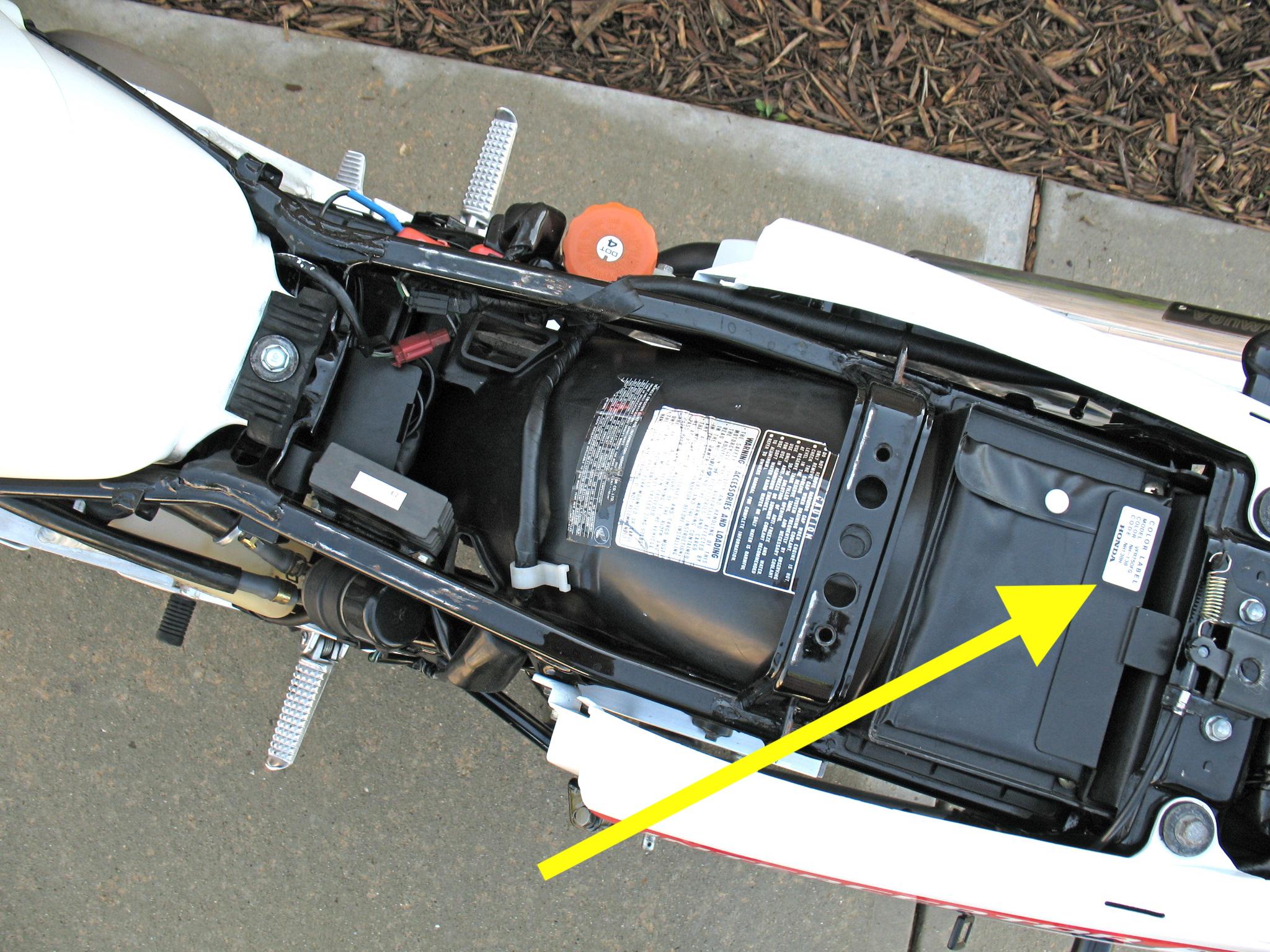

Here's the code sticker location:
