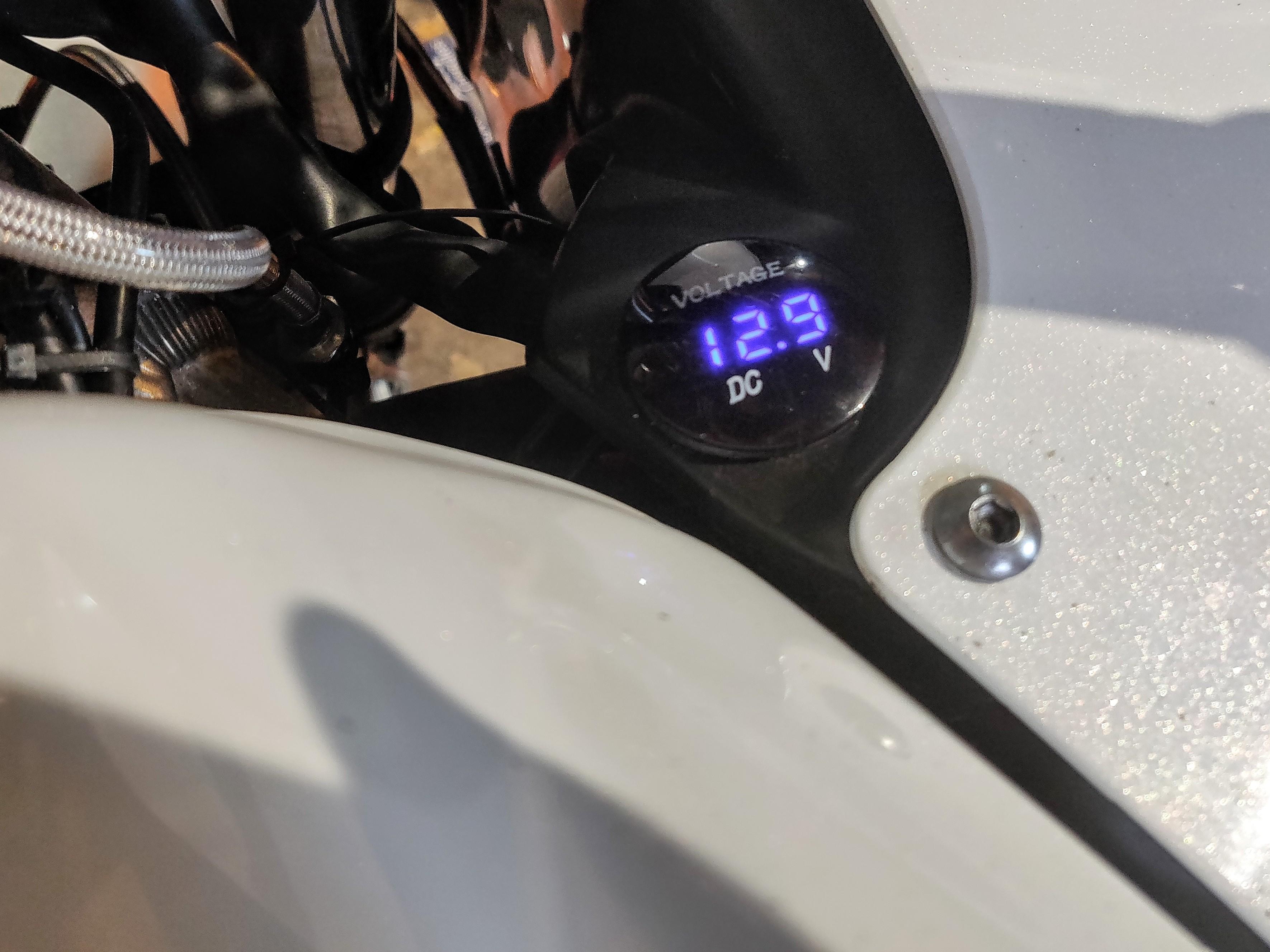

Member Contributer Marvelicious Posted July 2, 2019 Member Contributer Posted July 2, 2019 A simple and cheap option would be to add a voltmeter. I'm really happy with this little guy so far. Install was a breeze - popped the trim off and drilled it with a unibit, tied the positive into a keyed 12v source (I forget which) and a ground to a nearby bolt. It's simple, it's unobtrusive and it was under 10 bucks... https://www.amazon.com/gp/aw/d/B01HO50AJE 1 Quote

Member Contributer Marvelicious Posted July 2, 2019 Member Contributer Posted July 2, 2019 32 minutes ago, Bubba5000 said: Nice. They make one with USB ports too. That looks pretty cool. Sure, that way, I’ll know right away when the R/R fails again. Great idea. I thought about that one, but I had a couple of issues with it. First, it's taller and I didn't want to have to think to carefully about location. Second, you notice it has a rubber cover? So that leads me to assume it isn't waterproof without it, which leads me to the conclusion that it's worthless in bad weather. 1 Quote
mello dude Posted July 3, 2019 Posted July 3, 2019 Agree with adding a voltmeter... There are 50 ways to do it, and there is a good thread on "show us your voltmeter install"... I did a search but couldnt find it. With the OEM R/R your gonna need it... 1 Quote
