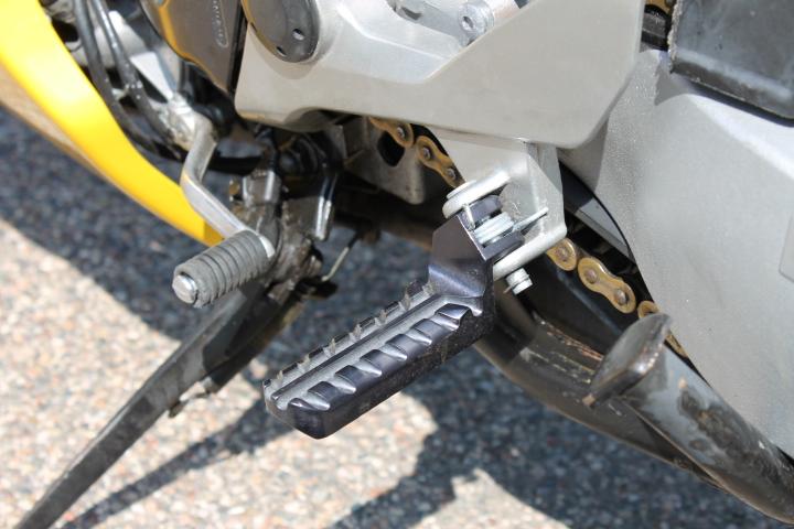

Although it does not show the sidestand up, the pic below might help.

You mentioned lowering blocks, but the pic above doesn't have the blocks. It instead has the KD pegs. Did you mean the 2000 you used to own had KD pegs and you noticed no interference with the tang?

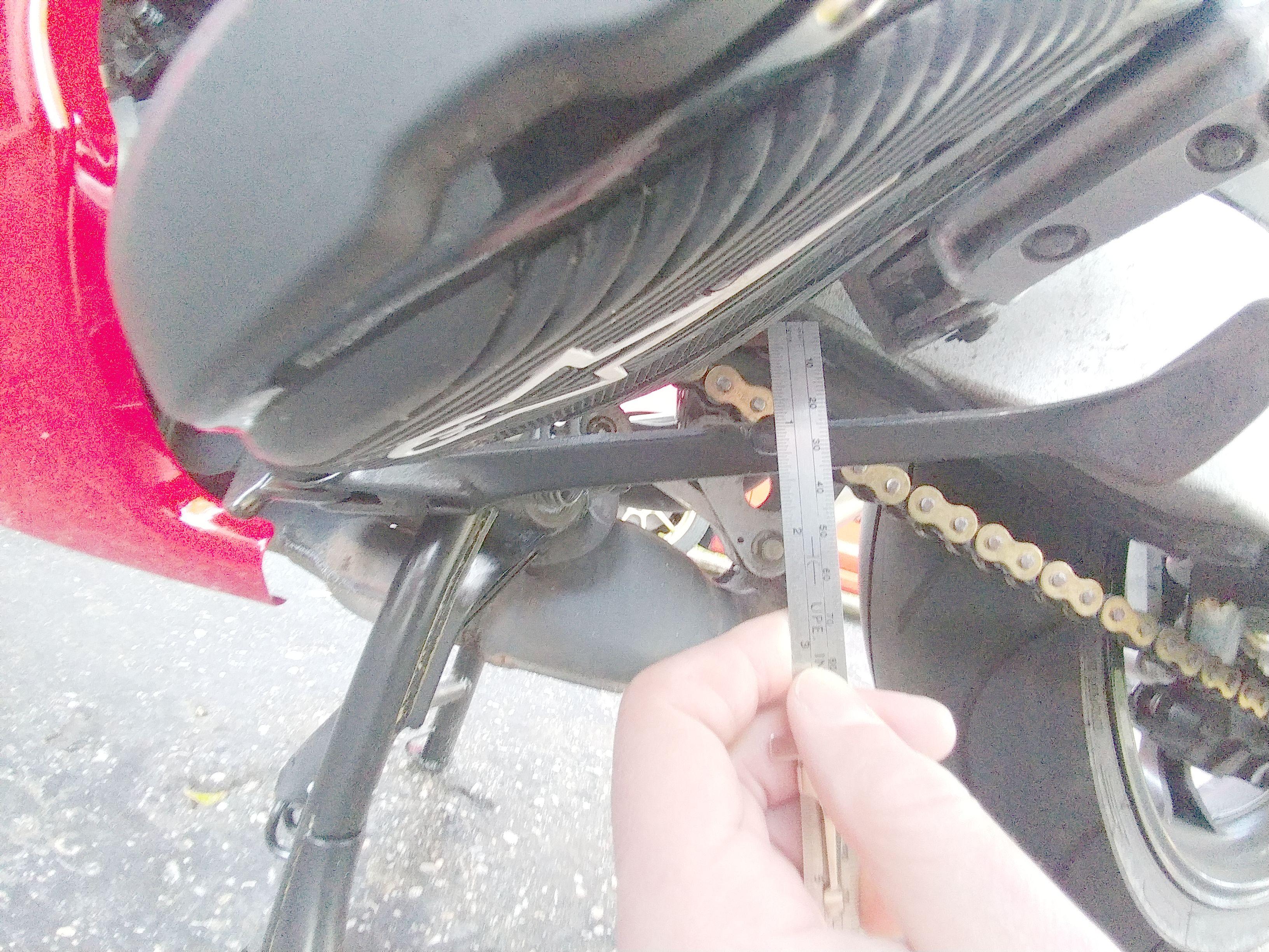

I took a pic today to better describe my concern. In the picture below, which is with the stock setup, I took my boot and placed it on the peg with the shift pad of the boot just under the shift lever rubber. There is a slight upward torque on the boot to ensure it is snug against the shift lever. If you zoom in on the scale in the pic, you can see there is approximately 7/8" between the top of the tang and the sole of the boot. Now if you lower the peg 1-3/8" as Knight Design claims and you lower the shift lever a similar amount, it stands to reason that your boot can hit the side stand tang. Now I realize that you may not necessarily lower the shift lever the same amount as the pegs, but tang contact with the boot still seems possible, perhaps likely. What my picture does not capture is what actually happens dynamically, i.e. in actual usage. It is possible one's foot isn't that far inboard when shifting. If contact does occur there are things you can do, such as bend the tang, trim the tang, or add a spacer to the stand's stowed position travel stop, but I'm just wondering what the actual users are experiencing in regards to this.

You are correct. I'd misremembered the name.
