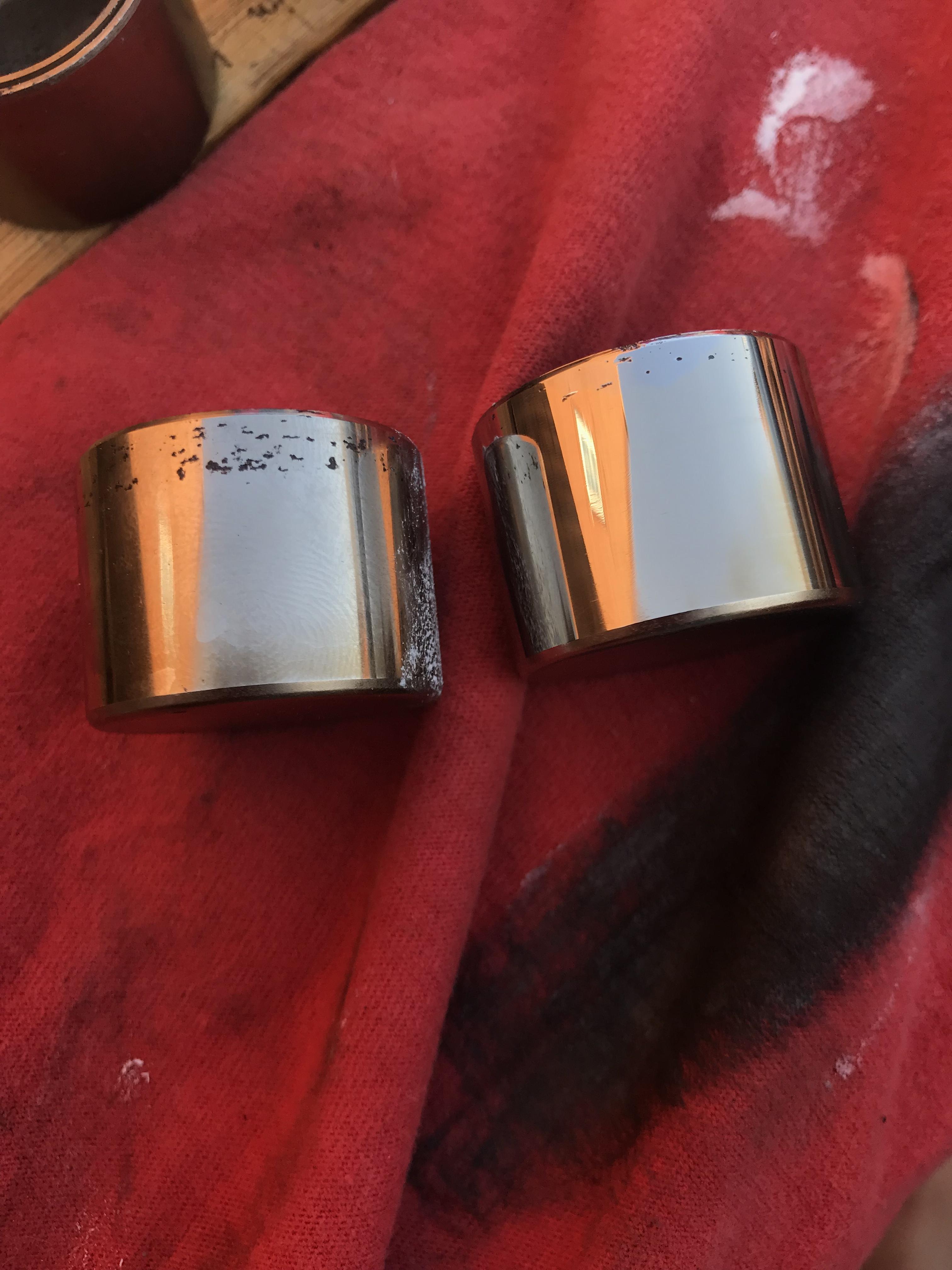

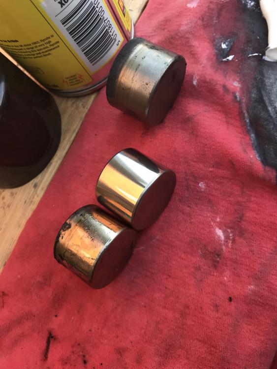

Pistons removed and you can see the corroded/filthy bits on the exposed portion of the piston lip. The exposed takes all the hearing/cooling/salt spray abuse and are not protected by the caliper. No surprise they look like sh!t.
Dirty pitted one on the left. Polished one on the right. Pitted big piston on top.

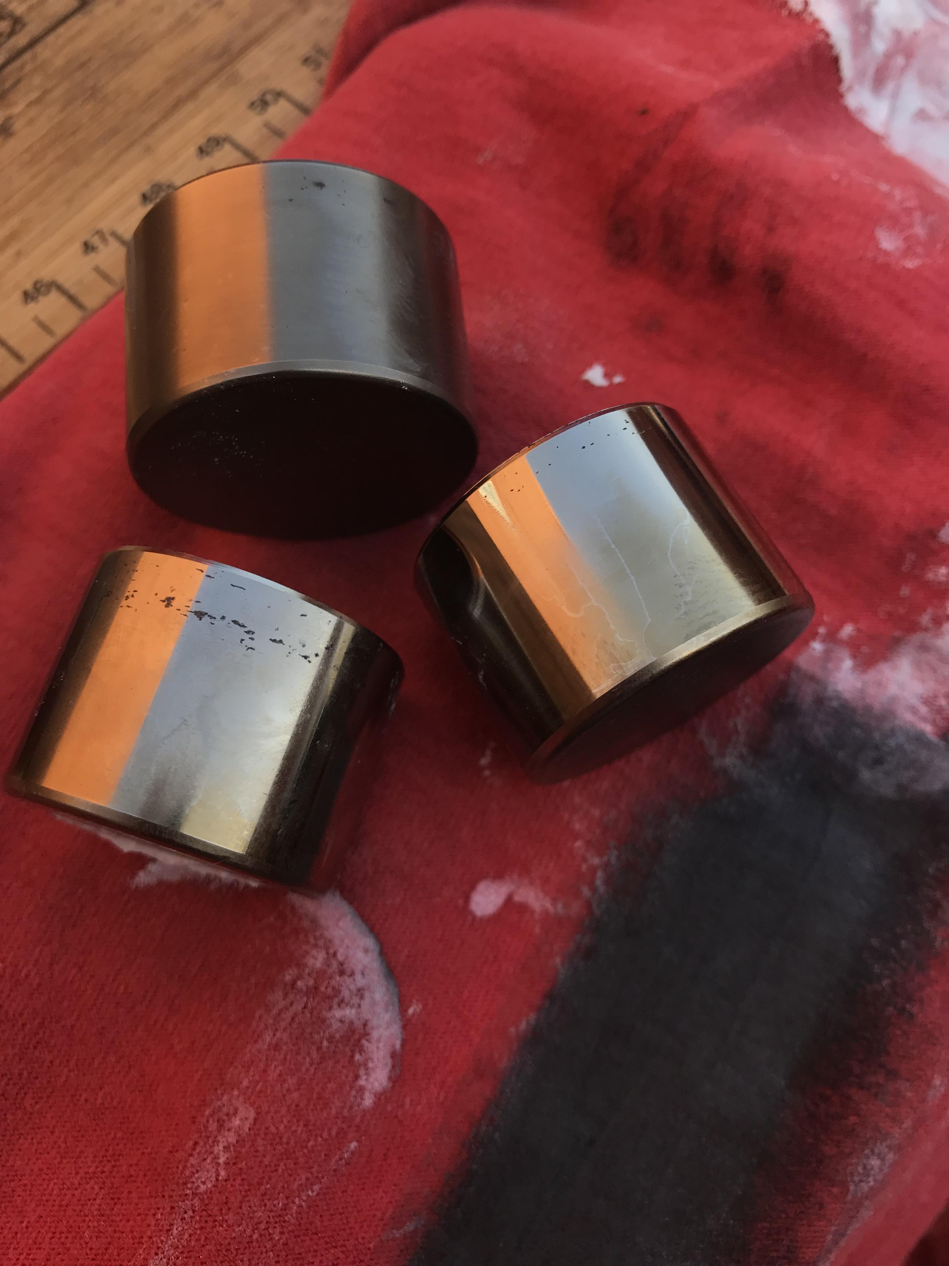

Method: lay some old material (denim works best) on a flat surface, apply some metal polish (I used Autosol) and rub the piston up-and-down along the corroded section. See the black streak in the picture above.
This is really smooths down the burrs and the phosphoric acid in the polish helps the newly exposed metal form a protective oxide layer.
Pitting will never be completely removed but it certainly gets smoother. Piston on the left was dangerously pitted and could easily have ripped a seal if pushed into the caliper. Now it is brought back into serviceable shape.

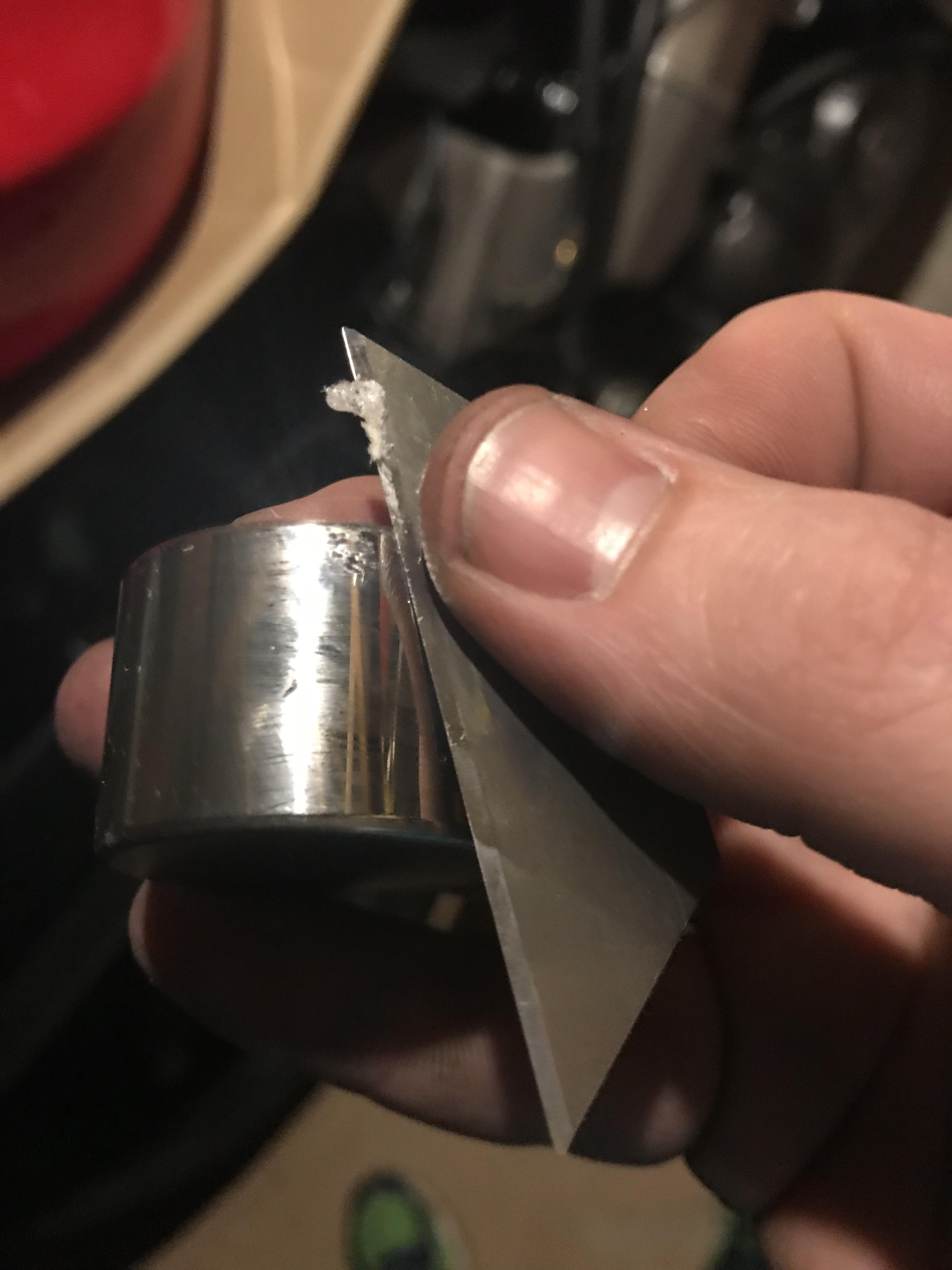

Next, clean off the polish residues with brake cleaner and apply a dab of superglue on the worst pits. Superglue will adhere to the new oxide layer (and any remaining rust) to protect the areas where chrome has failed.
Let the superglue dry for at least an hour as it takes ages when left open like this. Then run a new razor blade over the glue to remove the blobs that stick out. Scrape it both ways.

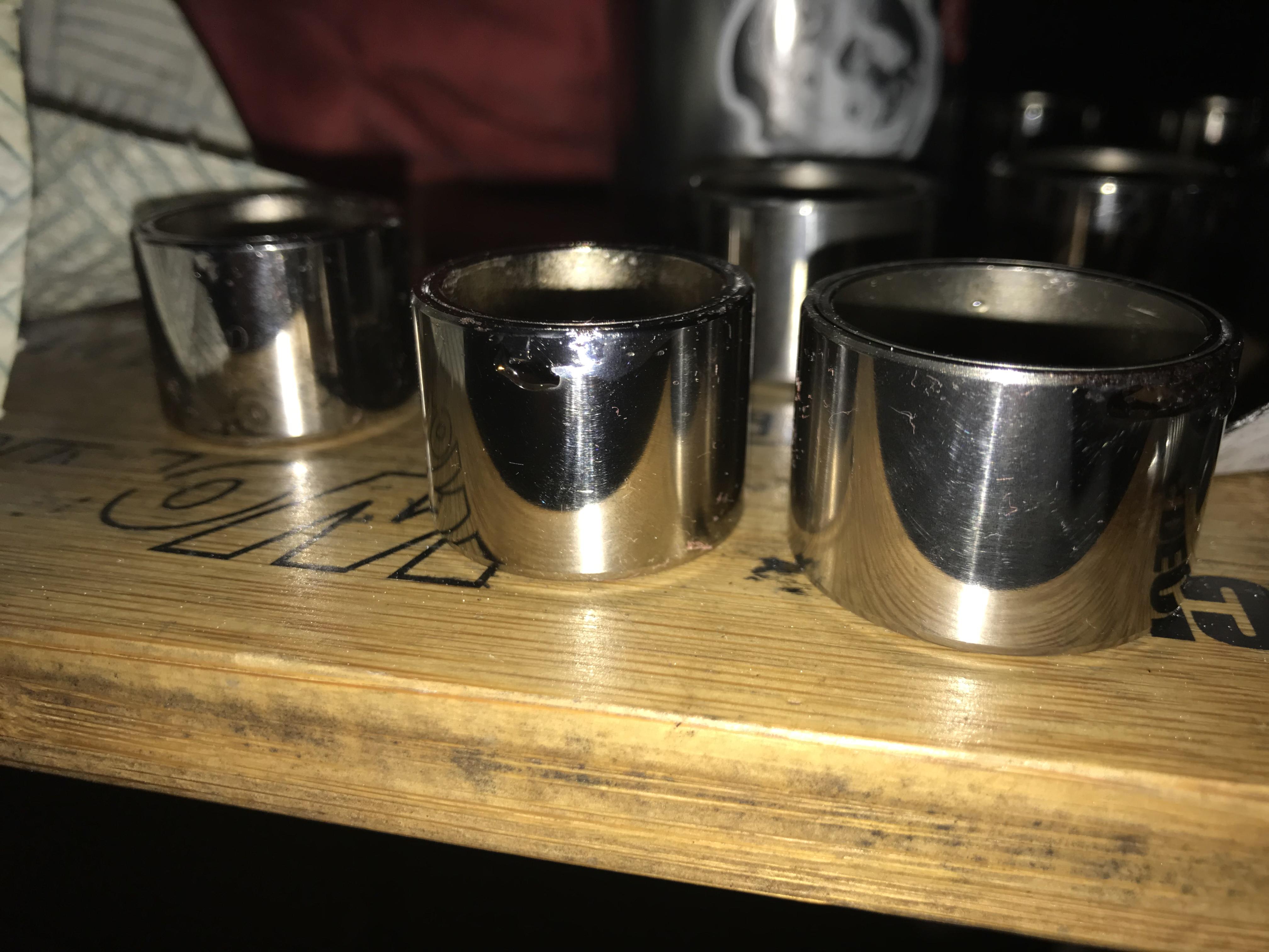

Final rub down on a clean cloth to smooth everything out and you’re done!
Good for another season.
